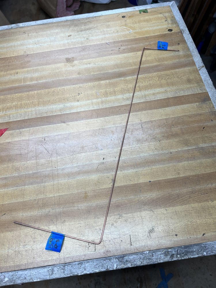

Just made my wheel checker… now I just need it to stop raining…
The welding rod "trick" just shows clearance, it doesn't show you king pin axis inclination.
p.s. if you put a couple extra bends in your welding rod, you can mimic the tires you intend to run as well. And whole wheel clearance is probably just as important as rim clearance.​
Note: The welding rod test doesn't show if the dust cap will extend beyound the rim, which is often the issue with Mustang rims on Ranger. But as @stmitch noted, 12 to 15mm spacers usually "solves" that issue.
As you are 2wd/thinking of minor lowering, you most likely won't have an issue with contacting suspension components/sheetmetal - Ford designed the Ranger to have lots of clearance with 265mm wide off road tires. So, if you're 285mm or less for tires width in front, you should be fine (you can get crazy in back with tire width (@JC4x4trucks ran T-Bird rims with 40mm offset in back without spacers and had no issues with 225mm wide tires contacting springs/box)
thank you for replying!! The tire I plan on running is a 255/45/18r
I’m now wondering if I should make a dummy rim out of some scrap I have around here.. some sheet metal and cardboard

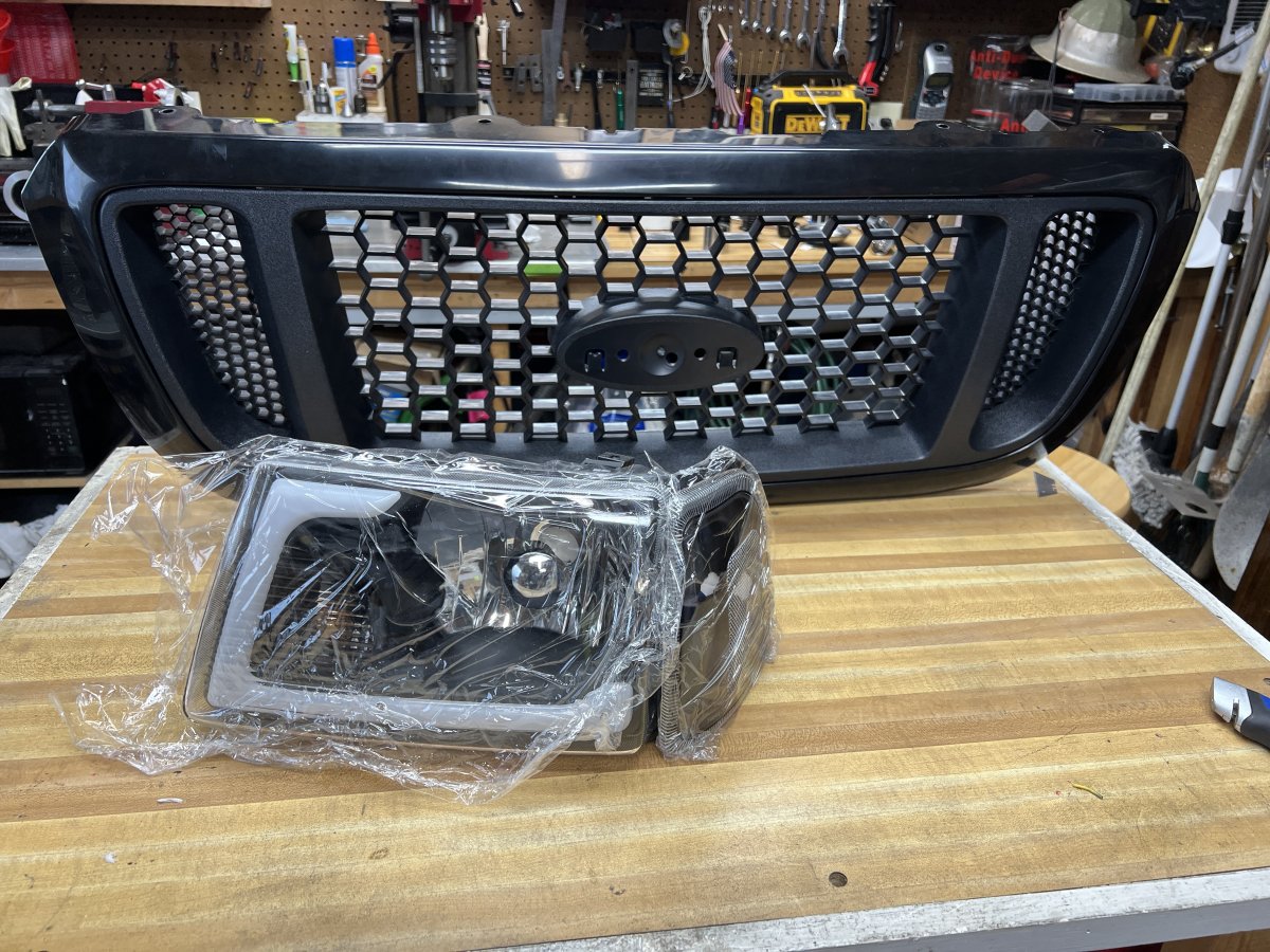

Hey guys I got a question.. trucks in the body shop, delivered the bumper today. Ironically my led head lights came in
I had no idea they didn’t come with bulbs… is it worth switching my actual head light bulbs to LED? Is it a simple bulb replacement?
anyone here have any advice or experience on what bulbs they prefer?
