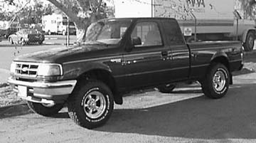

here ya go.
Ohhh. Right on. Stallion, I am' digging those rims. Bad A@@.
