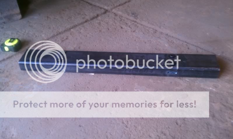

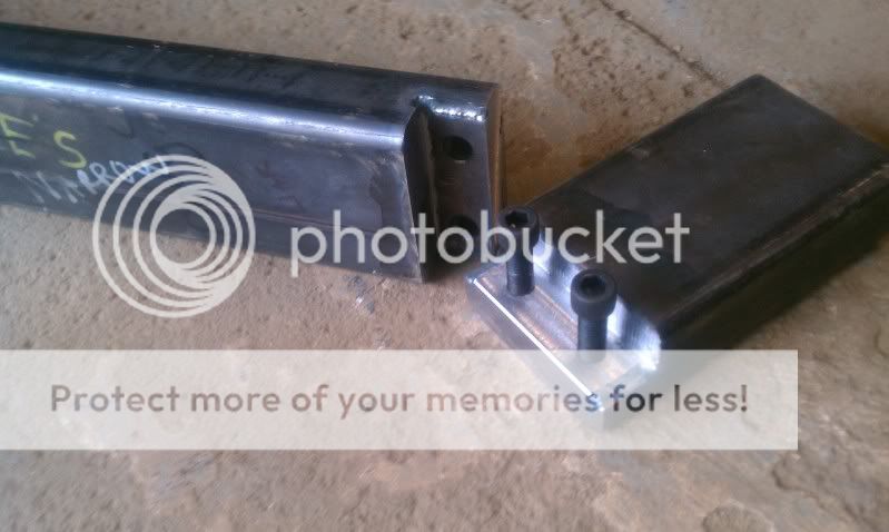

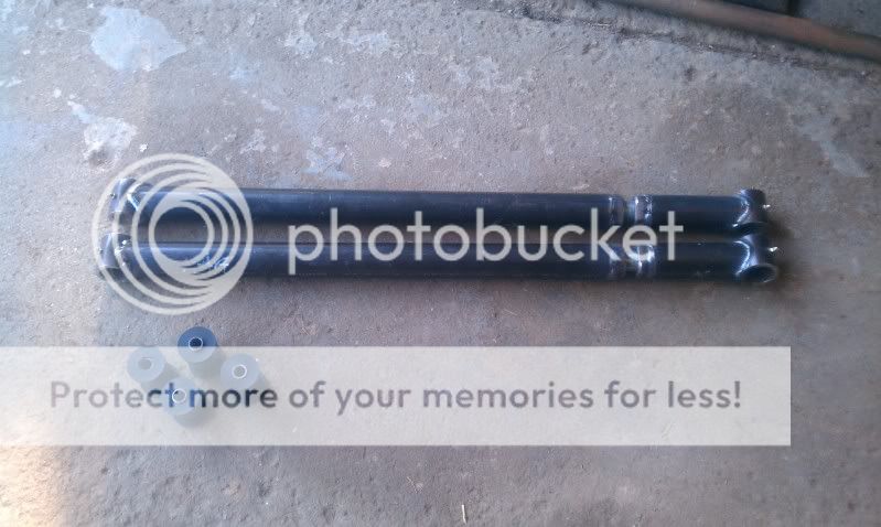

Built some lower links for my front 3 link
They are 36" long, adjustable with bushings on both ends

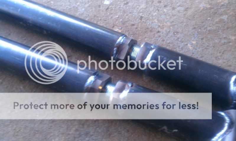

I made some threaded tube adaptors, used 1.250 fine threaded rod and put them together, still need a jam nut

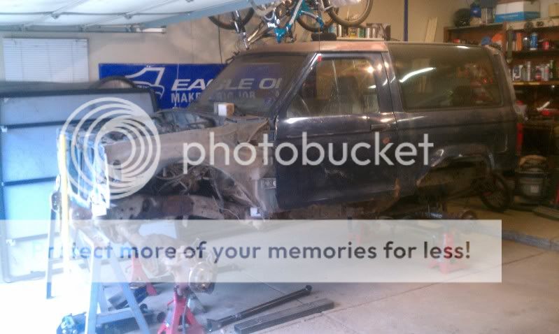

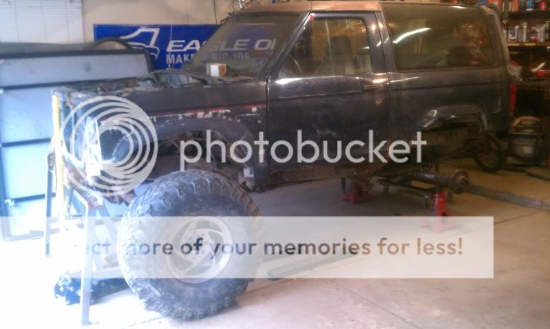

Got the front stripped, axle positioned
Built the start of my 3 link, transmission crossmember, the center is removable for the trans
Set the wheel base at 100", pushed the front to the limits I think with the factory steering box.

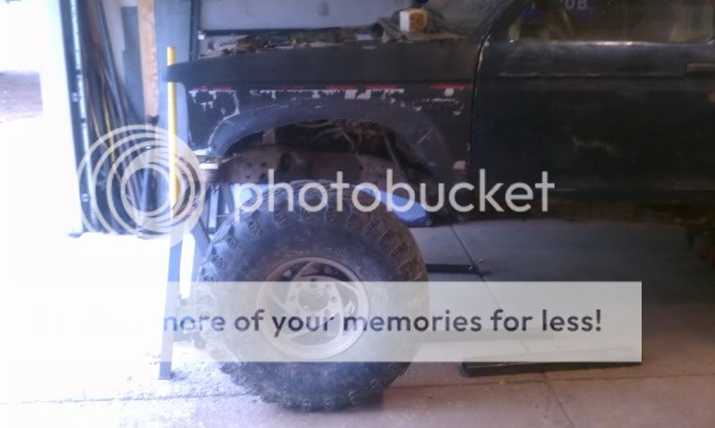

Shot of the tire in the wheel well
Once I get the body lift out I think it will be a nice height too.
i would leave the body lift or split it in half if its a 3 in..

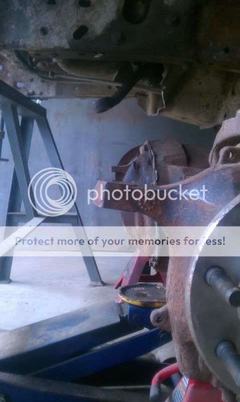

While setting up the axle yesterday I set the driverside to negative 5* caster and noticed the passenger side didn't match. Look like it is twisted forward almost 10*
You can see it looking at how the tierod mounts line up
Debating on how to fix it. My first thought is wondering how it twisted, thinking at the pig, so I was thinking I should try and twist it back and then truss it. Second thought is to just truss it, build it, mount it up, then cut the welds at the c and twist that back and weld it back up.
Thoughts?
Along the lines of the second idea, but I would weld the tubes to the center section on both sides, set your pinion angle, and then look at the caster and see which one is closer, and cut/reweld the other C to match, then truss. IMO, truss should be done after all other mods, so the truss ain't in the way, and avoiding the possibility of having to remove the truss...
