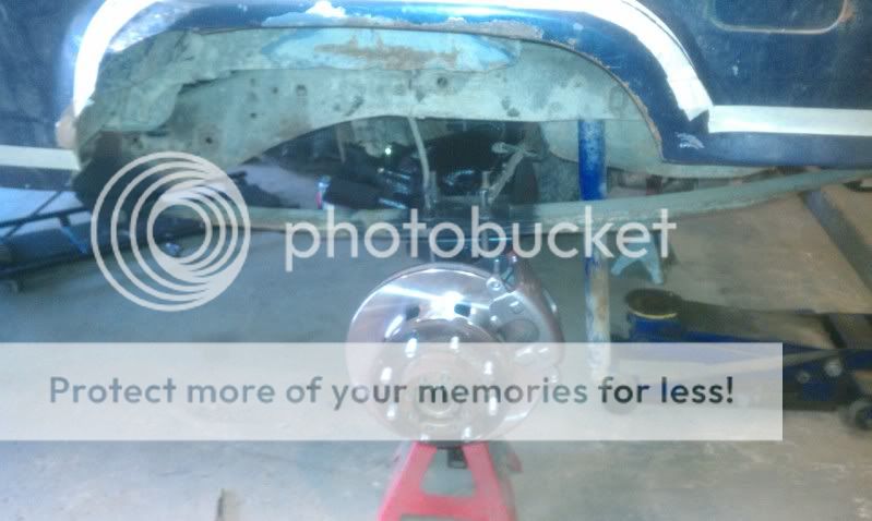

Update:
Lower links mocked up, crossmember in place, not finished yet. Still have some gussets, trimming and welding to do

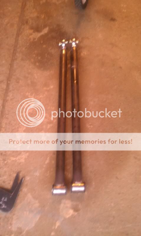

Upper link made, 1.75, 1/4 wall dom, bushings on one side, 7/8 Heim on the other. Trackbar is the same.

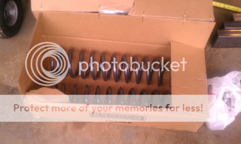

Springs showed up, 5.5 super flex eb coils

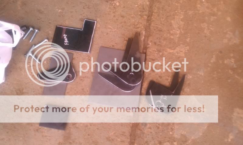

Made all my upper link mounts and frame side trackbar mount. Not sure what I'm doing on the axle side. I need to make coil buckets too for the frame.

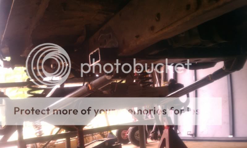

Got all the front suspension mocked up. 36" long links, all of them, 8.5" separation at the axle, 4" at the frame. That is about all I could fit, hope it works good with the 100" wheel base. The crossmember is installed, fully welded, just need to take the center out and finish the driveshaft clearance. Also got all the body mounts fixed, front frame horns replaced, still unsure on bumper, just put a tube in there to hold everything.

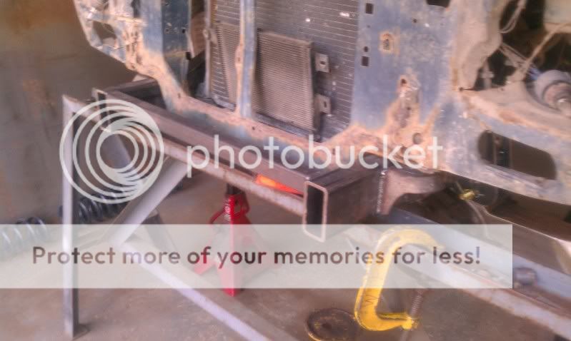

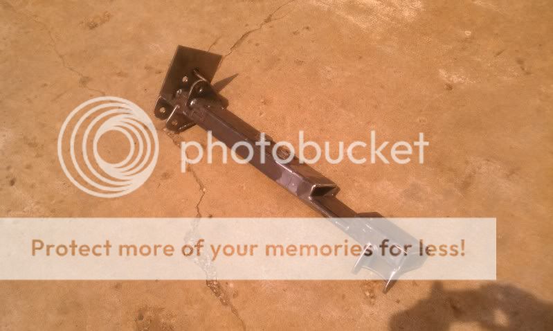

Mostly finished crossmember

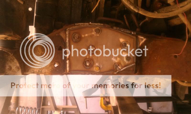

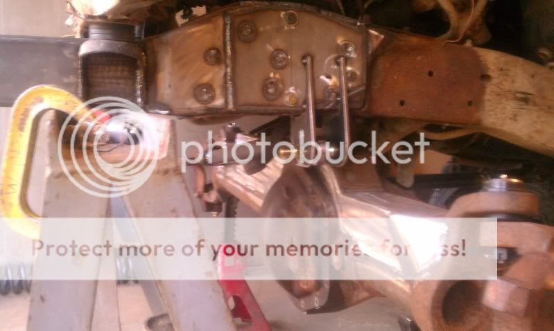

Plated frame for trackbar mount
Trackbar mount mocked up

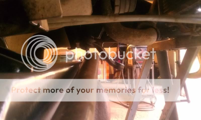

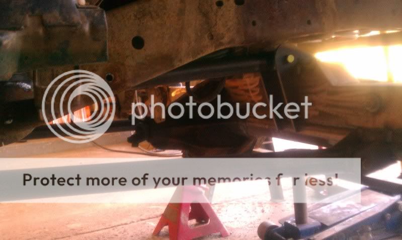

3 link. At about full bump, 3" of uptravel right now, limited to my trackbar clearance. Gonna tweek that more to get about 4" of uptravel

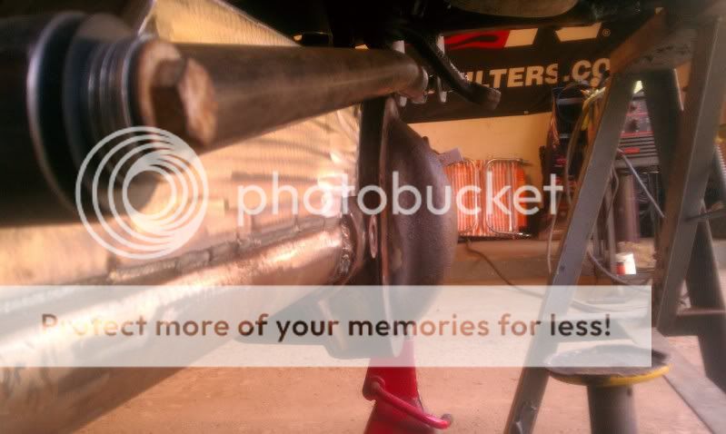

14 bolt shaved
Everything welded up, u bolts trimmed to length, waiting for paint to dry. Also I welded the spiders in the rear. Hope to get it back together and installed this week.

you planning to double shear the track bar?
EDIT - on the axle end i mean
Yes, forsure.
Add that to the todo list too
