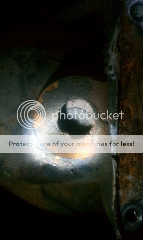

Axle stripped and ready to be twisted back
Murphy, the one ton B2 build

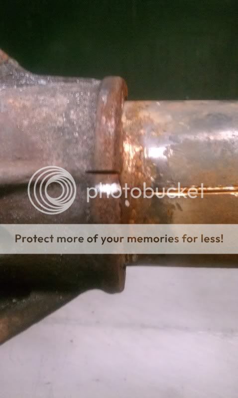

As i was stripping it I noticed the twisted area, the housing next to the tube you can see the tube twisted
Gonna replace balljoints, u joints and a wheel bearing while its apart.

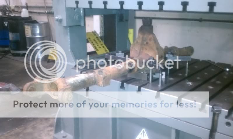

Got the axle twisted back, then I cleaned it up, pre heated it and welded the tubes to the housing. I left it at work under a welding blanket to cool.

The cut lines are marks I put in it before I twisted it back...moved a long way

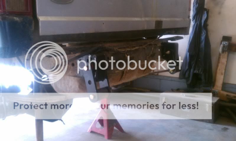

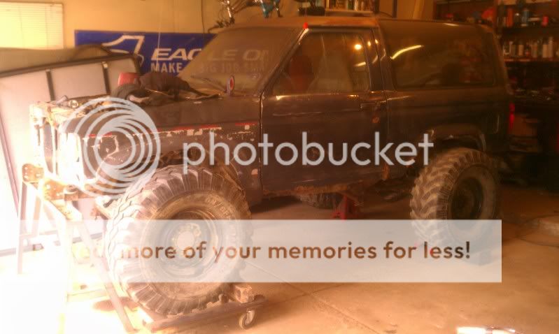

Had a good morning, got the rear shackle area built. The angle is a little steeper than I wanted, but I think it will be fine. Used a set of bushings, some dom and boxed in the rear frame section.

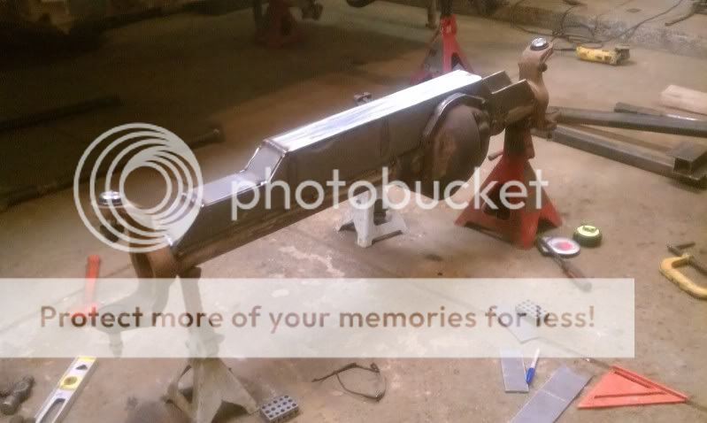

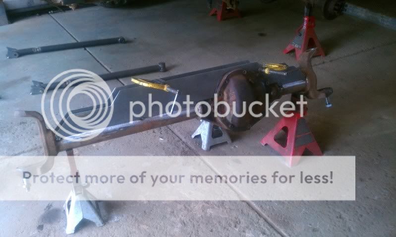

Then I got a good start on the truss, I think I like the way this is going

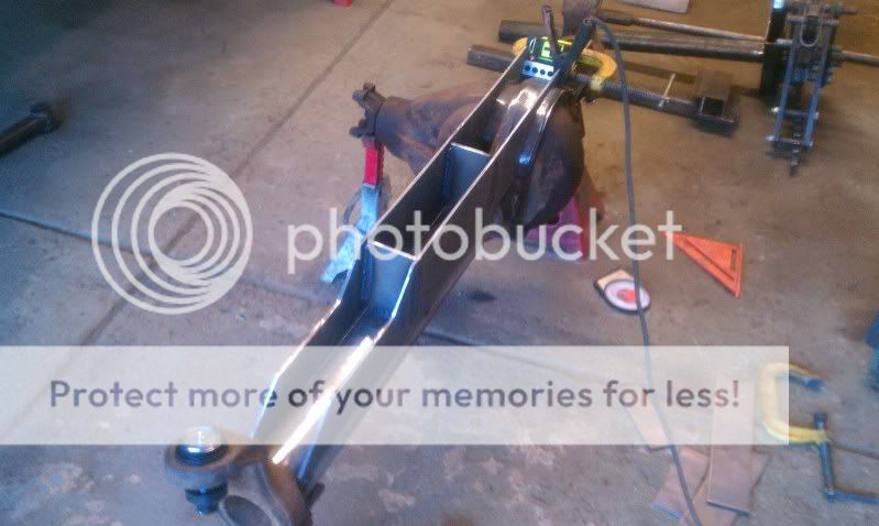

Got a little more work done on the truss
Added a couple gussets on the inside
Then started plating the top
It's all made of 3/16. Think I am going to add a couple drains in the back. Think I should hole saw a few holes in it, maybe sleeve them for strength?
It's a little late, but putting a few dimple dies in the front, back and top plates as well as the gussets would have both greatly strengthened the truss as well as lighten the weight...looks good though. At this point, like you said, drill a few holes for sleeves...
SVT
I don't have dimples dies anyway.
Looks good. It's fun to watch the master at work.

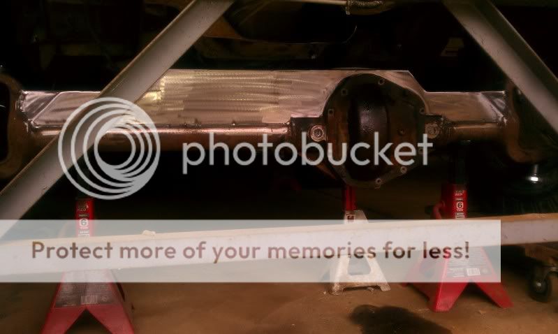

Got the truss done for the most part, but forgot to snap a pic before I slid it back under ....so deal with a crappy pic.
I ran the truss out to the c's, I don't mind it I guess. Now on to getting it installed.
