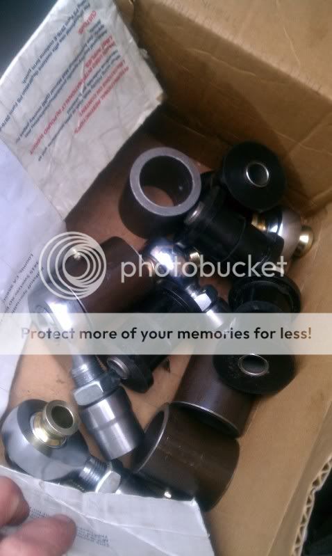

Picked up some link goodies today for murph
