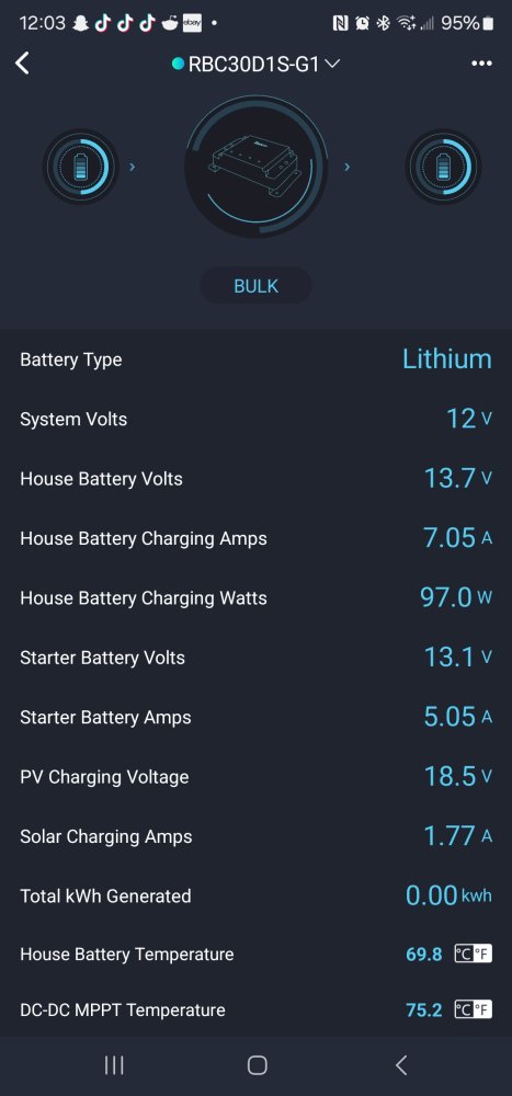

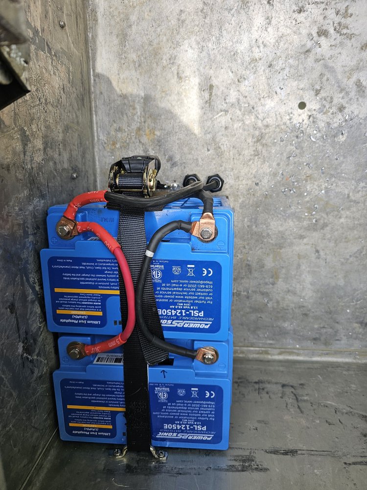

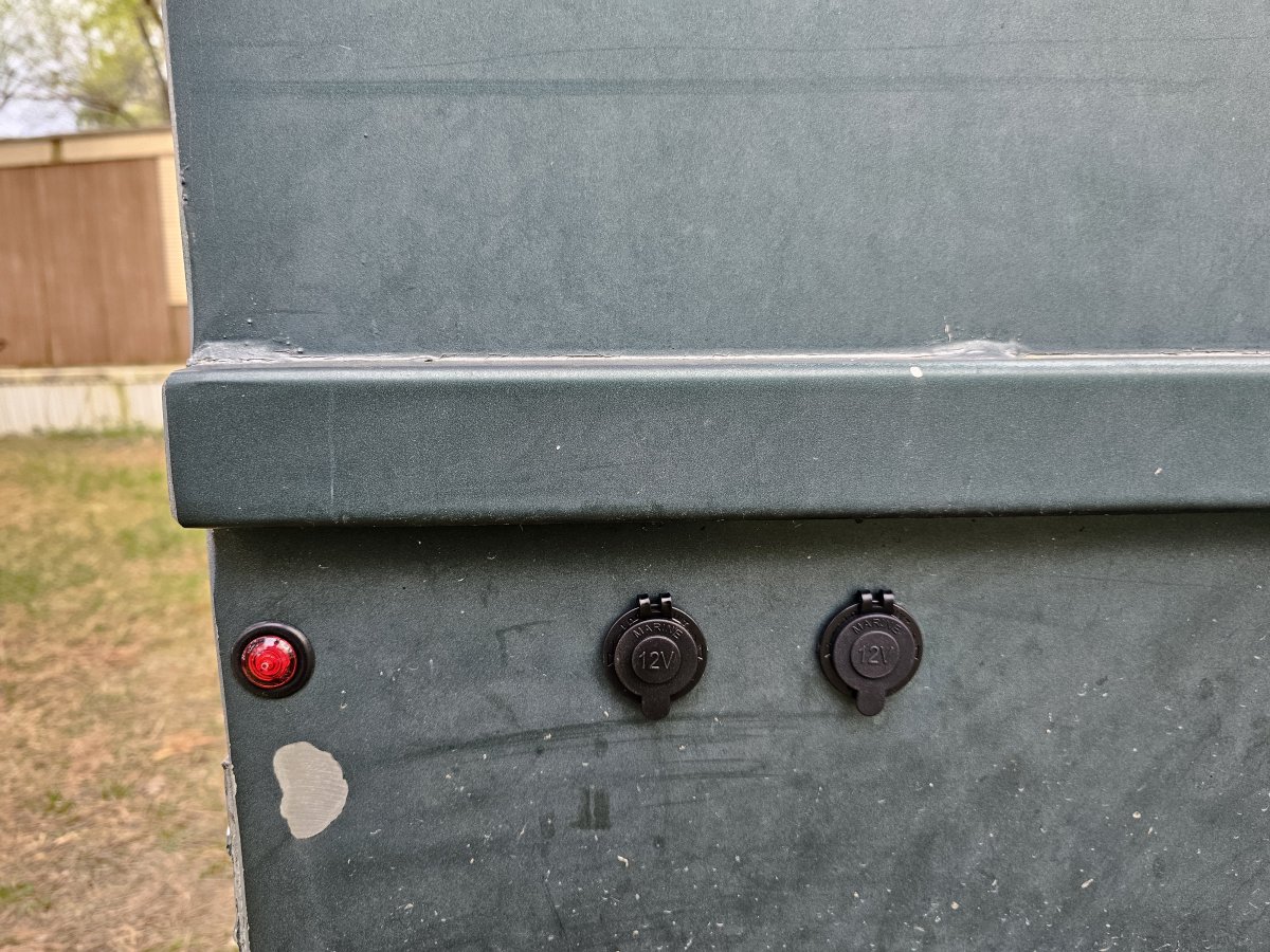

Saturday was wiring day. I got as far as I could on the exterior stuff, installed and wired the charge controller, fuse panel, 2 relays, 2 switched and 1 unswitched power outlets and got the handful of wires for the interior up through the floor at least. I then hooked up one of the batteries very temporarily and the panels were supplying it about 60w of power on a little bit cloudy day with the sun partially blocked by a tree. Once the tongue is replaced and the box is mounted I'll be able to mount the batteries permanently.

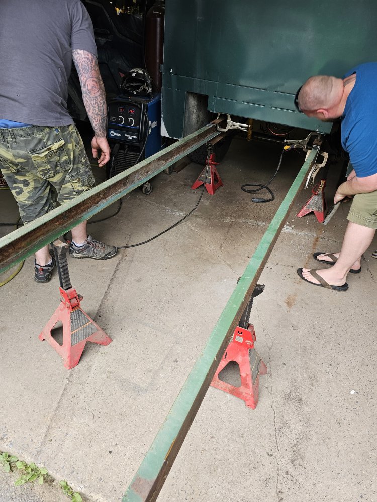

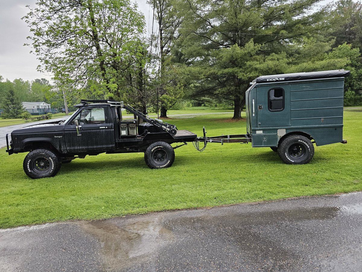

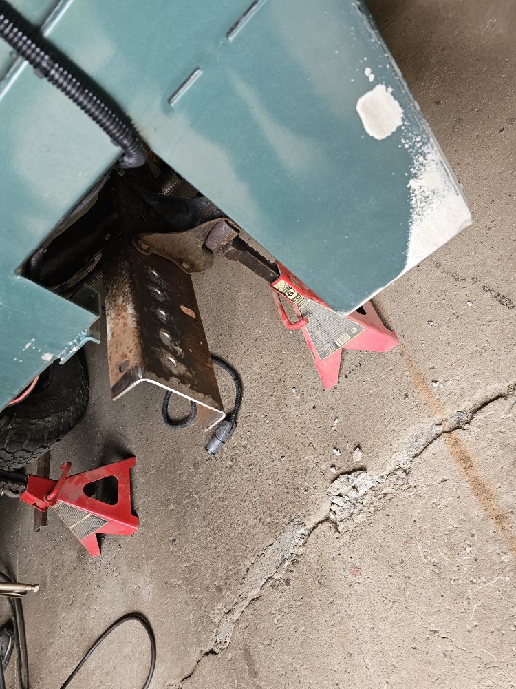

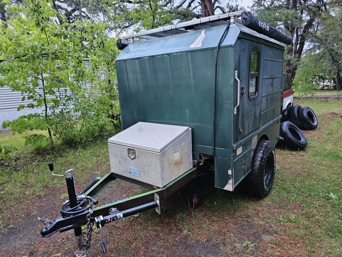

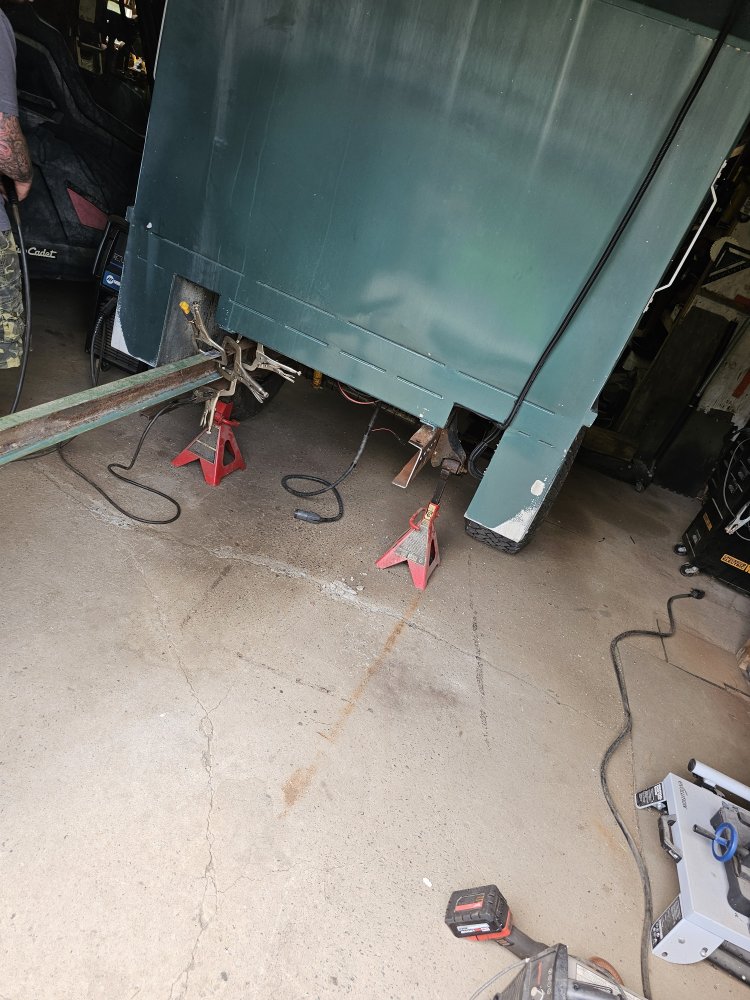

Yesterday a couple friends and I chopped the tongue off and extended it to help it tow a bit better and give me a place for a tongue box.
We cut the frame, sleeved in some 2x4x3/16 channel which was plug welded and mostly perimeter welded to the frame and extended it by 14 inches over what was there. As a unintended benefit, we were also able to cut out most of the really thin and rotted part of the driver side frame rail (all of the remaining thin metal is in the bottom inch or so) I towed it back home after and it has made a very significant improvement to how it tows.

The last of the external wiring (other than the reverse lights i just need to plug in) has now been completed. The charge controller is fully tested and operational. When I start on the interior I'll build a battery cover but it's now working as intended. Last night I sealed a couple roof seams, once that cures fully I'll water test it and the interior build out will start soon after.

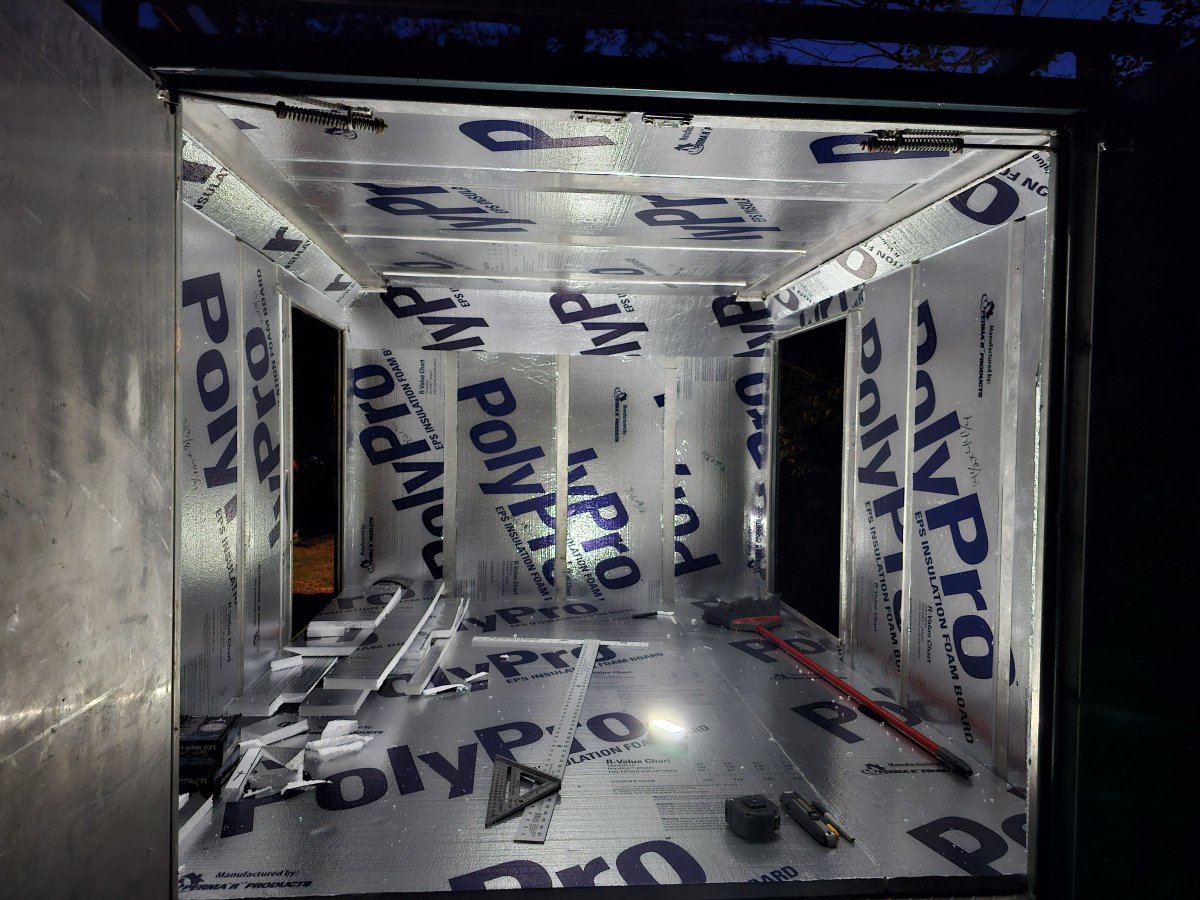

Well, I couldn't wait for the rain to see if there were still any leaks so I spent yesterday putting all of the wall and ceiling insulation in. I also picked up some plywood for the floor and a couple other odds and ends. One issue with the insulation that I found is the insulation crushes a little more easily than I thought it may so I'll be adding some floor support to the edges of the plywood then trimming the foam to suit. I'll likely be using some 5/4 x 6 pine and ripping it down the middle, it should be dimensionally similar to the insulation. So far I'll have only lost about 1.5 inches of vertical height and nothing in width or length. Once I panel the walls and ceiling I'll lose another 1/2 inch in width and 1/4 in length and height. It doesn't feel any smaller inside really so that's a plus.

It's been raining pretty good all day, there are no roof leaks now, so the seam sealing must have worked. I was able to go pick up the boards I needed and get them put away before the rain started. I'll be getting it ready for the floor and possibly installing it tomorrow afternoon.

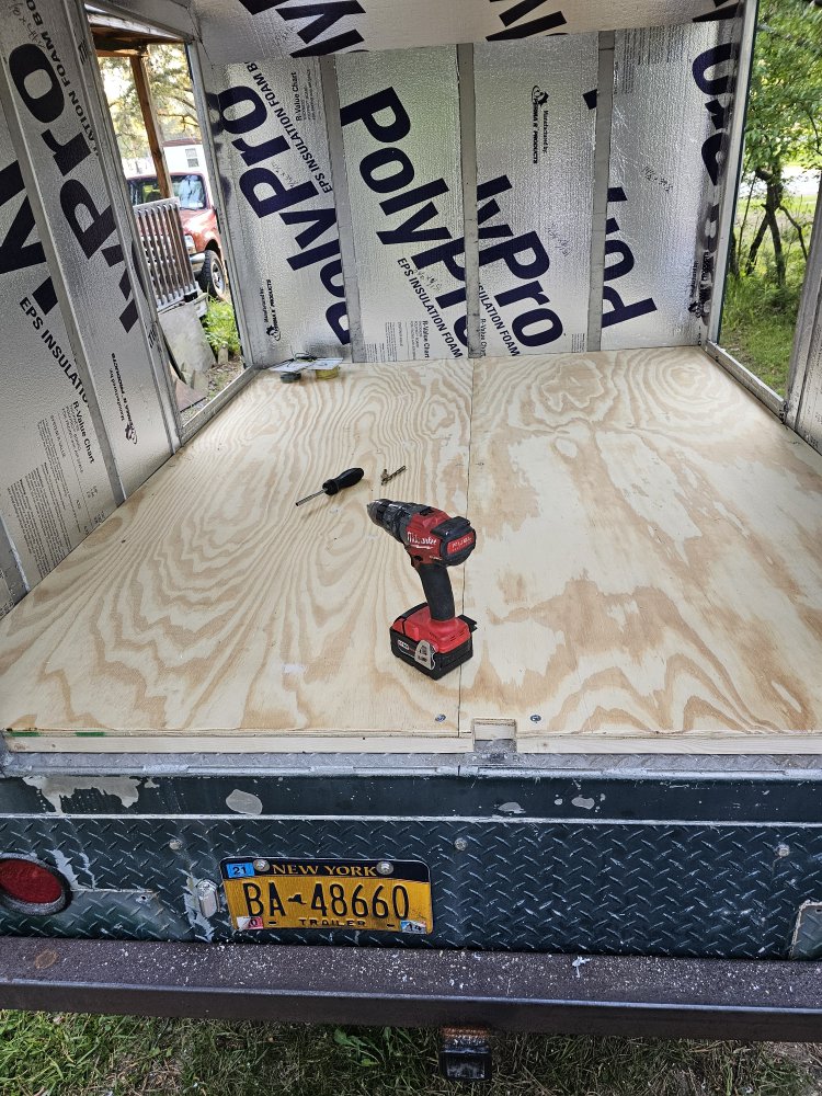

A couple of evenings this week have given me enough time to add some structure to the floor insulation and get the floor secured (twice, because I didn't like how it turned out the first time) and I'm working on getting all the seams taped up on the ceiling currently. As a side note, with the floor in but no mattress in there I have about a foot over my head when sitting upright so once the 8 inch mattress goes in I'll still have enough room inside.
Sorry i didnt get any pics of the floor structure I added but there's wood around the perimeter and right down the center under the seam. Tomorrow im going to get the floor cleaned and a coat of poly applied to it so I can work inside without worrying about marking up the wood. Hoping to have all the panels cut and fit by the end of the weekend so I can work on getting them painted during next week.
