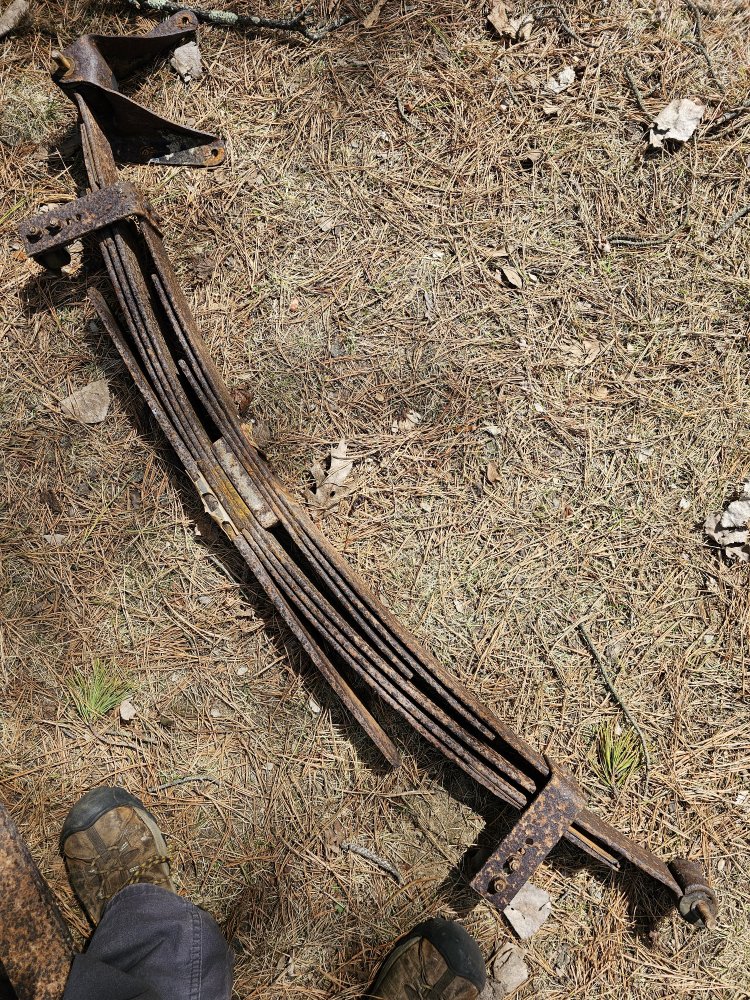

Nice spring pack you got there.
It was a half baked way to keep the sway down in its previous life, I'm going to look at other options now, haha.

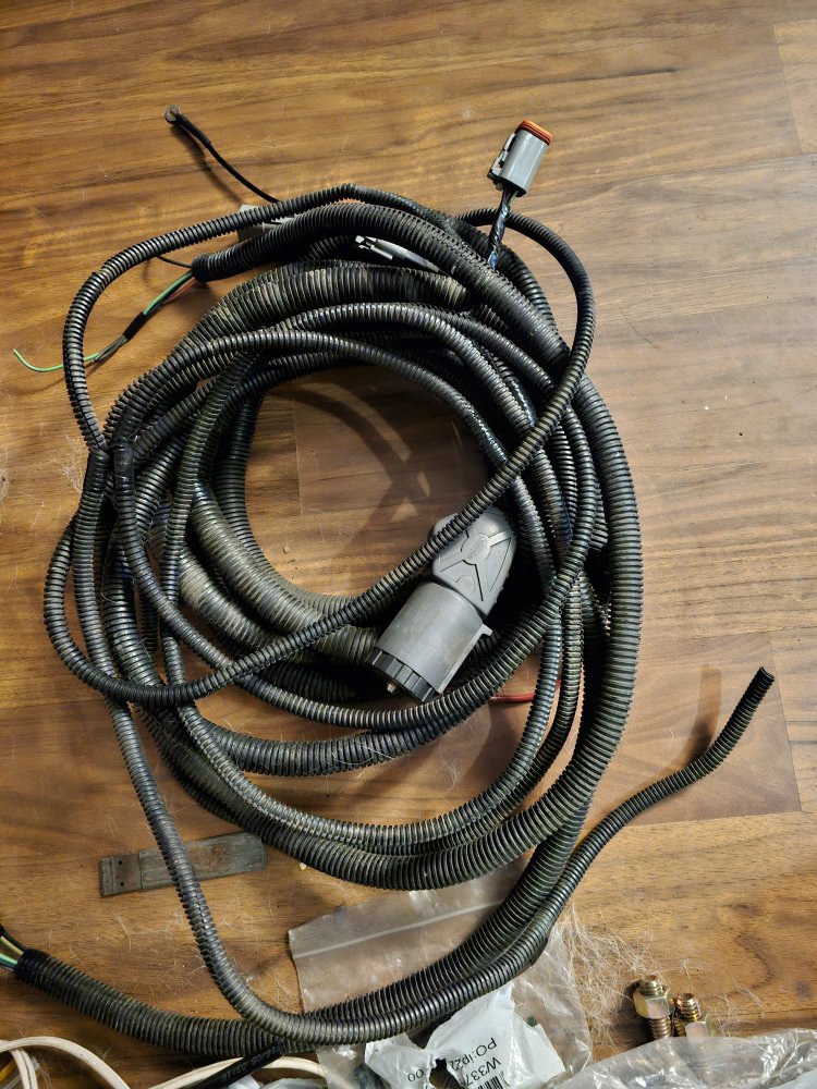

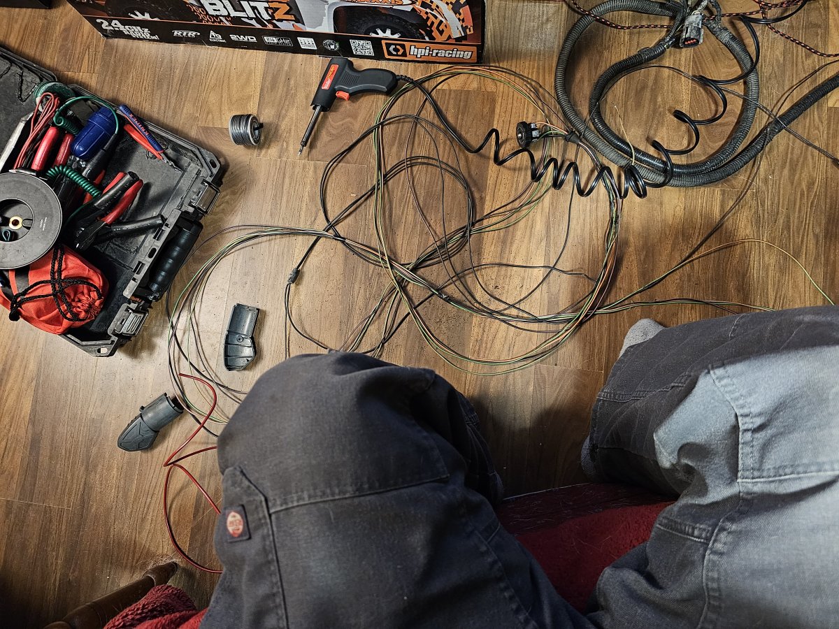

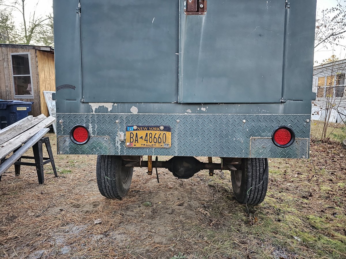

I would suggest running a 5-wire or 7-wire for brakes and backup lights.
Possibly providing some power for other things as well but keep in mind that the amperage isn’t super high and not all of them have power all the time, at least as the wires are normally setup.

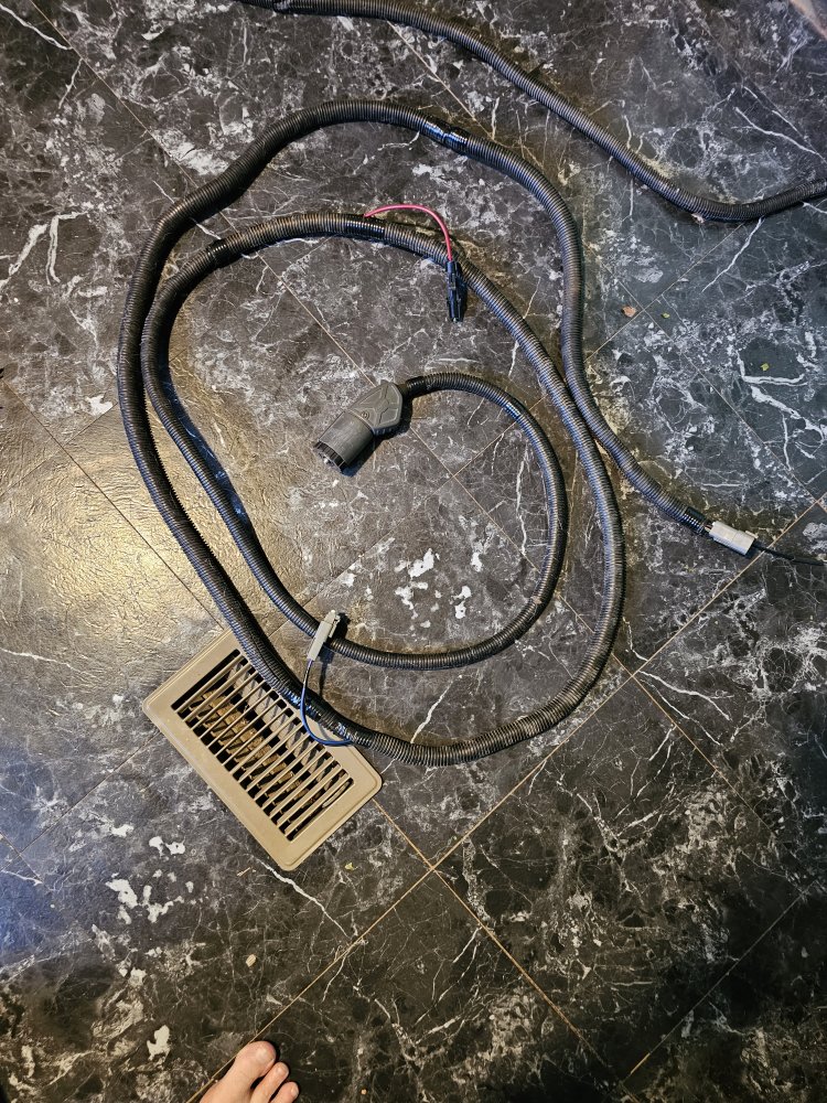

I finished the wiring harness last night, it's a 7 way with an auxiliary, electric brakes, and reverse lights wired in and capped for future use. Truck is already wired for all of these things and has a brake controller also. The plan is to use a portable power station and solar in the trailer but the auxiliary will be wired in to charge it while driving also. I'd like to keep the two mostly separate when it comes to power. Here are some pics of my harness work last night, I reused most wires and the loom so it looks old but is all redone

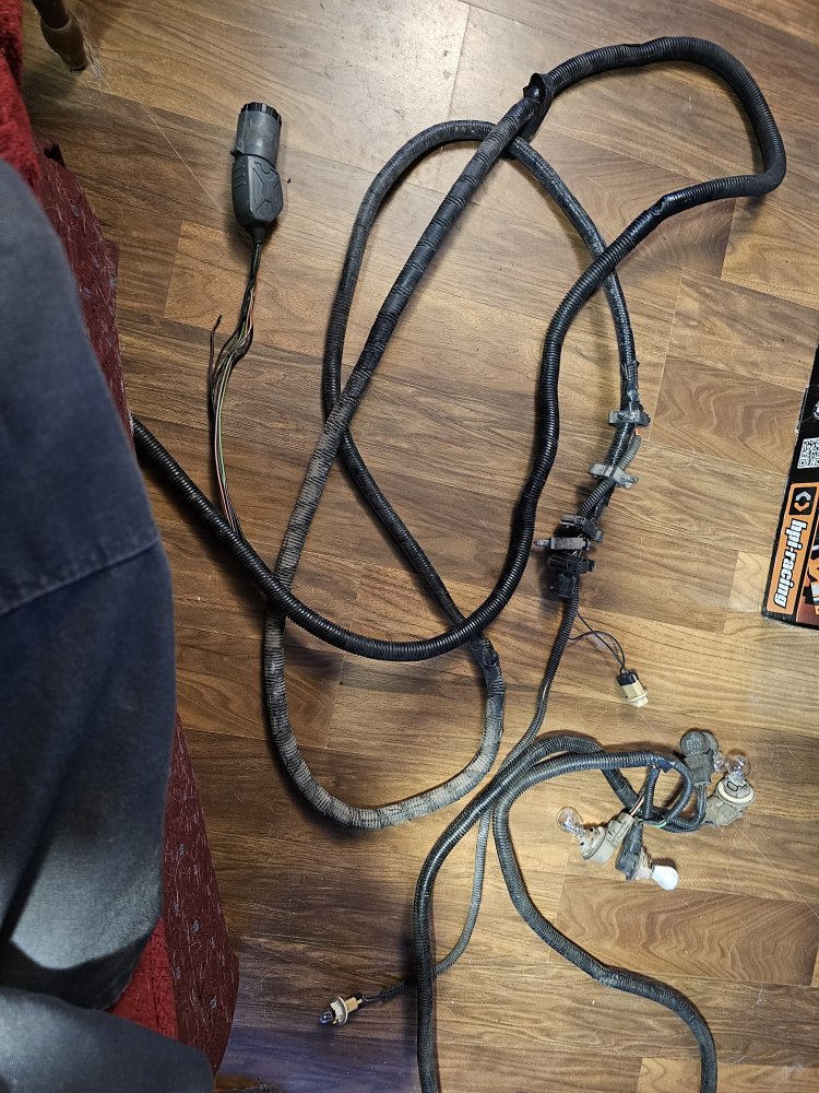

@sgtsandman here's a better pic of the main harness that will be on the frame showing the brake and aux wires
Had some time and some daylight today, so installed the wiring harness along the frame and all of the lights, tomorrow I'll connect the lights to the wiring harness and then I have a legal trailer again.

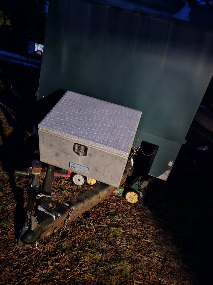

No visible progress made but pretty much all of the things I've ordered are here, waiting for some space to be freed up in my buddy's shop so I can start sealing it all up and such. I did manage to find a box I'll be mounting to the tongue used on marketplace though.

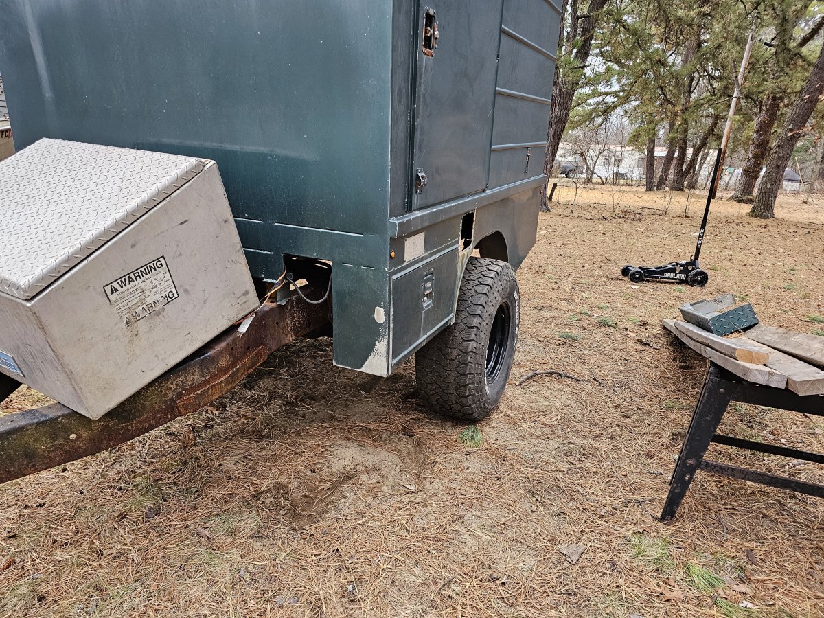

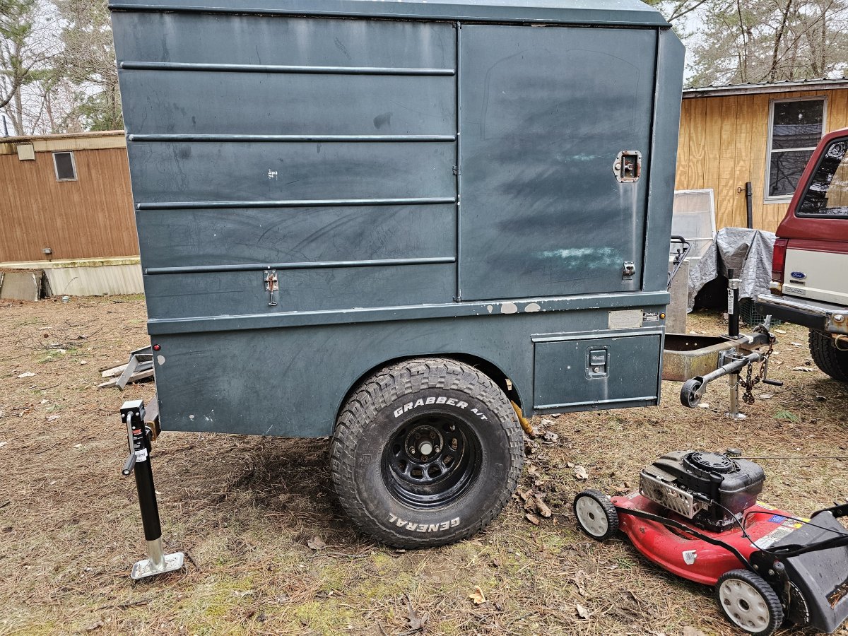

After searching for a good used pair of 33 inch all terrains and coming up empty I decided to buy two new ones then pick the worst two on the truck and swap them out and stick them on the trailer. Fun fact, the older general grabbers I have were made in the United States and the new pair were made in South Africa. The wheels they're on were a 60 dollar score from the junkyard and are 15x10s with roughly the same backspacing as the ones on the truck. Im going to trim the wheel openings as much as I can then I don't think the tires will rub, the openings are about 31.5 inches at the widest point currently and I've got about an inch of room at the front so that'll allow me to widen them about 2 inches and not look weird. I think some aluminum flares may be built at some point with some steps built into them, but I kind of like the look how it is, thoughts? More progress though.
Micro camper from Ranger service body
I've never been a fan of the tires poking out of the fenders look. In some states, they can actually give you a ticket for it. Though, it doesn't seemed to be enforced much. Perhaps they save it for when they really want to pile on the offenses or get you for something but can't find anything else that would stick.
In any case, I think fender flares can look great and if you can work a step or two in them to make them even more useful, bonus.
As a side note, most of the more aggressive tires tend to make great rock throwers. A set of mud flaps might be a good idea. Mud flaps aren't everyone's thing but if you are riding in a group, the person behind you might appreciate them being there.
As far as clearancing the wheel wells, it looks like that would be a good idea. There doesn't appear to be much room up front but it might be ok with some finessing. There appears to be much more room on the back side to play with.

I've got them in about as far as I can for a 15x10, the truck is similar, they're 4 inch ish backspacing, not super ideal but it's a concession I'm making to have to carry only one spare. As long as it isn't commercially plated new york doesn't really care but I do plan on adding flaps to both truck and trailer, truck flaps will be removable. I try to keep it all up to snuff from an inspection and safety standpoint to avoid the fines.

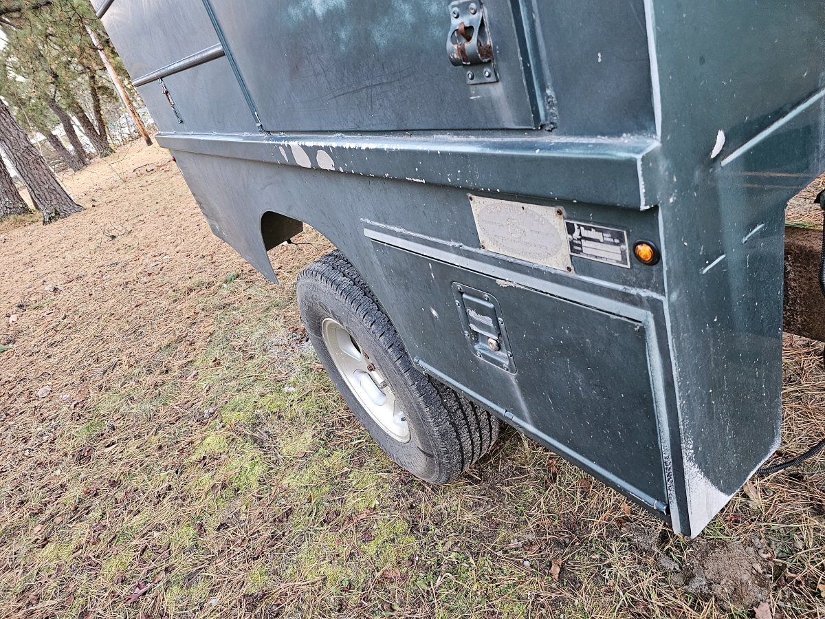

I've been thinking about adding the hard flares as the bottom edge of the door is about kitchen counter height, so a handle next to the door and a couple of steps will go a long way I think. I don't plan on dragging it down any tight trails so I don't think they'll get ripped off.
These haven't been super terrible at chucking rocks but they do on occasion so definitely a smart recommendation, especially for that.
I'm going to clamp something at the lower edge of the panels and draw a semicircle then see how it looks. Hopefully in the next couple of weeks I'll be able to get it inside and get all of the aluminum work done and seal the roof as it has a couple of minor leaks and all of the sealer is 36 years old so it's time to address that as well.

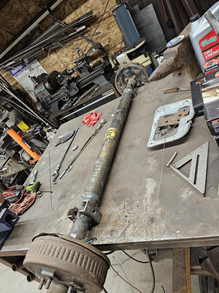

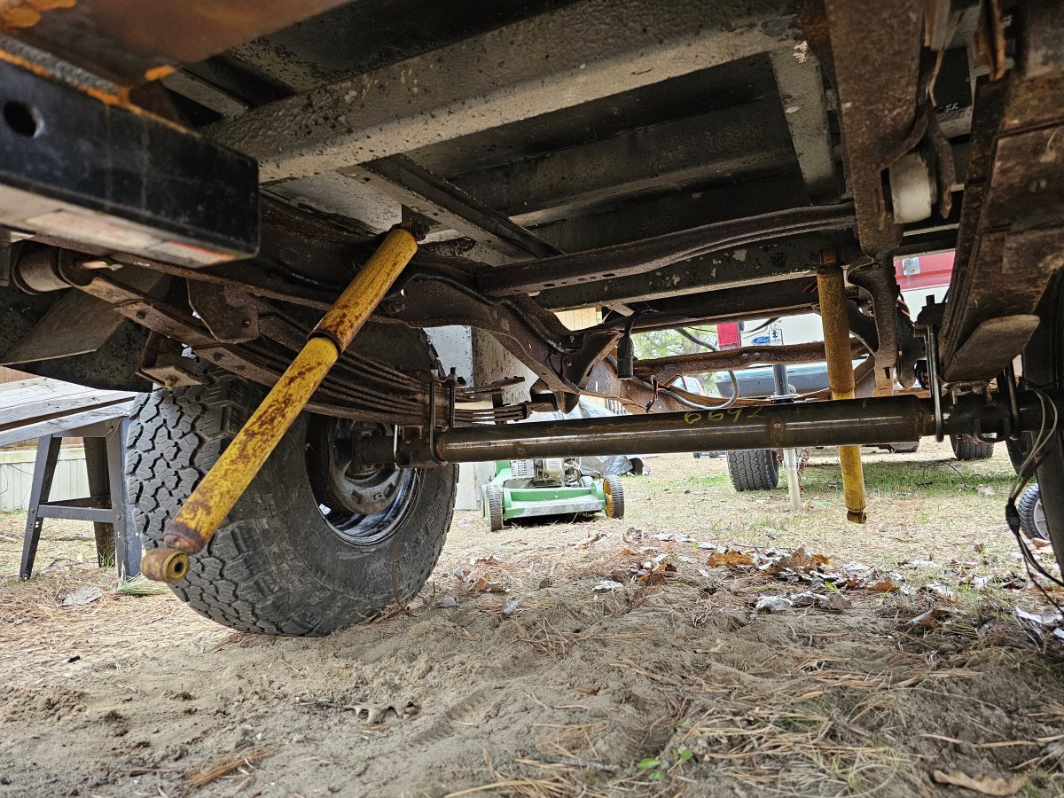

Well after a bit longer than I was hoping, some progress was made. Went and picked up a good used 3500 pound trailer axle today then we shortened it.
We cut and sleeved it, the ends of the axle touch in the center and it is plug welded in several places along with the ends of the sleeve. The perches that are slightly inward are Ranger width and the old ones shouldn't interfere with the u bolts and will give me a decent jacking point should I need it.
More progress on this today, found a set of decent springs on the truck that the box originally came off of, the heavy overloads will go on as well, I'll adjust them a bit to help with sway and such, should ride better and lower the overall height a bit over the springs I currently have in there. I've ordered new spring bushings and once I get those installed using the press at work, the springs and axle will be going in.

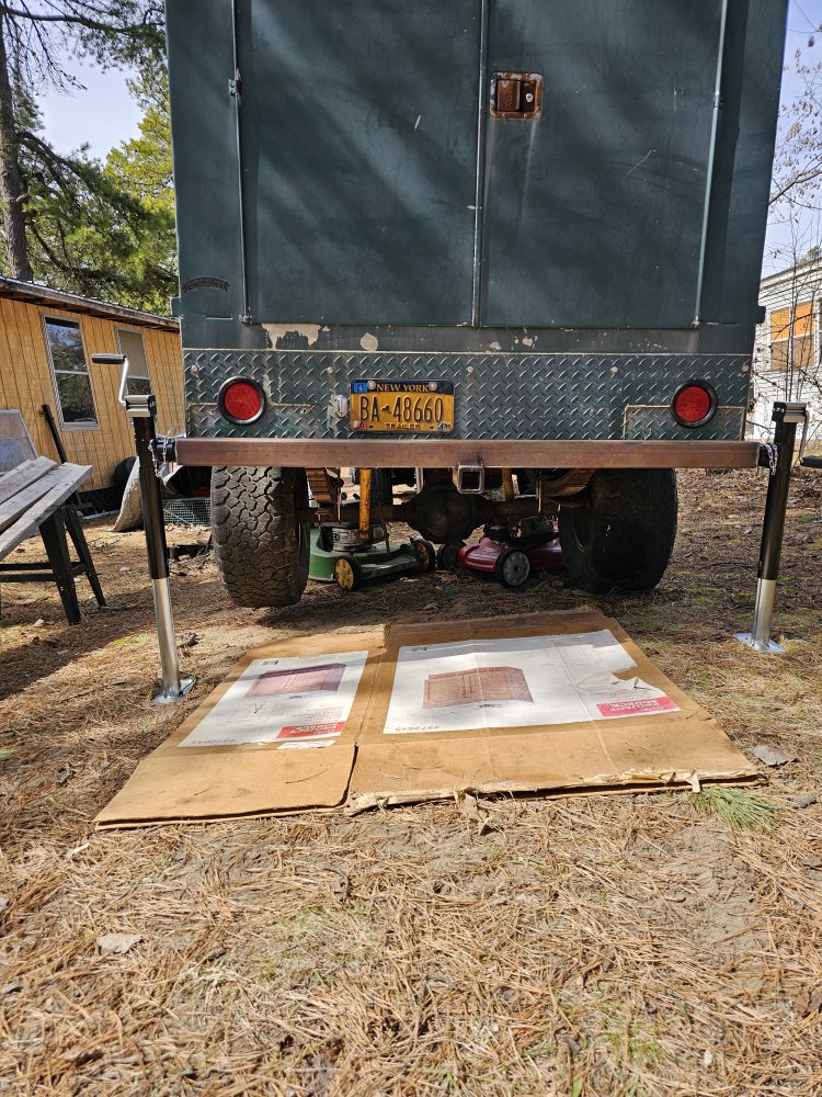

Got the leveling jacks and rear bumper fit and installed today and tested how much I can lift the whole thing up with them all fully extended. I'll need to add an additional support to the front leg because it tends to flex forward but it works well nonetheless. I can tilt it quite a significant amount with the tires on and with them off I should be able to just about tip it over.

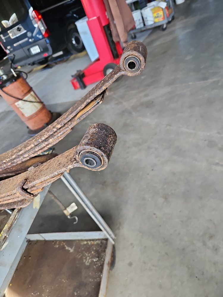

Managed to make some more progress today, got the old leaf spring bushings pressed out and new ones pressed in
Then I installed the axle, in my haste to install it before the rain I managed to install it backwards, so I guess I get to install it again 🤦‍♂️... The ride height is roughly where I'd like it to be, I'll need to trim the fenders a bit but that was anticipated and is no big deal.
