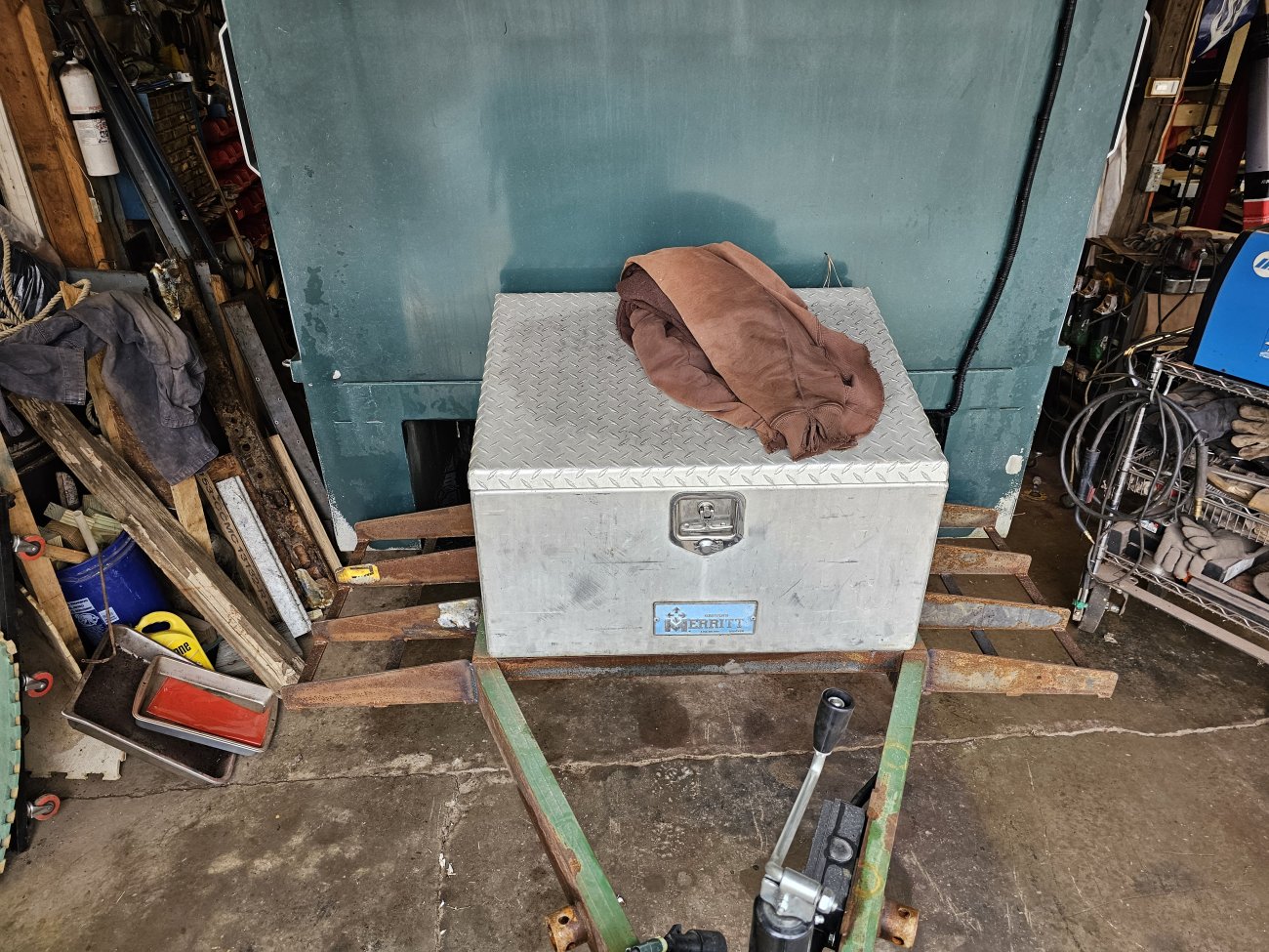

This project is a similar situation, it's over 7 feet tall and 5.5 x 7. Once it's done (real soon) I'm going to weigh it out of curiosity.
Definitely a good idea. I was surprised how heavy my trailer weighed the last time I checked it. It will also help with weight distribution and getting a proper 10% - 15% tongue weight. I thought I was tongue heavy but it turned out I was pretty spot on and it helped a lot with getting the loaded weight distribution right.
Before we replaced the tongue on it, it had zero tongue weight (Yes, actual zero, could balance the trailer on the axle with no jack touching the ground) and now it has about 50 or 60 pounds of weight with the box and batteries there. Once I stick the mounts for the cans there it should add 20 pounds more without cans and whatever water/fuel weighs when they're full.

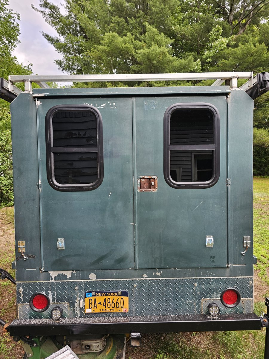

I ended up making a couple screen panels that are attached to the inside of the door frames with magnets as the windows weren't enough and I'm not sticking a roof vent in. I will be adding a couple more windows, one in each rear door, I'll pick them up on a black Friday deal like last year.

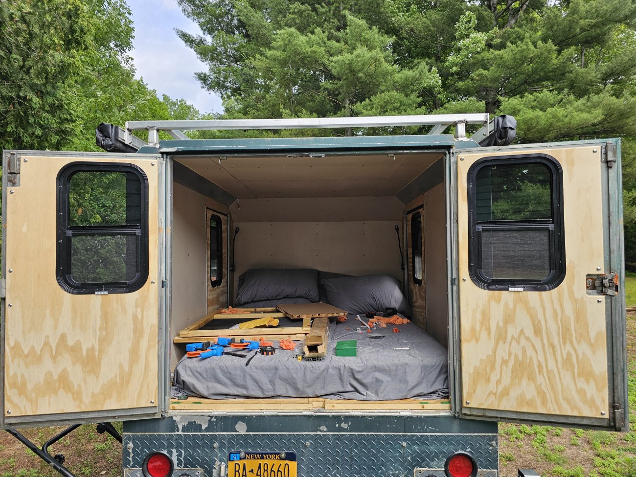

And I also picked up another pair of windows for the rear doors as well, should brighten up the interior and add some more much needed ventilation.

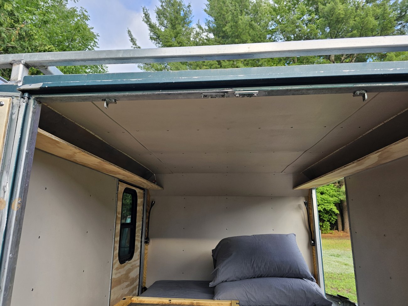

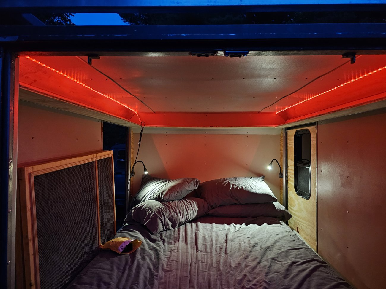

A little progress from the last couple of weeks. Installed the windows in the back doors, fitted some wood panels to the inside of the doors at the same time. Even though all of the doors were filled with spray foam, the insides of the doors would get crazy hot in the sun, so I decided to add the wood which makes a huge difference. Also cut and fit some channel for some more wood for some small storage shelves.
I'm going to be pulling all of the panels and shelves back out this week to sand and polyurethane them, I'll also be adding some aluminum strips to the front of the shelves to keep things from falling out of them. I may also add a shelf connecting the two in the front but I haven't made up my mind just yet. What would you do? I should also note there is no structure to attach the shelves to in the small angled portion of the top front, so that would have to be overcome.
Add the shelf. There is never enough storage...
I like the way you think, I think I'll add one. I'll be able to make it deeper to store larger things. The shelves on the side are only a bit over 6 inches wide.

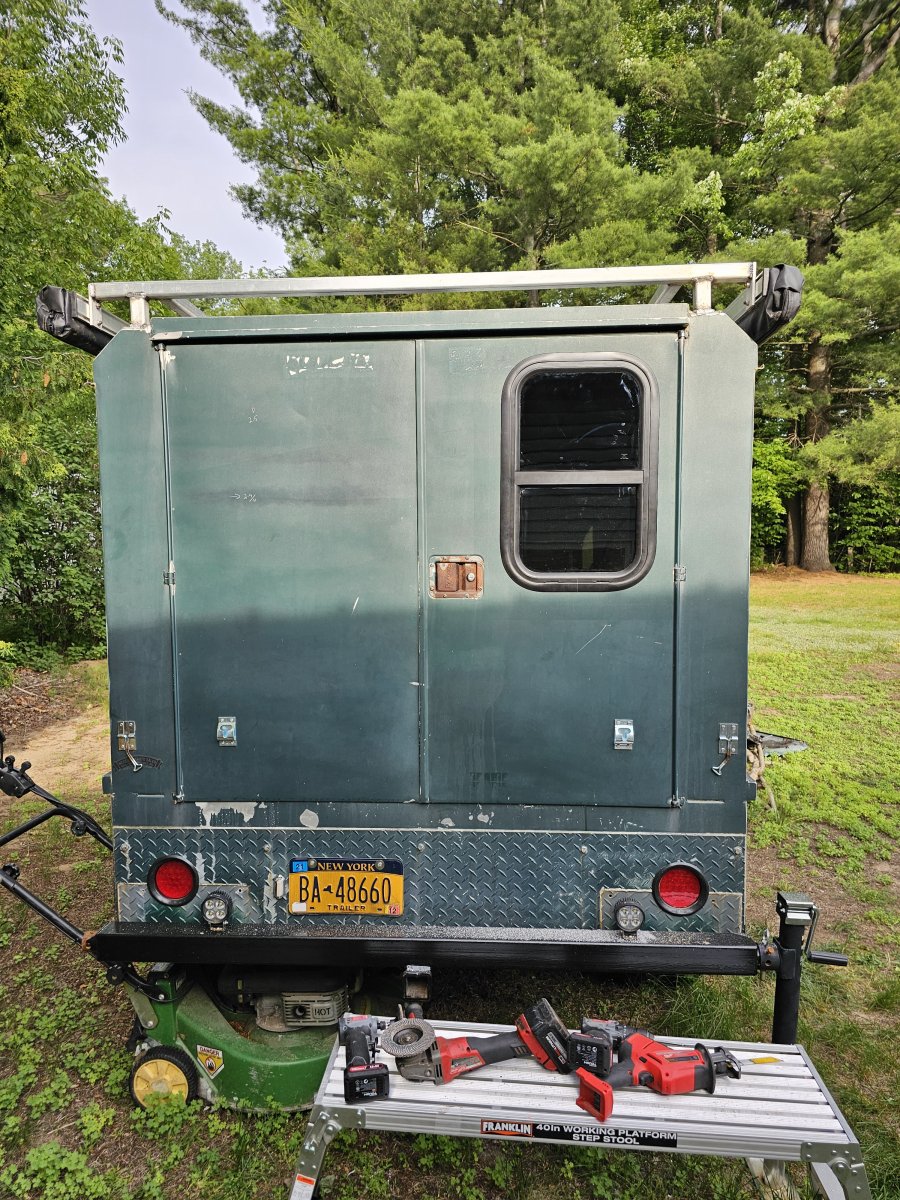

About 2/3 of the roof space is taken up by solar, but the last 1/3 will be a roof basket once I get a chance to do so.
Also, I added the shelf, you can't see it well but it's there
