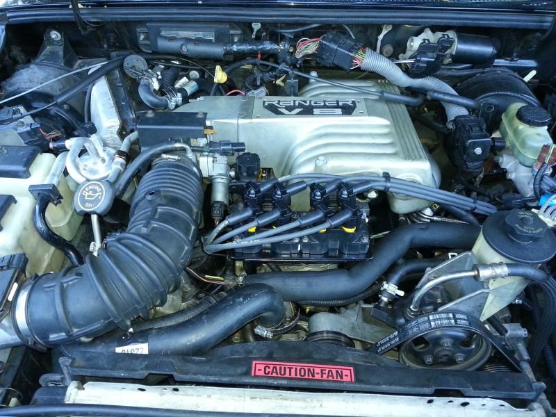

Ive got an 03 ranger single cab that came with a 3.0 stick shift. I'm using an early 97 explorer pcm so I went to the junkyard and cut the 42 pin connector off of the body side of a 5.0 explorer and I cut the 42 pin engine harness side of the ranger. I want to make a jumper harness between the 2 so any of the changes within the 42 pin connector happen in the jumper and if the truck ever gets damaged I can just buy another body and won't have to re-do all the wiring once again. I've did the wiring before on the truck I drive now which is also an 03 but super cab with electric locks and Windows but I can't find any of the info I used to make the wiring work and it's not able to be unattached for reference.
What I need is a diagram of the 42 pin connector for an 03 ranger and possibly what the wires do. I've already got all the info for the explorer engine harness side. But the info I can find for the ranger doesn't match up to mine. #1 connector on the ranger side harness is a light green/purple wire and #1 on the explorer side is a red/light green wire.
If anybody has done this or has that pinout please help I'd like to go ahead and knock this out while I have some down time. Thanks.

Thanks for trying to help even more. I took another look at those diagrams you emailed me and it got me a lot further once I figured out how to read it better. I'm down to 7 wires on the explorer side that I believe I don't have to use at all, and 2 that are ground (#42,#13). And on the ranger side I know #41 will have to go out to however I wire the alternator (ranger side doesn't have pin #42) and #28 blue/orange having to be ground. And 5 wires on that side that I believe have to do with PATS and I leave unplugged. But there's a pink wire at #24 on explorer side and also pink wire #24 on ranger side but on ranger side it loops back into #31. Do I connect all 3 into a connector or leave explorer side open and ranger side looped in. I believe I should leave it looped in and I'm sorry to bother this much but as close as those pinouts were they're still a tad bit off on a few wires. Thanks for any more help and I also emailed you pics of both sides 1st pic explorer 2nd pic ranger.
