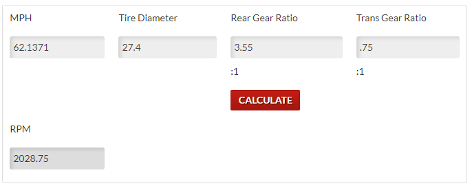

I suppose I would need your tire size as well haha, just remembered, but if there anywhere near stock (225/70r15) it looks like you've got a 3.55 rear end.
With a 3.73 rear end, at 100 KpH you'd be looking at closer to 2150 RPM. Let's just say you definitely don't have a 4.10
I was considering dropping down to a 3.55 ratio for fuel economy, so if you're getting 24-25 solid, at those speeds and a 3.55 ratio with no other supporting mods, that's good data for me to consider swapping in some lower gears.
To help me out, if you've got the time and patience, would you mind doing a proper fuel economy run next time you're out and letting me know your stats? (fuel up to full before, setting trip odometer, refueling at same pump to full)
