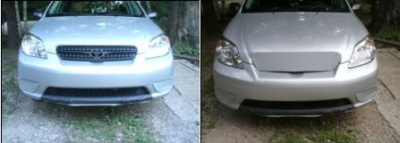

As for grill blocks here's an example:
MAB3L, the most reasonable truck on the road!
It's mostly done to reduce drag, some folks also do it to raise engine temps. Folks with diesels or heavy duty trucks do it in the winter as well to keep their engines warm in cold conditions which helps with fuel economy and performance.
Most modern vehicles are overcooled, especially on the highway, and that's why you can get away with blocking so much of the grill. You still have to be mindful of your temps but in general it won't cause any issues.

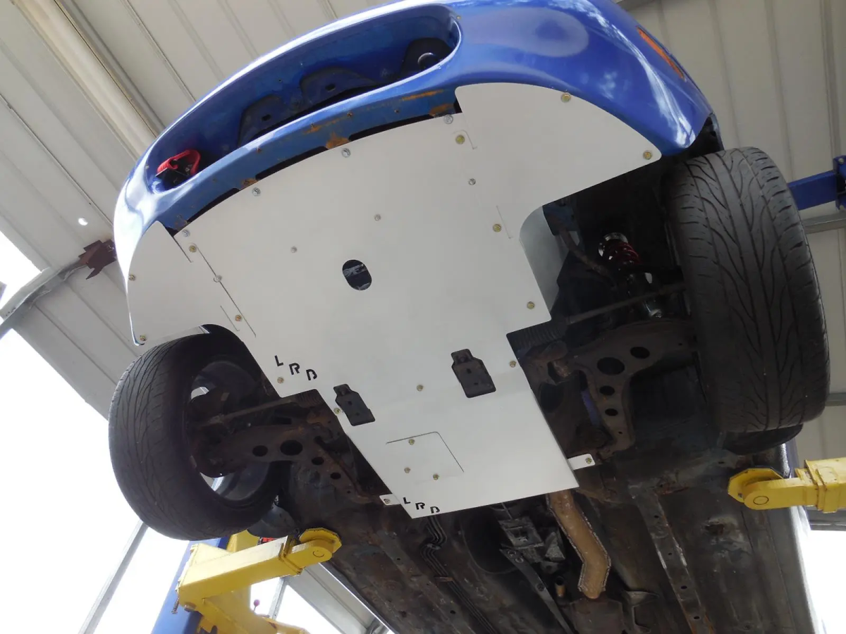

As for undertrays
This has been a thing on racecars forever, but effectively it smooths airflow underneath the vehicle improving handling and reducing drag.

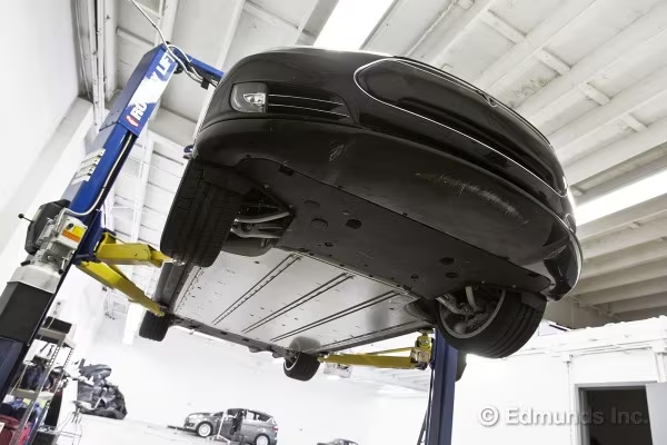

The underside of cars, trucks in particular are awful for aero, so even modern efficient cars and EVs in particular will have fully smooth underbodies:

I'm planning on doing some aero work like the above to the truck eventually since it's part of the puzzle, but I need the time and $$ first.
