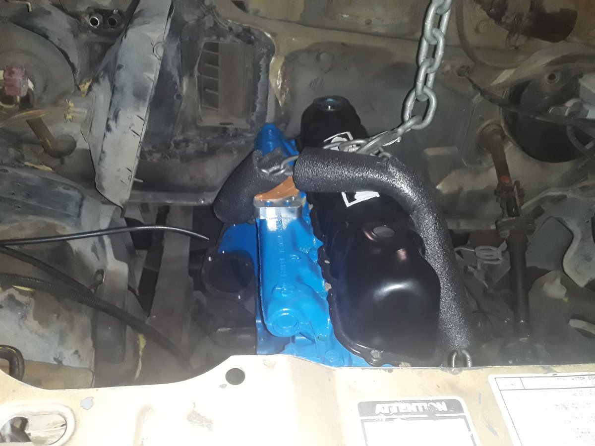

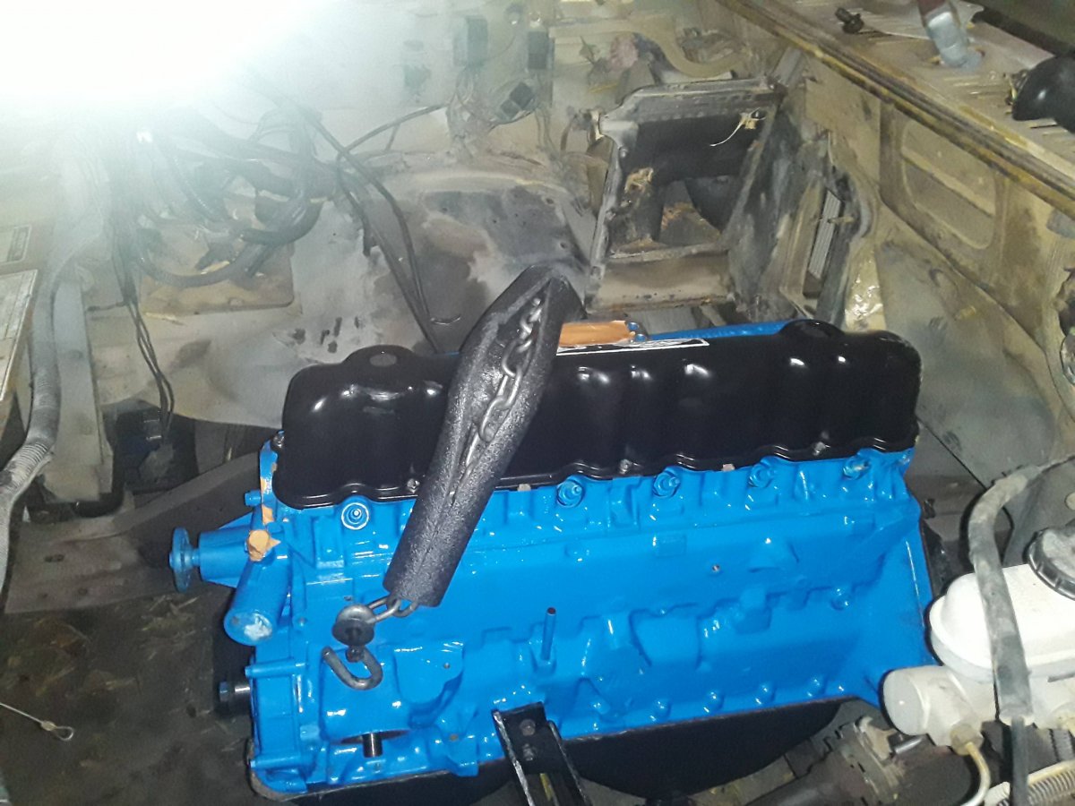

can we see some pics of that inline 6 in a ranger engine bay? I'm curious as to how much room you will have for a rad and what mods u did to fit it?
I second that motion, I was just pondering putting a 300 in mine.
Sorry for the late response, i'll send some pictures when i get home from work today. Thanks for your interest
So I actually found these pictures I took a few weeks back, I'll put up more to show the modifications I did to make it work later this evening.

That looks like it fits surprisingly well.
Looks like the water pump goes into the radiator support...
Actually not, I'm using the radiator from the Maverick that I got the engine out of, it fits between the body ahead of where the stock ranger radiator mounted, and with a slim electric fan, I have about an inch of clearance, I'd show you some pictures if I didn't have the radiator off being serviced. I chose the smaller six for this reason, a longer 300 inch would surely give me clearance issues long ways, but the small sixes-they fit pretty well, just, not with the stock components. I removed the AC condenser and am not keeping the stock AC system. If I hadn't removed that unit along with the radiator then this build would have taken a very different shape.

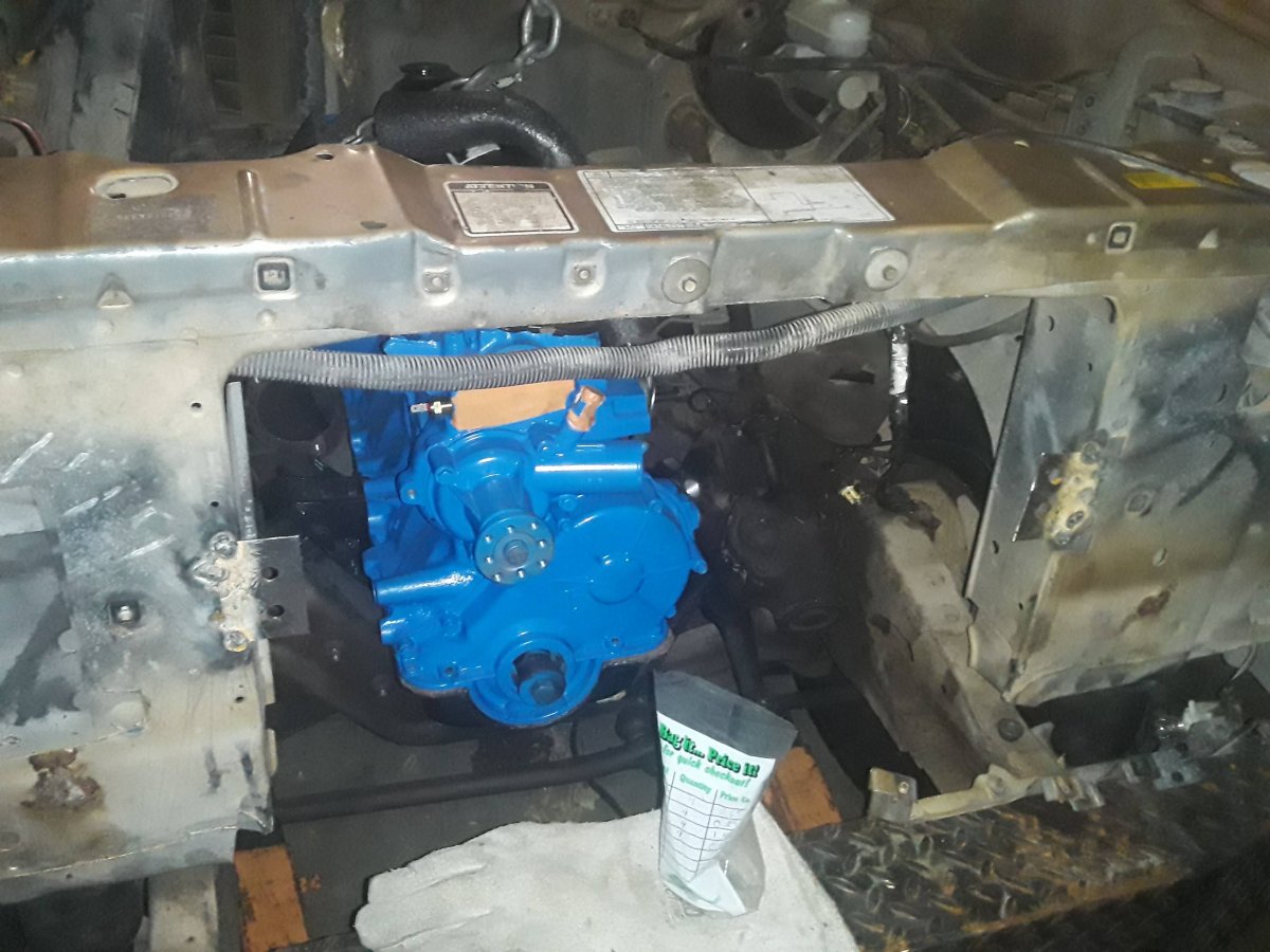

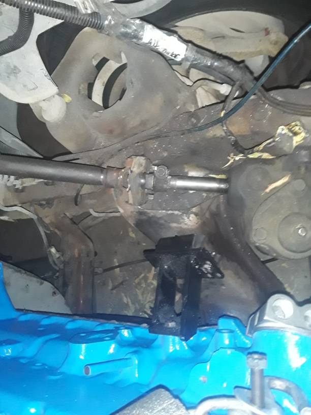

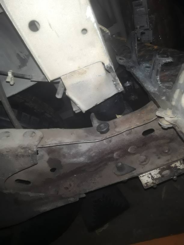

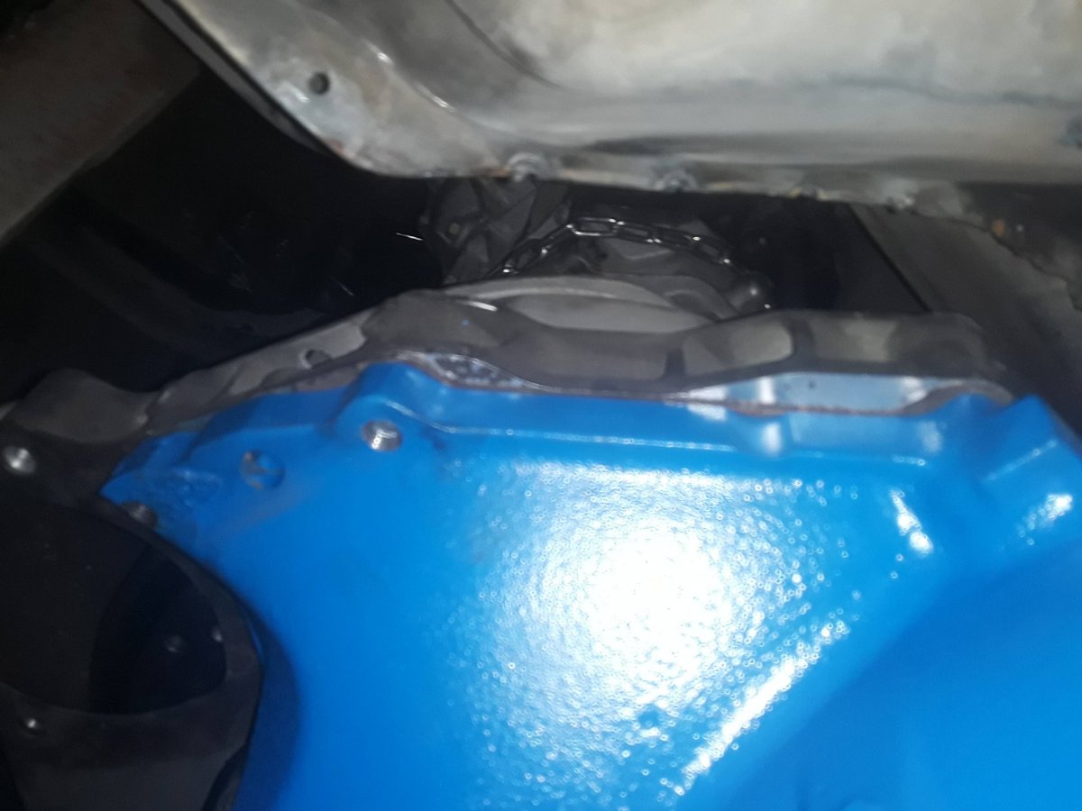

So here's those pictures I promised: To get the radiator to fit (no pictures of that sadly, sorry), i had to remove the lower cross member at the front of the body and the center piece where the valance and grille bolts in the center, and then i tack welded some plates that allow me to bolt the radiator right into the cut out of the body so its front is flush. This provided me more space for the water pump and electric fan I mentioned in a previous reply. To get more clearance even with my 3" body lift I ground the lip in the trans tunnel where the engine bay sheet metal was spot welded to another piece, and then tack welded it back together to keep the two halves joined. I fabricated my own motor mounts from 1/4" plate steel, and using frame-side mounts from a 1971 Maverick, made some functioning custom motor mounts. These come with a single threaded bolt through the bottom that slid right into the K-member where the original v6 mounts fit. the position of the stock oil filter runs right into the steering box, a 90 degree adapter may remedy this, but i chose to go with a relocation kit instead. In addition to all this (pictures not included for these next parts), I had to custom fabricate a rear sump oil pan to clear the k-member. The Falcon L6 engines only ever had front sump oil pans (except in the case of the Fairmont pans), and there is no aftermarket rear sump available for the 250, and so, I bought a used rear sump pan for a Ford Cortina from a shop in Queensland, Australia, had the flange cut off of the American 250 i had, and then welded the American flange onto the Australian pan. The pickup tube was provided with the pan and i did some mild fabrication to it as well. I removed the cross member for the original drive shafts carrier bearing, i don't like two piece shafts so i bought a single aluminum unit, and, I needed the clearance. I will need to move the transmission mount back 6 or so inches, not a big deal, and i converted this truck to manual steering to avoid parasitic drag and the headache of somehow pairing a power steering pump with my motor and gear box combo. I went with an M5R2 Transmission as noted on this threads intro, i had to cut the floor away to make room and hammer the side of the trans tunnel just a little to get more room for my extension and wrench. I did the same at the lower passenger side of the firewall by the heater box so that my exhaust manifold and its studs could fit, this was a cake walk, no biggy there either. In total, this swap wasn't as hard as i had first envisioned it being, the motor mounts were the hardest, past that, everything was very straight forward and has been done by many people before me. If anyone is interested, when this build is complete i may attempt a Tech Article about it. Lots of folks here have mentioned the 300 Six, i think that could work, you would just need to move the radiator forward or cut out the firewall, and custom fabricate your mounts, beside that there's nothing too difficult.
