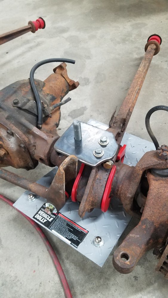

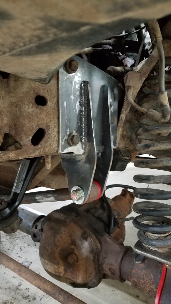

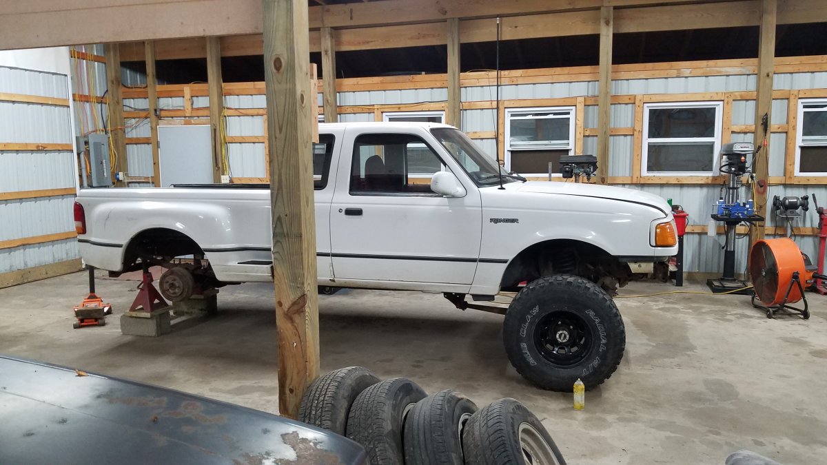

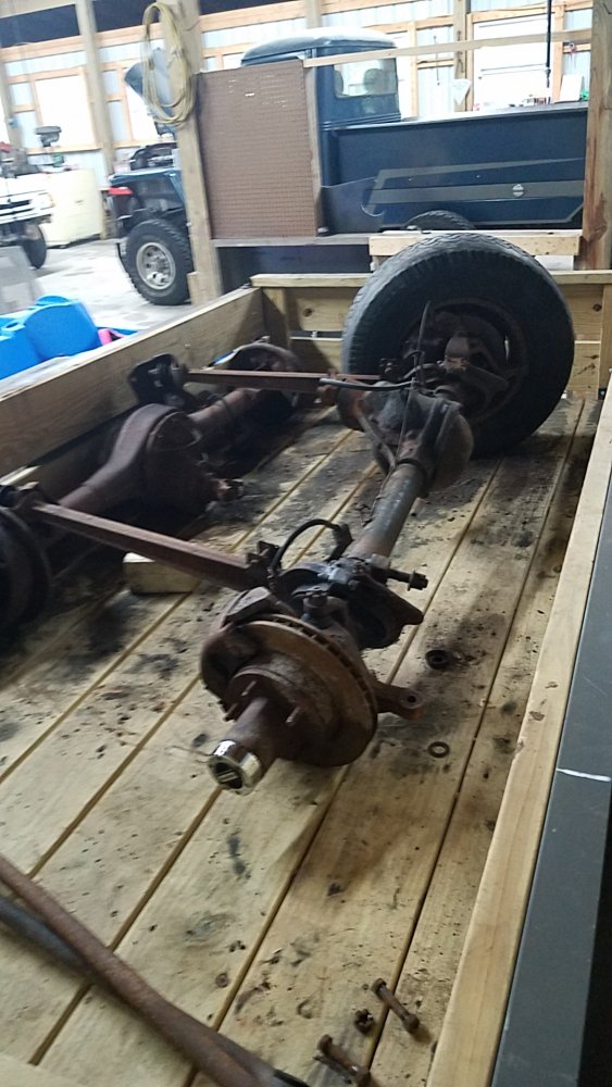

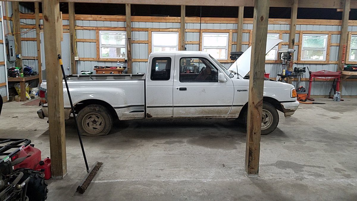

Started life as a 2wd 94 Ranger Splash extended cab with a 4.0 and an automatic. The engine and trans have been removed. Then I swapped in a D44/9. Right now I am working on cleaning up the under hood wiring, by removing anything I don't need. The way I started looking at it all I needed to retain was wiring for the lights, wiper motor, horn, and rear electrical connectors. I'm looking for someone to help me ID some wires in the c105 connector. I have 19 wires that either came from the engine harness or from the PCM. I have figured out the pin# circuit# and wire color, but I am unable to ID what their purpose is. For example: pin 35-circuit 12-LG/BK, pin 36-circuit 932-GY/W and so on.
