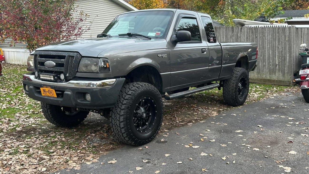

How can i go about ls swapping my ranger in ny and keep it road legal? Ive read that its gotta be the same year or newer or that the engines gotta be in the same make of the vehicle and both. ive also read that i can get a custom vehicle registration and jump through hoops to prove its safe but trying to see if anyone swapped an ls into a ranger in ny and if they got any info.

Fairly sure 2005 since his profile says that and the pic is definitely a 5th gen (hood bumps up)....though he didn't answer
