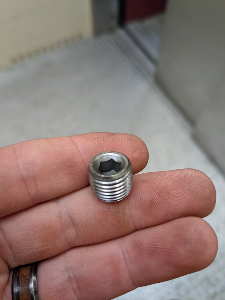

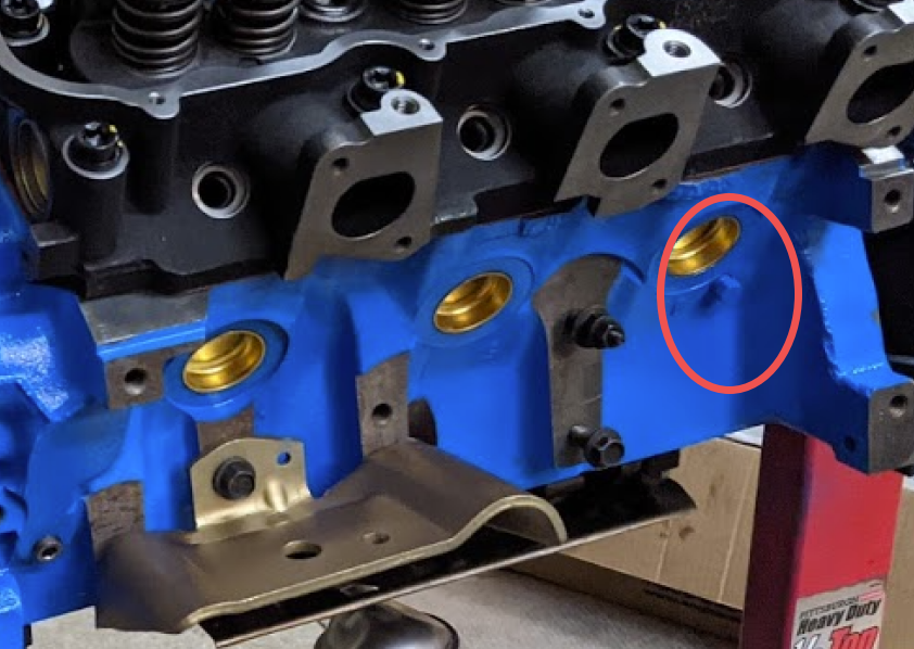

I could really use some help locating where this Galley plug is supposed to go
there is 3 in total, two are already installed on the back of the block just next to the freeze plug.
(if you look to the front of the block, left, you see a galley plug is placed in the oil pressure sensor hole next to the engine mount, this is not correct)
I NEED to find where this Galley plug is actually goes. any help would be fantastic. the block is now installed so I cant easily look the block over to find it.
