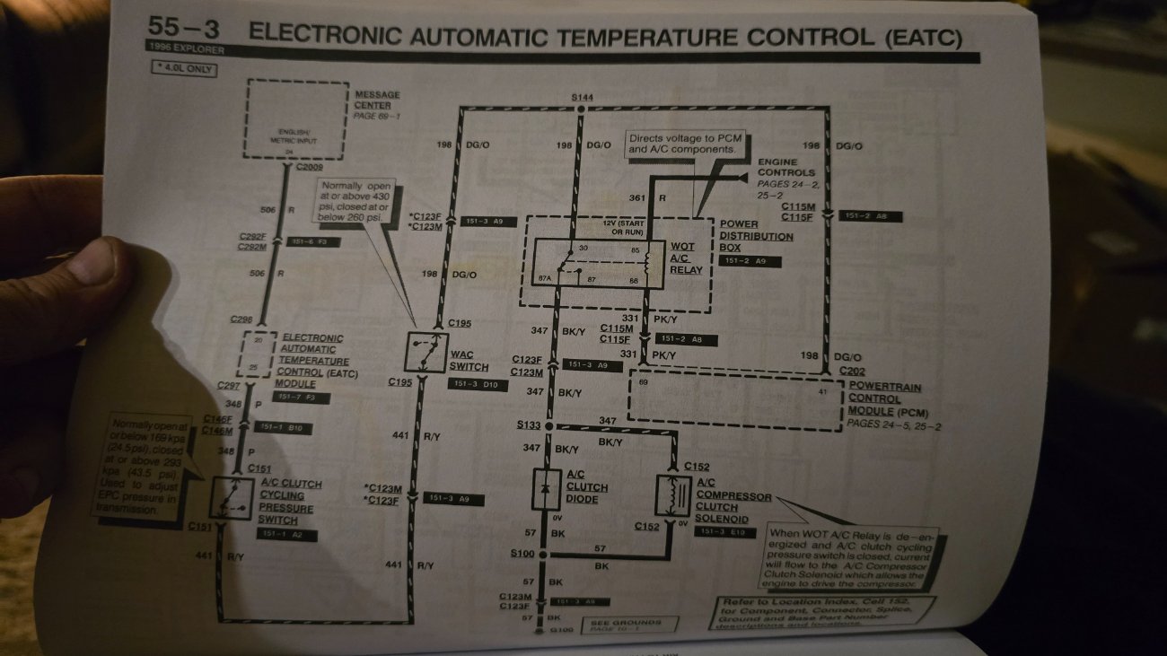

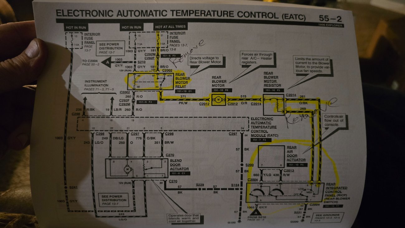

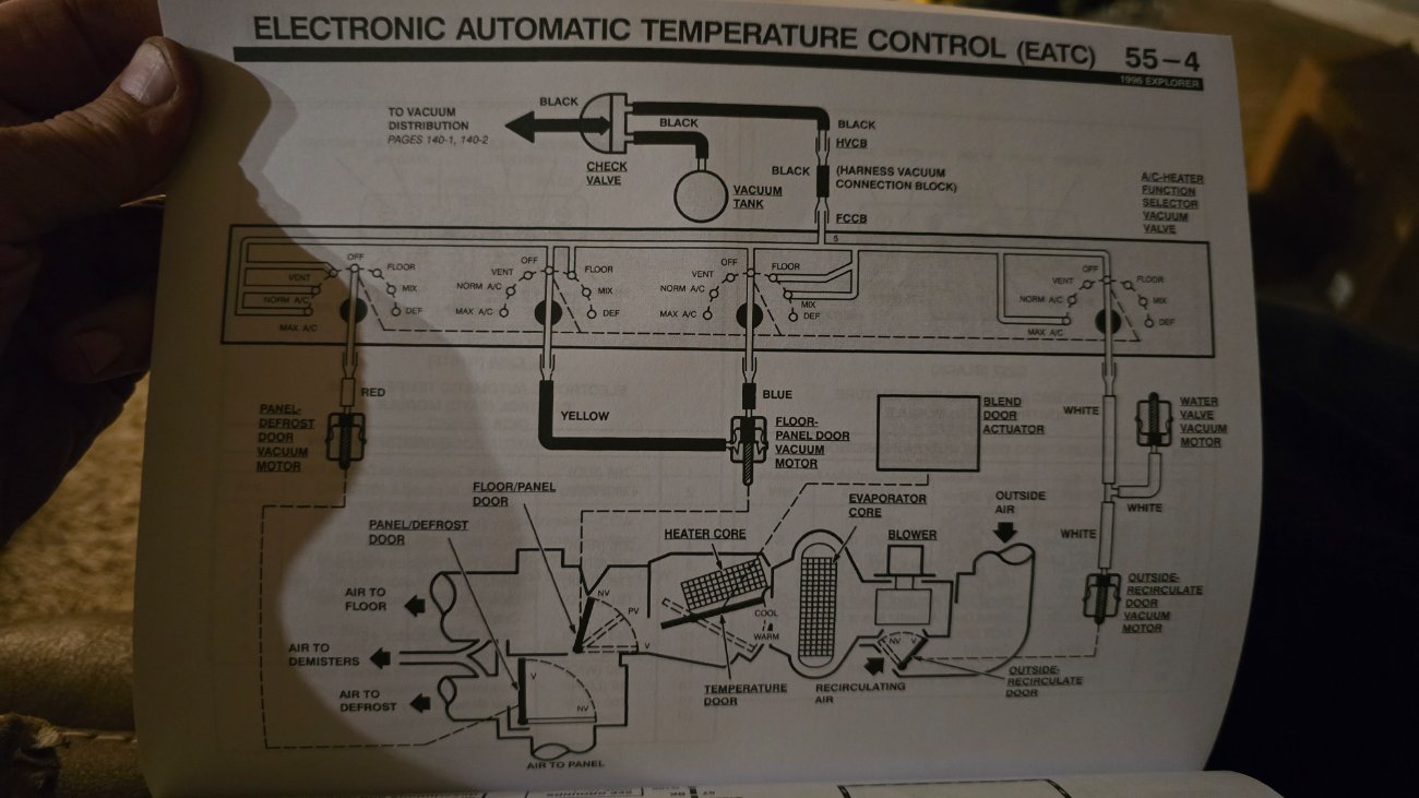

I know N3elz had a write-up for swapping the Explorer Electronic Air Temperature Control (EATC) into the Rangers but since then CarDomain has gone down and the write-ups are no longer available. I was able to find the first part available on the Wayback Machine but the install portion is missing.
I was wondering if anybody happened to have the write-up somewhere, or has done the swap themselves and would be willing to share what they did.
I can get you pictures if the EATC wiring diagrams for a 96 Explorer, if that will help. I’m getting ready to pit that dash into my Ranger. But I’m deleting air conditioning. I’ll be bastardizing that system.
