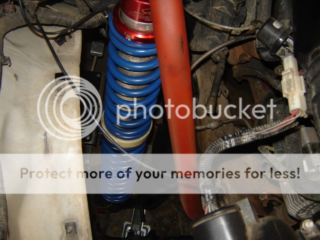

Day 2

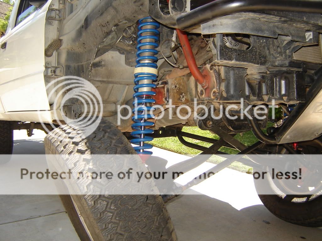

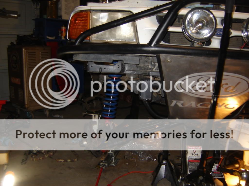

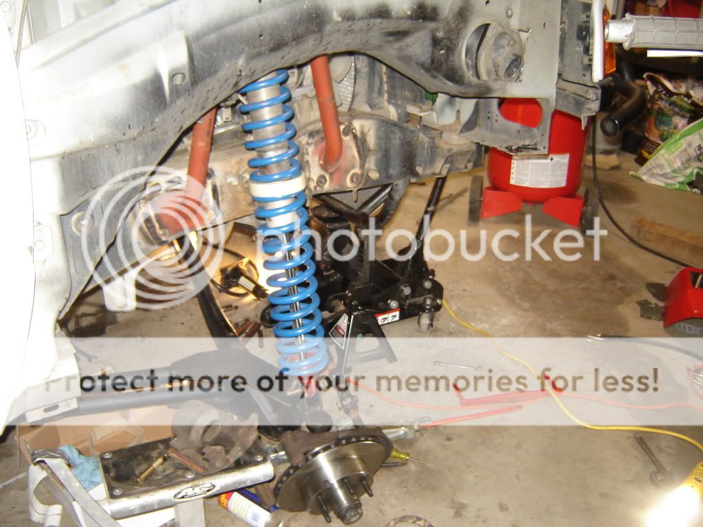

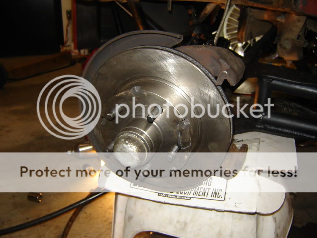

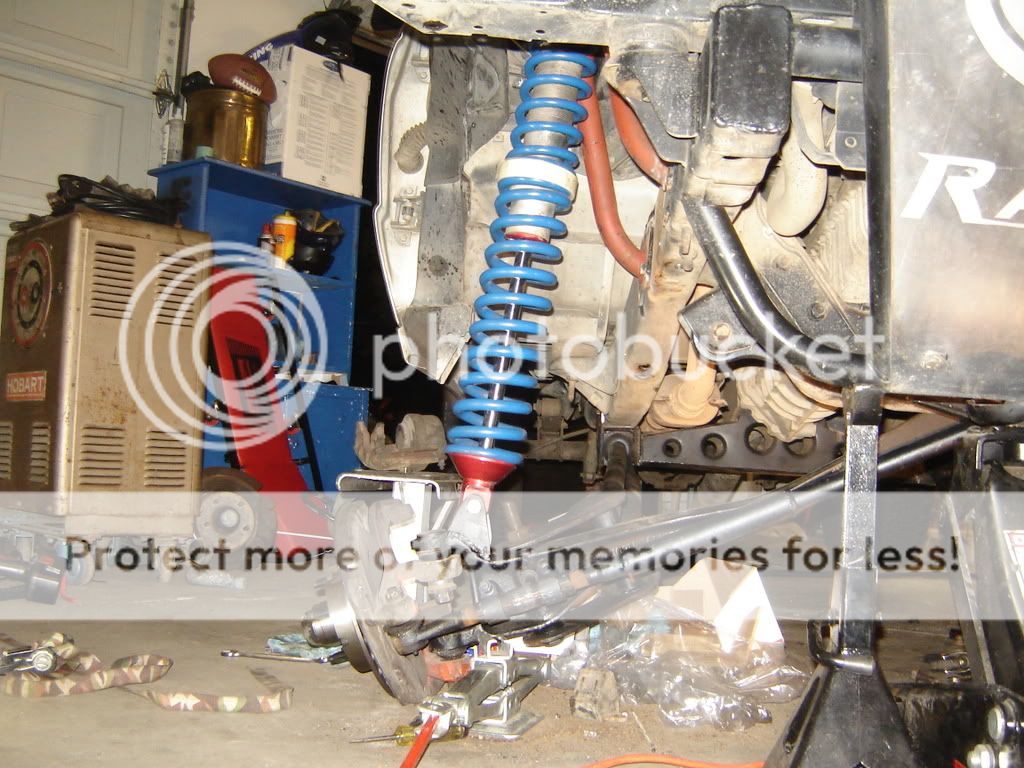

I didn't get too much done today because it was the 4th of july but we welded in the shock hoops, finished the breaks, most of the stearing, and set in the first coilover. pulled rediculous amounts of down travel.

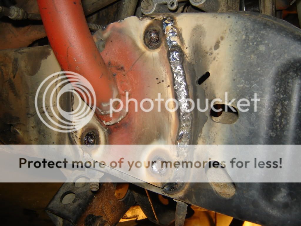

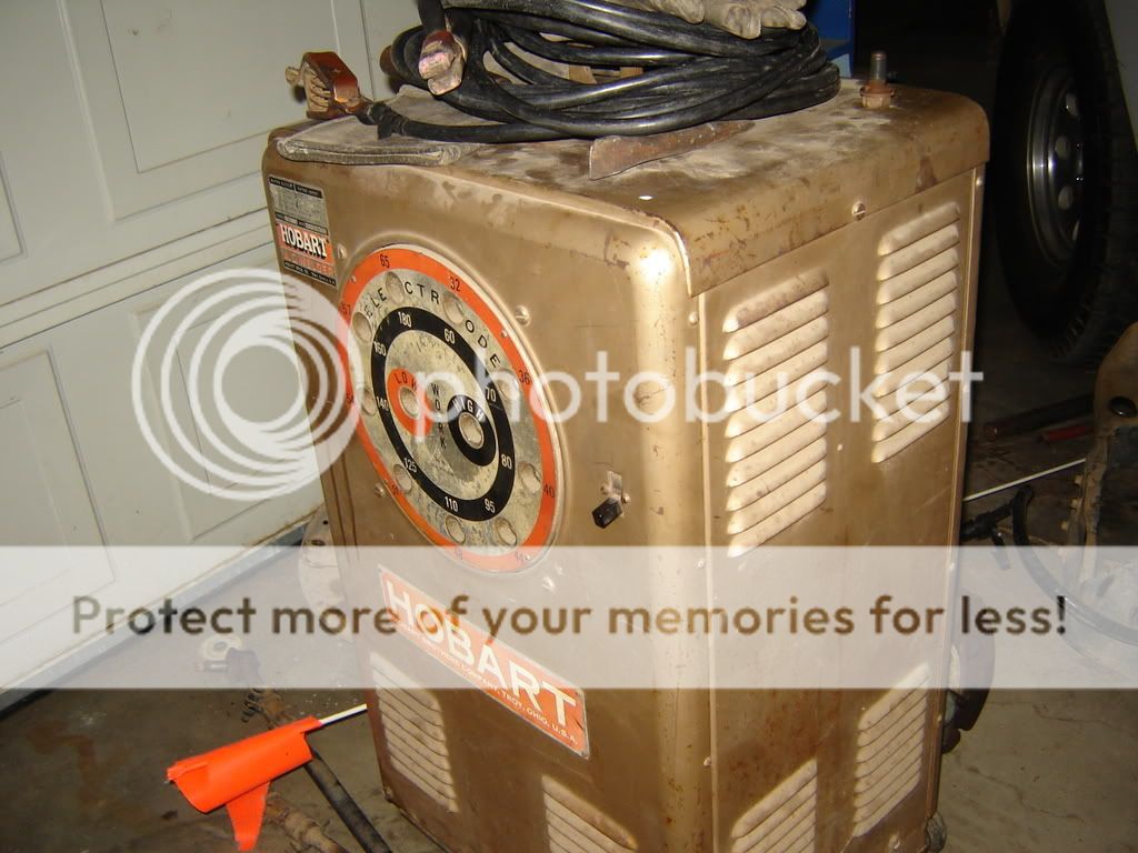

My Miller 250 was down so we welded with a 50 year old stick welder. Came out suprisingly well.

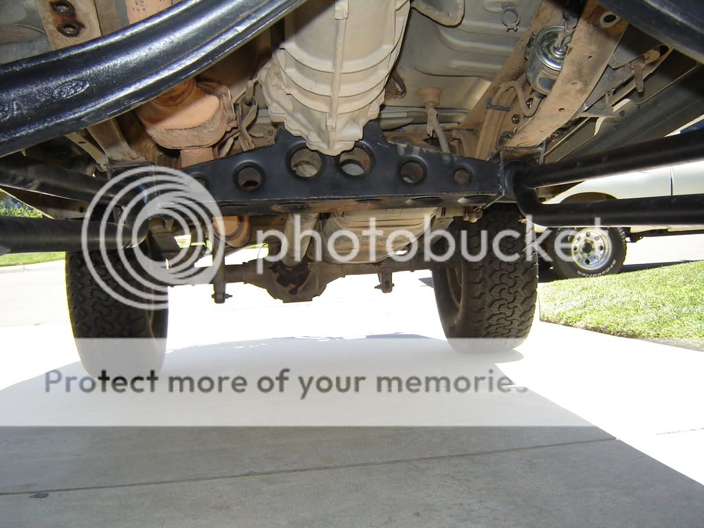

Where did you get the radius arms and tranny xmember from, they look beefy.
I bought them off a guy on race-dezert he made them himself i believe.
the tranny x-member looks very similar to the camburg x-member.

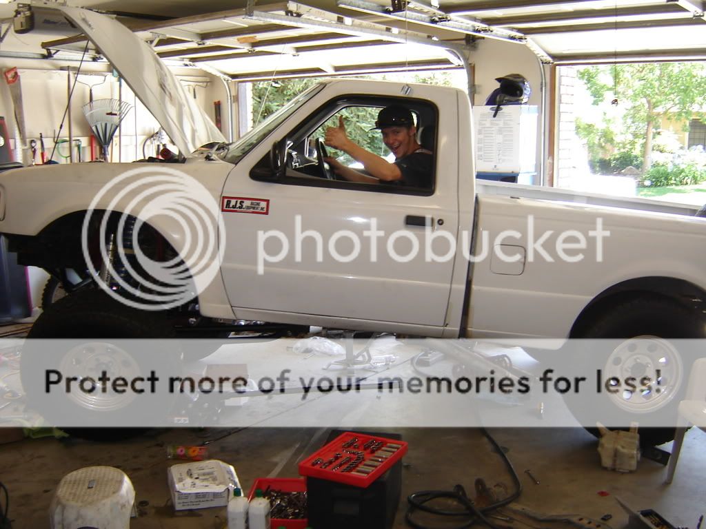

Got her back on her wheels today

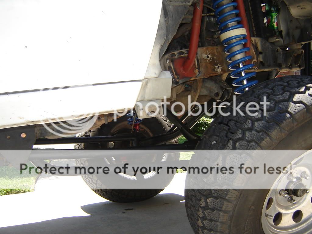

The srings are way too stiff and I have to bend the beams a little more to get rid of some camber issues.

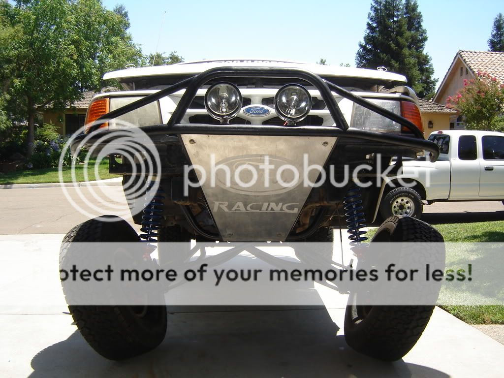

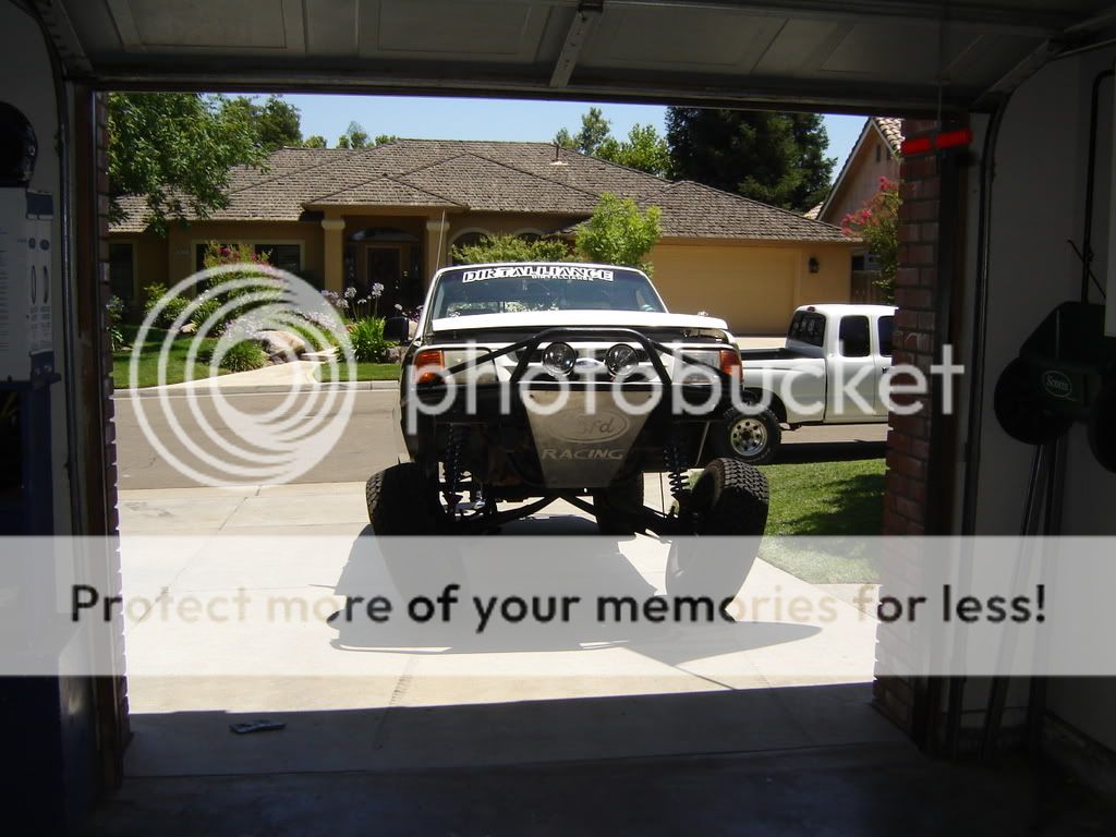

ill post more pics after i get it alligned and get the beams bent on monday
Holy crap that's alot of camber!
HAHA ya....it really didnt sit like that..the toe was set way too far out so when i backed up it pushed the suspension togather and lifted the truck alot. When i drove forward the front droped like 5 inches.
