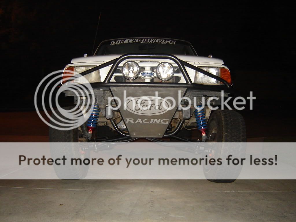

Long Travel Prerrunner project.
I mest with the springs a bit and got it to sit pretty good..it will get me to the alignment shop tomorrow.
Update on the alignment? If not, you may want to pull your toe-in a couple more rotations and it may make the drive to the shop a lil more comfortable.
It looks good man. What ended up being you total front wheel travel?
thanks..ya i gotta mess with the toe a bit b4 i drive too far. im having the beams bent a little more so it should be sitting flat by tonight. the total travel was just over 20 but i will limit it at 18

are those stock ibeams that have been cut and lengthened?
Ya..when i get everything set the way I want i think im gunna tig weld plating across both sides of the beams.
