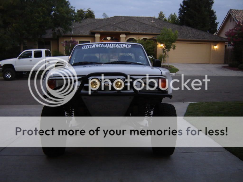

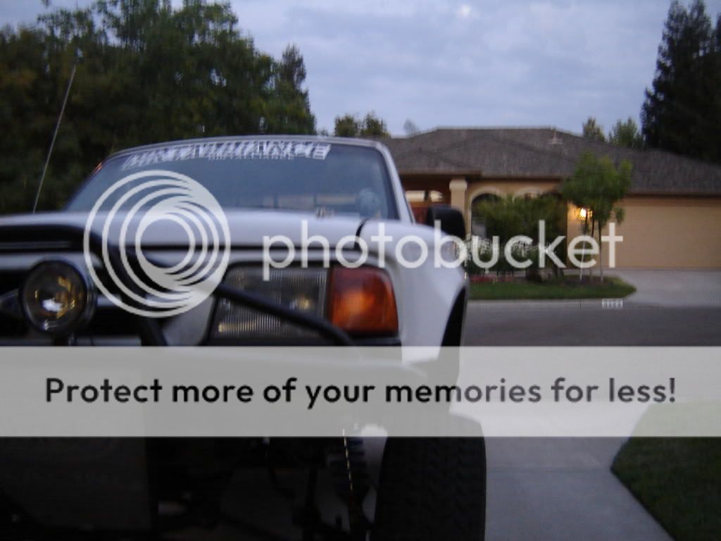

Thanks to Kwad RCR I got 6" flared feenders! looks alot better and i dont have to worry about the tires hitting.

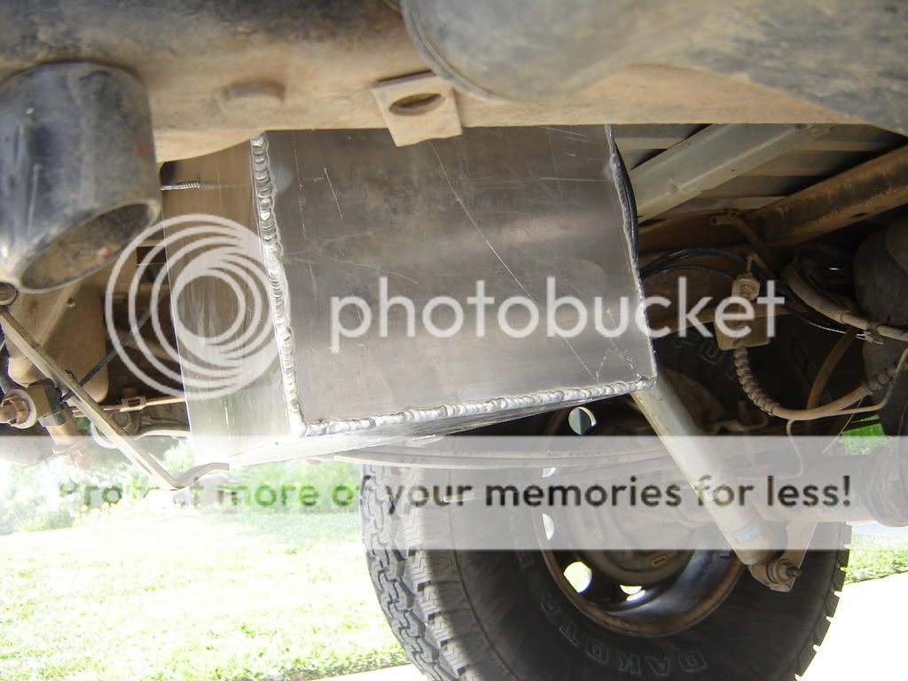

moved the battery to the back for better weight distribution.

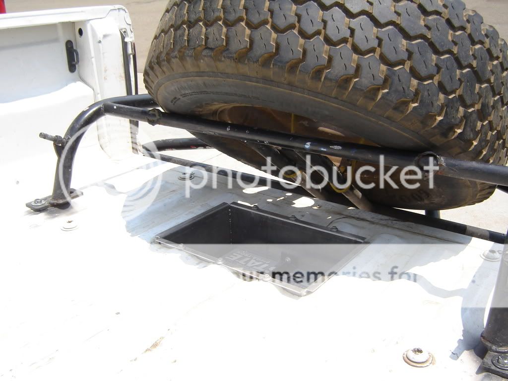

Ive been working on a rear bed cage to run some 14" shocks and new springs..ill have pics up soon.

One thing, I learned almost 30 years ago. Never, never weld vertically on a frame. You can get away with a stitch no more than 1/3 of the frame height. That includes seperate stitches in line. You will be extremly lucky if your frame doesn't break at the welds of the shock hoops! In the pic you didn't weld the bottom horizontal which would have been the most important weld if any at all. Welding horizontal on a frame will only make it stronger. Full length vertical is an absolute no-no!!!
The battery box is perfect! it looks like something I would do! I would put a cover on it though. One day on the dunes will have it filled with sand to the top and it looks like it would be pretty hard to empty.
I'm not trying to be a jerk, That is how I see it. I would be proud to own that truck.
In All My Life I Have Never Heard About Not Welding Horizontally On A Frame. Not To Be A Dick But I Dont Buy It.
My Mistake Vertically
Try it. Just don't drive it on a Highway!
When you weld steel it changes the temper of the steel next to the weld. I don't know the technical terms because I don't use them enough to remember them. What happens is that the frame breaks right next to the weld. There is ways to avoid this but, it requires putting the work into a furnace while you weld it then slowly cool it.
I Have Built Countless Amounts Cages & Shock Hoops Plated And Fully Welded To The Frame On Trucks That Get Punished Regularly. Never Had A Problem With Cracking.
Welding the tube directly to the frame would be fine. A circle is not a straight vertical line. I've personally seen frame failures from vertical welds.
Another thing that works is to turn the plate so that it is two diagonal lines.
wow ive never heard anything like that either i dont see how it could be true. Not doubting you just would like to see the scientific reasoning behind it
It tempers the steel at the heat affected zone causing it to become brittle. Being that the frame sees a lot of vertical stress, this causes problems. IMO, welding straight vertically is a big no no.
