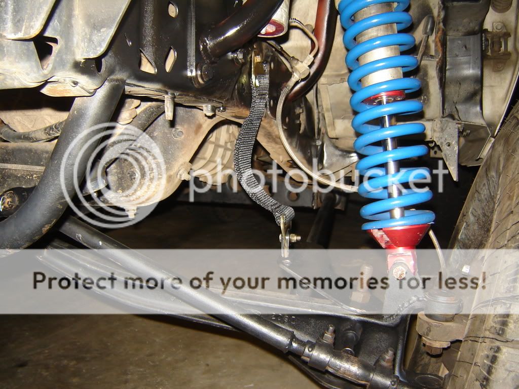

Did some painting and added limit straps today..
That steering worries me. If it were me, I'd use a piece of DOM tube and either thread the ID to accept a TRE or use a tube adapter of the same thread. The way it is cut off and welded in place with the stock adjuster just doesn't sit right with me.
I'm not trying to be negative, I'm just pointing out the few safety/reliability/durability things I see that I have an issue with.

the truck looks AWESOME! i just started to build a prerunner myself but its an 84 so im doin the motor, trans and rearend swap first, then suspension. Couple things on your truck though. i would add a gusset under that little flap of metal that sticks out on your radius arm where the limit stap tab is welded too. the more you hit full droop the more that strap pulls on that lip and it will bend and also why so much spring? these trucks usually run a 250 350 spring set up. you may notice it to be just a little stiff in the sand but in the dez it will be way stiff for that truck in teh whoops and fast sections of rough road. not bashing or anything just want to see you not have probs and curiousity.

Thanks..ya i do have extra plating so i think i will add to the radius arms thats a good idea.. well i used that spring weight because its gunna be a couple of months before i get some hydraulic bumps and i dont want to be bottoming out every where...plus they are only charged to 100 psi right now so it doesn't seem to get stiff till near full bump which is pretty much what i need for now..good luck on your build btw..
