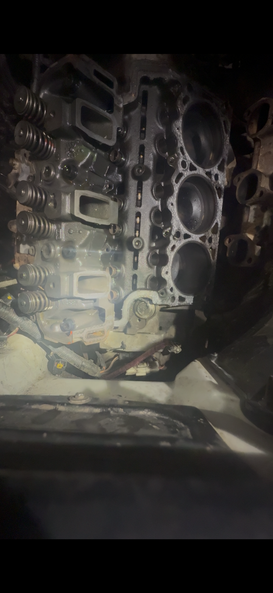

I didn’t do the manual swap that was the previous owner, I replaced the lifters becuase one of mine was clicky clacky, to get the lifters out you have to pull the heads off, they are still clacking after startup so it could be they need to bleed air out, I left them in a bath of oil for a day or two before I put them in.

So just for your information, not trying to be rude here at all I know text tones hard to interpret, the heads do have to come off, trust me I tried to get them out without pulling the heads off the hit the bottom of the heads when trying to pull them out. The pushrod holes don’t have the same width the holes in the block do for the lifters, but the truck doesn’t have oil pressure and I think the pickup screen got clogged with Lucas oil tbh. It was 20 degrees out and a 30ish year master tech I know said he runs 20w-50 and a bottle of Lucas in his ranger and he’s never had a problem and he suggested using it to quiet my lifters but I tried it it did nothing then I starting replacing them and after that I went to start it and it had no oil pressure and I don’t have any way to lift the engine to get the clearance to remove the oil pan so I sent it to a shop

Yeah I’m never listening to him againi had stuck two mechanical pressure gauges and had absolutely zero pressure, so I took it to a shop. the shop dropped the oil pan and found pieces of bearings in it, and it clogged my oil pump so I’m thinking about diesel swapping it, 1.9 tdi or 4bt
