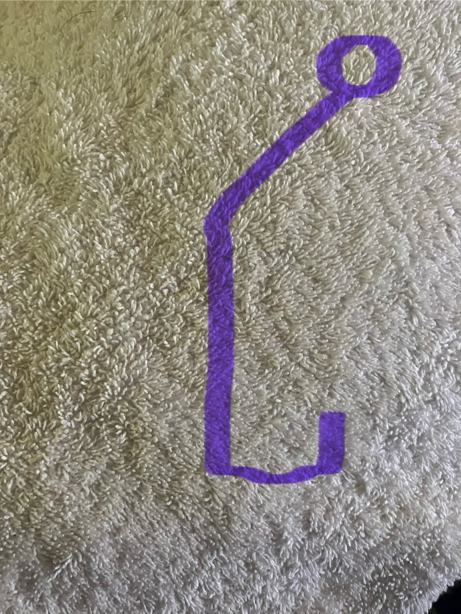

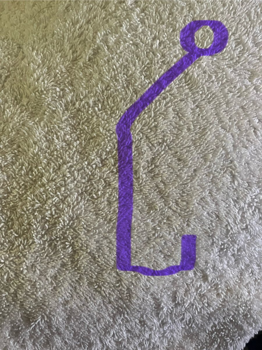

I have an 8 foot bed on my F250. I have a full length Leer fiberglass cap with a sliding window in the front, a solid window with the 20% sliding vent window on one side, I have a win-door on the passenger side, and the regular fold up glass window in the back.
I never slide the cap on and off. I installed a pulley system with four dangling ropes and hooks from the rafters in the back of the carport. I cut some 1 x 2 lumber to about 1 foot wider than the width of the cap, and a couple small 1-1/2” thick blocks about 6 inches long
When I’m removing the cap, after I take the clamps off, I crawl inside the bed on my hands and knees, and I can push up on the cap with my back to pop it free from the foam tape on top of the bed. Once I pop it free in the four corners, I go back around and I’ll use the blocks to hold it up in the corners.
Usually around 20% of the foam tape is stuck to the bottom of the cap and pulled off the bed of the truck. I go around with a paint stir stick, get it right next to where it’s stuck on the cab, and by simply twisting it gently, I can usually work the foam tape loose of the cap. Then I insert the 1 x 2s across the width, and then remove the little blocks.
I used some scraps steel to make custom hooks. The piece I used was the half inch by 3/16 inch galvanized bar that you put in a chain-link fence near the post to pull it tight. But you can really use almost anything. And I bent it with a square hook on the bottom, a riser that goes almost to the top of the cap, bends in, and then has an eye to attach to the rope. The pulleys are fairly precisely located, so it pulls straight up on the cap, and does not create any inward or outward pressure on the sides of the fiberglass. Here’s my shop drawing/blueprint for fabricating the hooks.

I lay it sideways, so I can slide the hook in the open space, and then turn it and stand it up and it won’t fall out. When I have all four in place, I use the pulley system to pull my cap up a whopping three or 4 inches, and then I drive out from underneath it. I can do it all way faster than it took me to write this instruction. And it’s just the reverse process to put the cap back on.
I haven’t done it yet, but I’ve had the thought that if you put fresh tape down on top of the bed, and then you take a piece of clear poly thin stuff, but not Saran Wrap. Run a paper thin line of silicone caulking on top of the foam, and place the poly there. That should help with sticking to the cap. In this vision, I can also see putting some silicone lube (like you would use on a window track) on top of the poly, as a release agent for the next removal. I would be curious to hear thoughts back on this.
