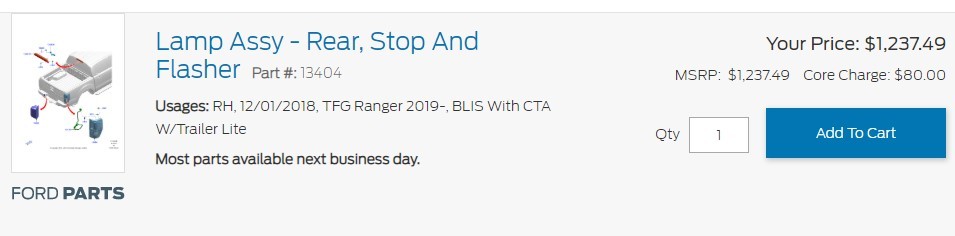

Pop out the tail lights... LINK ... but be careful with them, they are worth their weight in gold.
