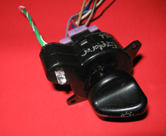

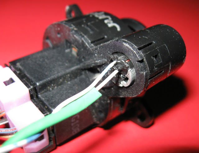

I saw this on another ranger/explorer web forum awhile ago.... I'm looking to convert my light switch illumination bulb over to LED and want to know how to mod it. I believe it is normally ON whenever the headlights/parking lights are OFF. Study the pictures and give me your thoughts.

I ended up buying the 3mm blue LED with 10" leads off ebay. It came with a resistor built in to the positive lead, presumably to allow it to handle 12 volts without frying. I began the mod by taking the original burned-out bulb out of the black plastic holder, and then used a drill bit to create a larger hole through the body of the holder for the LED wires. I put the LED in the holder with the head sticking out the top, just like in the picture.
My next task was to figure out how to wire up the LED. I figured it would be too difficult to rig the wires the same way as the original bulb, so I probed around the headlight switch harness with a volt meter and found a two wires (possibly for the parking lights) that showed zero voltage with the headlights off, but 12 volts with them on. I disassembled the harness to get at the crimped connectors, and then soldered my new LED leads onto those connectors. (I used the brown wire for the positive lead, the black wire for negative)
I installed the LED/holder in the switch assembly and snapped the truck harness connector back in place. I turned the parking lights on, and there it was....my new Blue LED switch illumination shining bright! Now I have to put the dash back together. (I'm also adding a tachometer instrument cluster from a 95 explorer as well as blue inverted cone LED's for it)

Here's a pic of what mine looks like just prior to reassembly.
The red and black wires on the right of the pic are the LED leads going into the stock connector. Brown to Red, Black to Black. I left the LED hanging there to show how it fit inside the holder.
