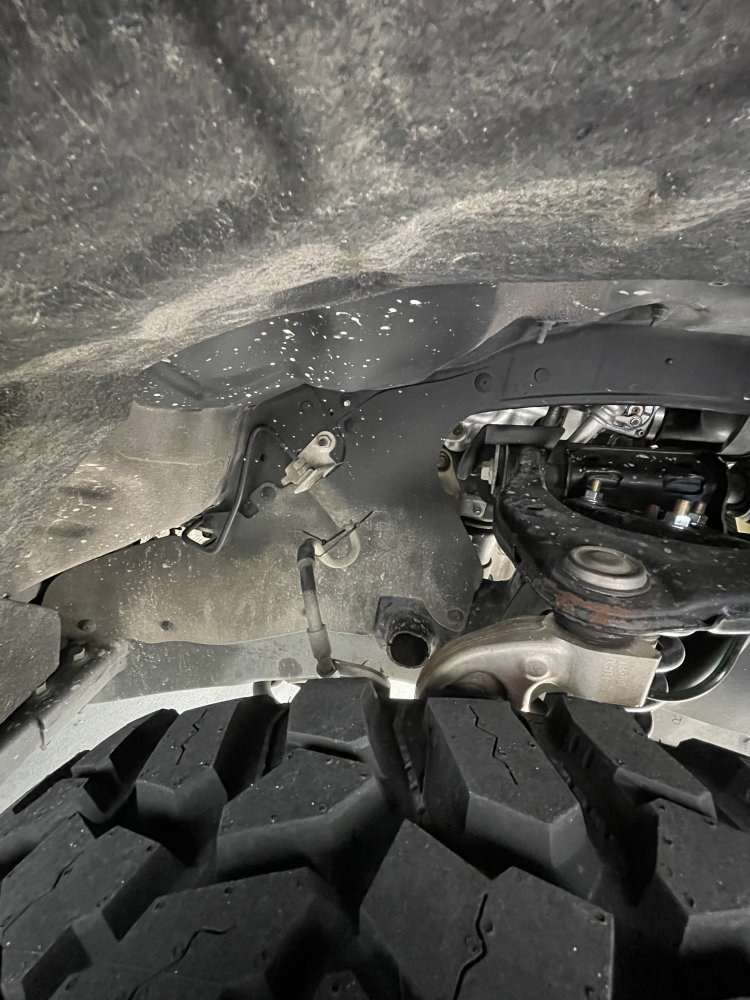

Did some research and really liked the look of Cooper Discoverer STT Pro. Installed 265/70R/17 with 2.5" Level kit. I have read that there is no rubbing, but I am expeirencing rubbing, just on the right side turning right??? Any idea what may be causing this?
Have you checked where the rubbing is? Jim had to move the bash bars as far as they would move away from the tires to eliminate any rubbing. But, we need to know where the rubbing is in order to possibly help.

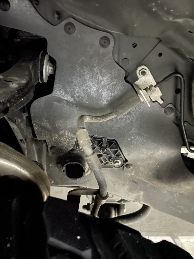

From what I can tell it’s rubbing on this line. Not sure what it’s for, I moved it over by hand and it seemed to help, I may need to use a zip tie or something.

ThT’s the brake hose for the caliper. Careful how you tie that back. It needs to move when the suspension and steering does.

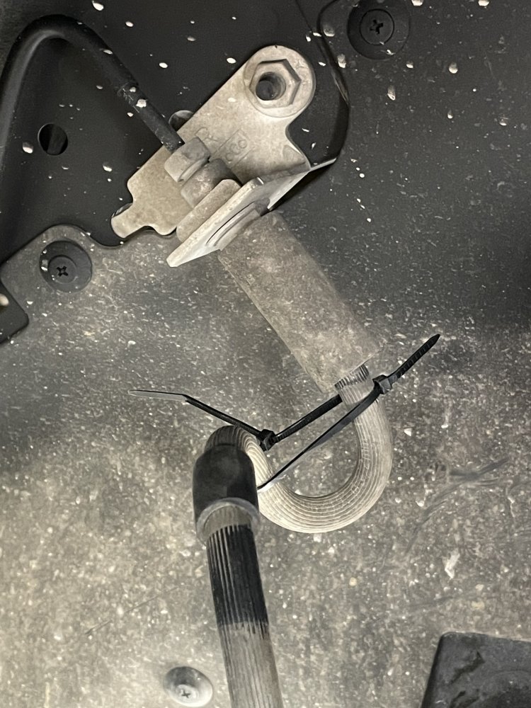

That’s definitely where it was rubbing. I moved it in a way that the loop was not facing the tire. Held it back with a couple of small zip ties, and that eliminates the rub. Not sure if there is a better solution to this?

You’ll just have to give it a whirl and see. At least with those zip ties, the ties will snap before the hose gets damaged.
Other options would be tryin the reorient the hose by removing the caliper and trying to rotate it different ways and see if it helps without binding or pinching the hose.
Anything else would require disconnecting the hose either at the banjo bolt or where it threads into the hard brake line. If you don’t have the tools and equipment to do that, I wouldn’t recommend doing it yourself. Taking it to a shop might become necessary if the other methods don’t work.
