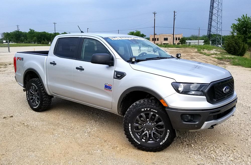

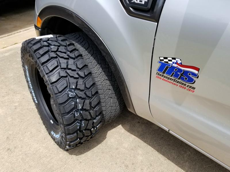

I put Cooper Discoverer STT PRO 265/70/17 mud terrains on this 2019 Ford Ranger FX4. Stock height - no lift. No rubbing! And yes, I turned the wheel back and forth to check clearance.
Stock: 265/65/17 (30.40x10.40x17)
Coopers: 265/70/17 (31.93x10.70x17)
The new tires are 1.53-inches taller than stock, so the truck picked up 3/4" of ground clearance.

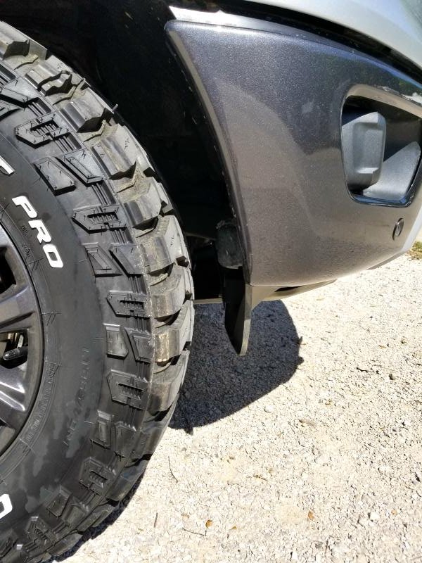

In the next (2) photos, you can see that there is still room between the tires and the crash bars (the rectangular bars that extend out from the frame in front and behind the tire)

Any Regrets Jim??? I might do something like this
No, the tire gives the truck a great stance.
I'll have to make a mental note to remember to check back on this thread when I get around to buying some rims for mud tires.
The new tires do make it look much better. Looks better than stock for sure.
Sweet... that does look much better.

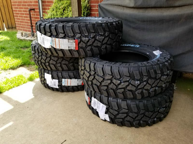

That truck looks great! I noticed you bought five tires - does that Cooper fit onto the spare wheel, or did you need to source a wheel for the spare? Any troubles getting it to fit up there under the box?
I ordered these tires today! Going to pair it with a 2.5" level lift and get it all installed probably in March. Really excited! I only ordered 4 since I'm unsure about the spare fitting in there.
The 265/70/17 fit the spare location fine
