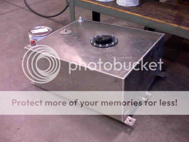

Oh, and I got one of the next pieces of the puzzle, my fuel cell.
