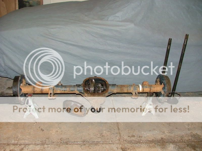

ANd here is a shot of my FW 8.8

Just gotta decide if I'm gonna nut up and buy the Dutchman axles or just redrill mine 6 lug......

kyle - I'd get the dutchmans. oh wait, I did. :thefinger:
If you can redrill the stockers and get the bolt circle spot on, go for it dude. I wasn't going to try it with hand tools. Its gotta be close. I didn't want to risk having the wheel offcenter a little bit.
I am going to make a jig that fits over the center hub tight then just transfer and drill off that. I have big drill presses I can use at work so it should be alright. I will have to weld up a couple old stud holes, but no problem. If it doesn't work out, I will just spend the $225 on the dutchmans (which isn't bad) the $60 to ship sucks!

You'll probably be good to go in that case. If anything, if it isn't 100% good, order the Dutchmans and keep the redrilled ones for spares.
