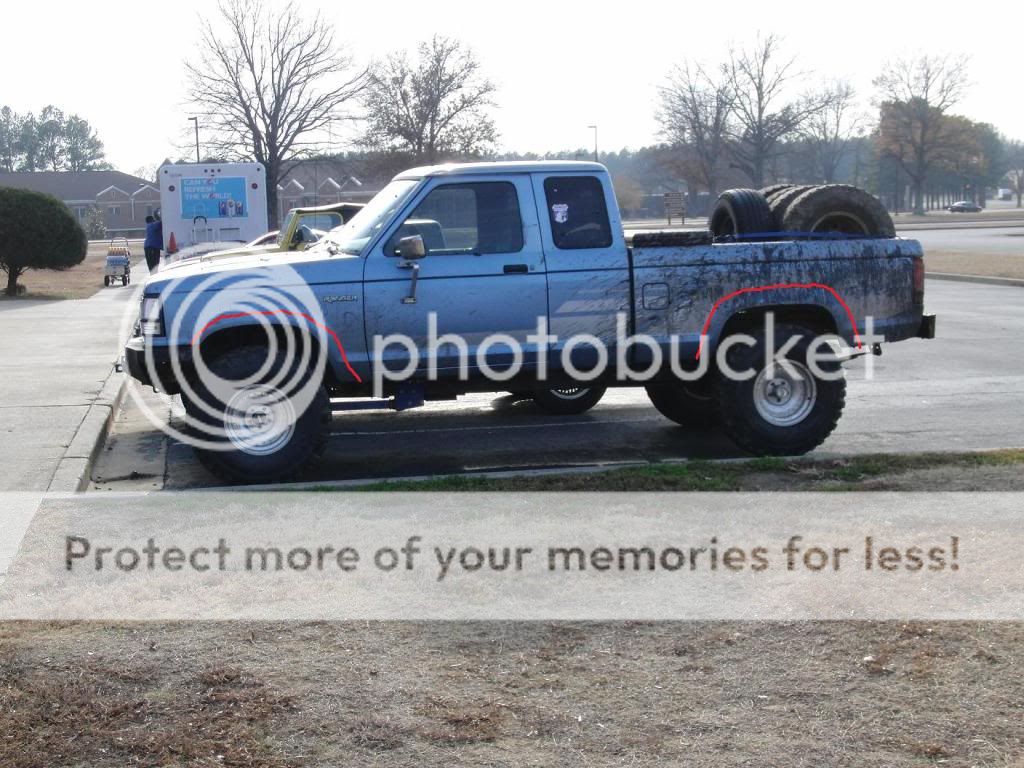

Just depends how long before Johnny Law comes knocking at my window:D
I know my truck picks up and throws a helluva lot of snow. Doesn't take long for the damn thing to dirty itself right after a cleaning:icon_rofl:
When I cut mine I followed the arch of my flare. I am sure you could rig up a string off your hub and swing an arch, then flaten it out to get the shape you want. How are you gonna cut yours? What shape?
As of right now I don't really need to cut much for the 34s. When I burn these tires up and upgrade to 35s I don't want to cut them again so I wanted to just follow the flare line on the fenders already. I will use a grinder to chop them up. Also it looks like you ditched the mud guards up front, how is that working out so far?
I have the wheel liners to keep the mud off the engine, but they don't cover the hinge area and I pack it full of shit every time I go out.....I don't like it.
My cousin cut his fenders on his 92 like that, looked good.
