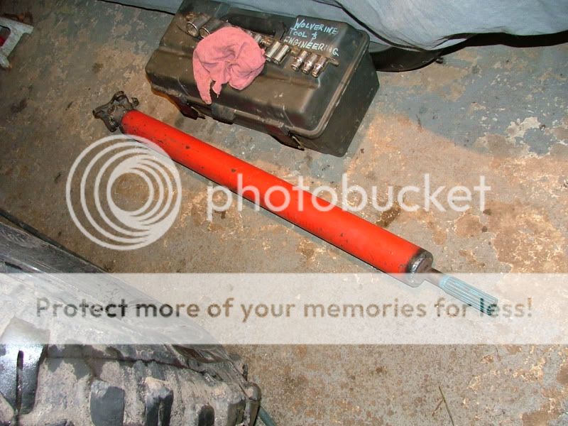

I also made a new rear drive shaft out of 2.5" poop pipe with a 1/4" wall, should be stout. To balance it, or true it up I tacked the yokes on and bolted it up to the truck the spun it with a indicator on it and got it within .020. I think the tube is a little out of round so I think it is almost perfect. We will see. I am going to have another one made so this will be my spare just in case since I have problems keeping them in good condition!

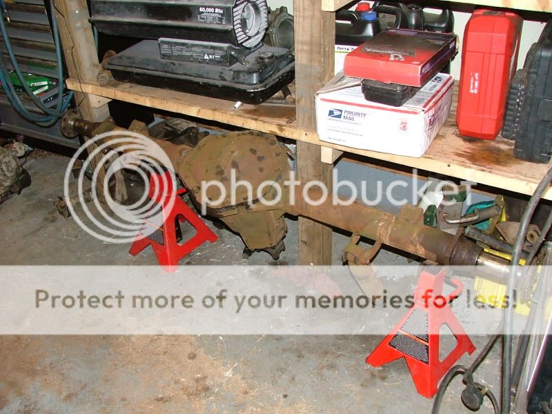

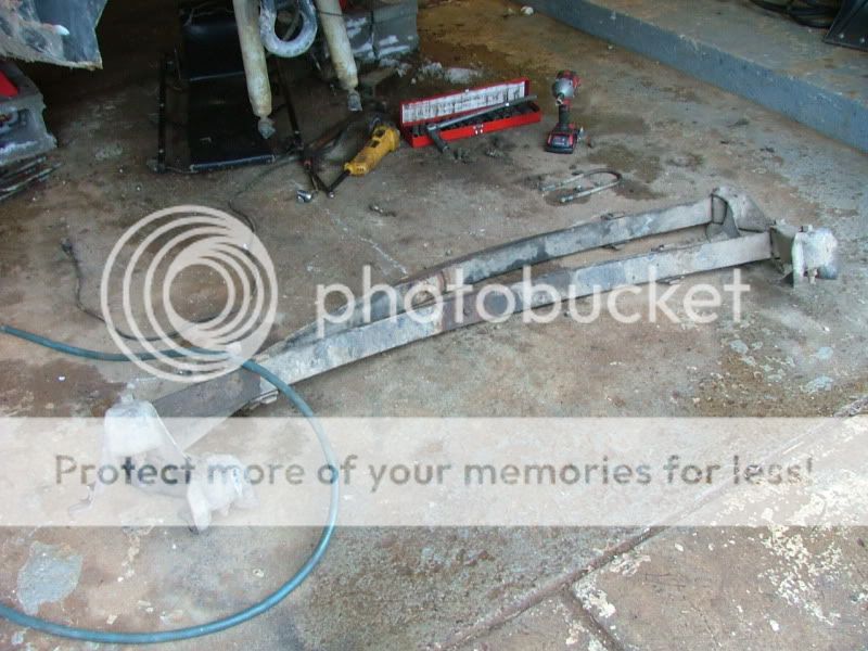

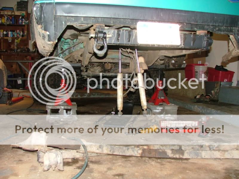

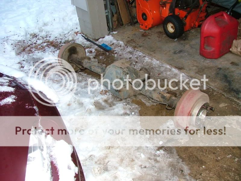

Here are a few pictures of todays progress
Kyle M's Ranger Rebuild
out with the old

gonna reuse these

new poop pipe shaft

and new to me 14 bolt, start to my road to one tons....
