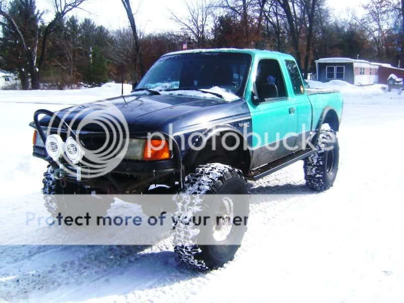

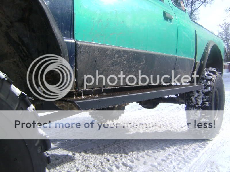

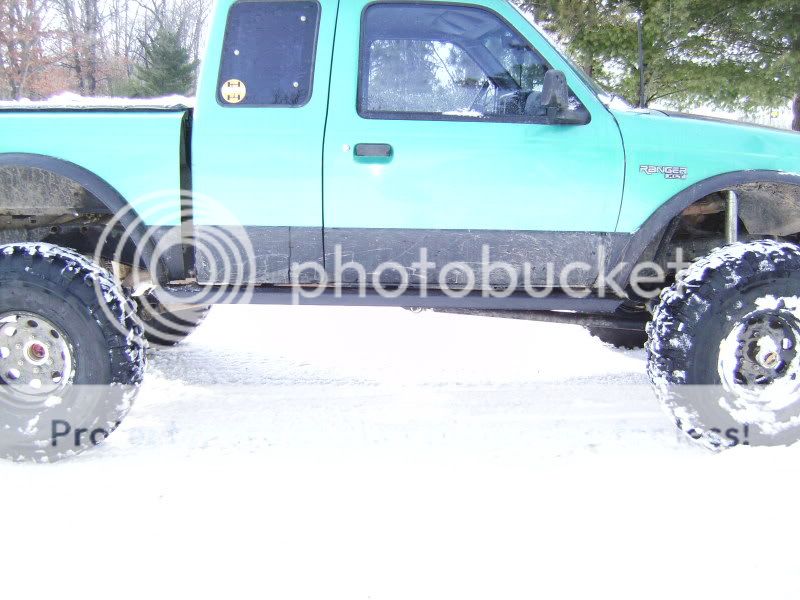

Welp, went ahead and put on the sliders last night, finished them up today after work. I guess I am happy with them, they are really sturdy so that is a plus, just not sure if I love the look or not. If I do put on an exo these will be a great foundation!
Anyway, here they are
time for some action shots, enough posing, lets go wheeling!
i like them. and once you exo it its not going to look like they stick out as far. an as for my slacking it has come to an end. lol just gotta hope my water pump isnt moving because of ice and not it seized... ill find out tommorow supposed to be +3

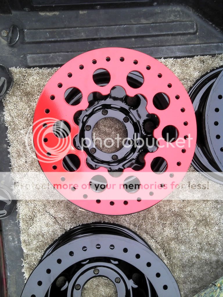

I'm gonna order up some bead locks, help me choose, should I go bling or standard?
I like these but am worried they will be a pain when i wanna air up
here are the other choices
http://www.crawlfab.com/index.php?p=2_50
let me know what you think
Bigger rings hold more mud/snow so they're harder to clean out, and can make for a rougher ride on the street but they help resist coning and hold up better when they get mashed into rocks etc.
50/50...
i gotta say, the Spider locks or the Spoke Locks are my favorites. But then again, I like just the plain bead lock rings. I am going with Raceline Monsters.
I don't like the huge rock rings. Most of the competition buggies at KOH were not even using them. I figure if they don't need them, neither do i
Since you're racing in KOH right? :thefinger:
I'm a fan of the more conservative rings too. BUT, those red ones look pretty sharp. I'd probably keep it simple though. Less weight, holds less mud, etc.
