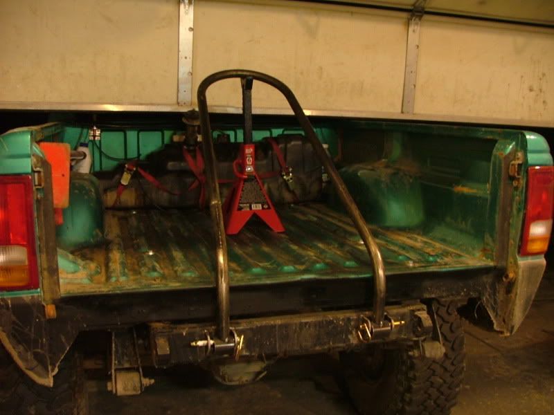

Still thinking on the fairlead, so I started on the spare tire carrier/tail gate combo. Got the main hoop bent up, so far I'm not sure, but here it is. Gives me lots more bed space!
Kyle M's Ranger Rebuild
Gotta make some brackets to lock it up and add some more tube, but you get the idea.
When it's down with the tire on it, how heavy is it going to be to get it back up into the bed ????
Robert
To be honest, I'm not too worried about it. I probably wont ever put it down, but if I have too, couldn't be too bad, the spare only weights about 80lbs......haha
I am making it reversible, pull the pins and flip it 180* so the tire is out of the bed if I need more space too.
Anything will beat throwing the spare tire in and out and having sliding around.

just as an idea, try putting the tire on the bottom. wont block so much rear view

Yeah, maybe. We will see when I get further along how it all fits. For all I know I will hate it and start over.
