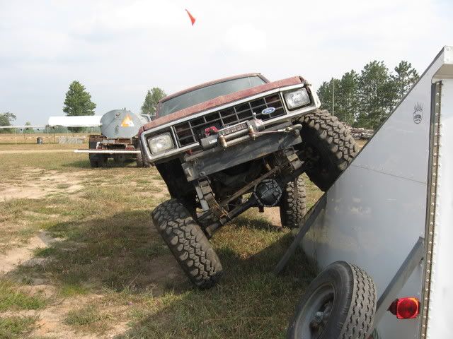

They are more rashed up than I noticed last night, not sure how I am gonna like that being I still drive the truck to the trails. I still need to get them balanced. I also want to get narrower rims so my rim isn't so exposed. Anyone wanna trade the 8" wide rims for my 10"s?
Winch wired up and functional, see the control box behind the grill?
