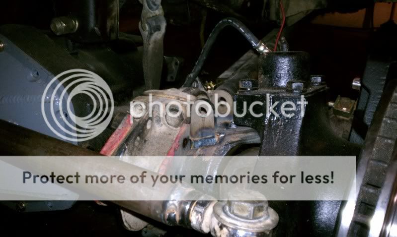

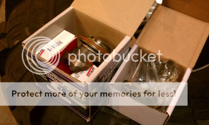

My new yokes, 1310 for the 60 and a 1350 for the 205

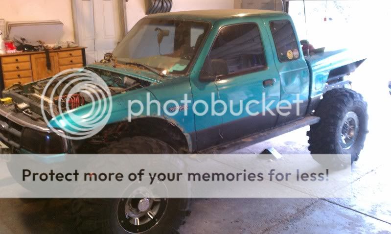

The truck is a roller, sitting on bumps in the front.

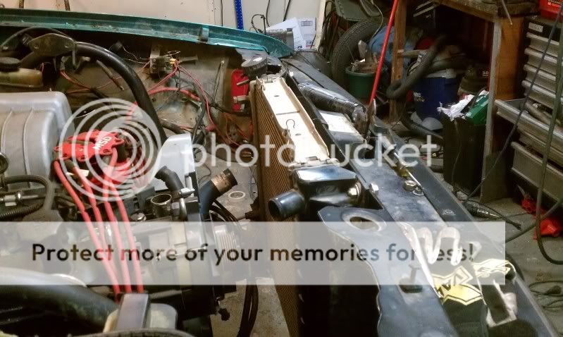

Got my radiator mounted, had to cut up the core support quite a bit to get as much room as possible.

Cut my floor up, got the case installed. Installed my new yokes on the case and 60 too. Started on my front shaft. Then I made my new tierod and got my steering together.

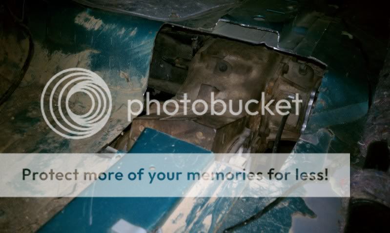

Here is my floor, in all its dirty glory.
I think it will be easy to make a patch panel
Here is the radiator mounted
I have about 2.875" of room and the fan I ordered is 2.625", will be tight.

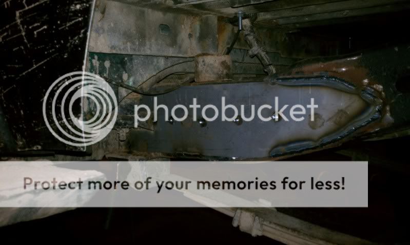

Then here is my frame gusset/fish plate. Started welding it and ran out of wire today.

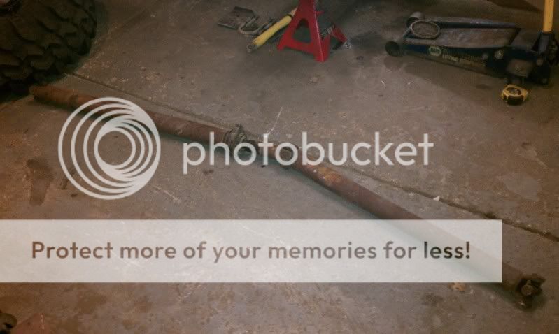

Picked up my soon to be custom 1350 drive shaft yesterday

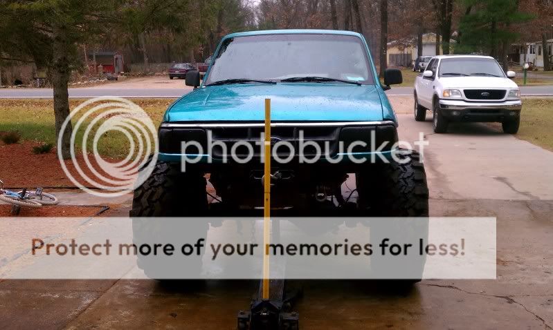

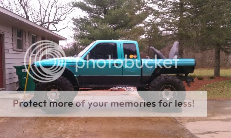

Rolled it out of the garage today while cleaning and snapped a couple pictures. Used the jack to lift up to ride height.

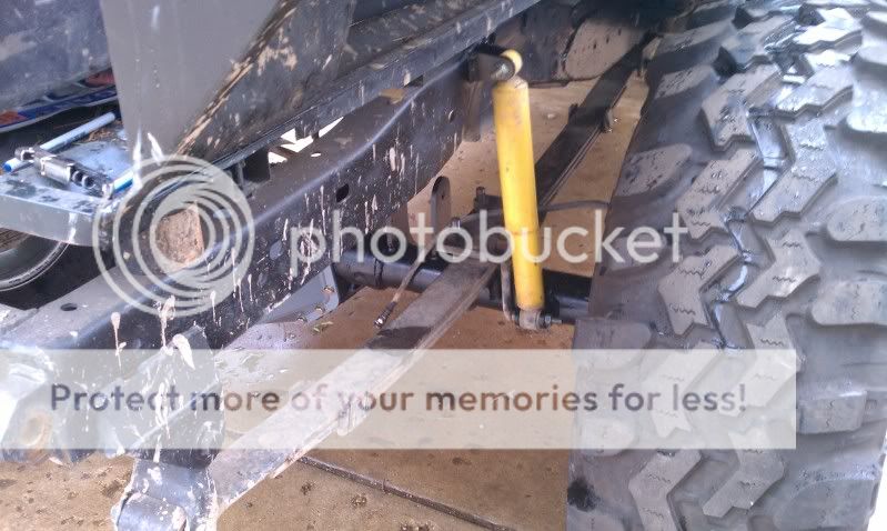

Here is a pic of my new shock location. Couldn't fit it where u originally had them inside the frame
those shocks going to be long enough? mounted outboard vs inboard effectively changes the length need, as they are further from the center of rotation, and thus need a longer shock to equate to the same amount of flexure....just a thought I had
