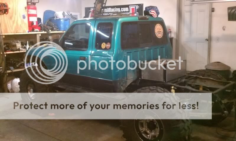

I am planning on shortening the bed another foot, maybe just use bed sides and revise the rear shackles and hangers so I can shorten the frame. Gonna start that project next.

I planned on shortening my bed to a total of around 40 inches, basically just before and after the wheel wells, for better wheelbase and departure angle....Looks like you have the same idea, but I know you will get yours done before mine...I'm stuck in Utah for school right now....

you ditching the old bumper? i love this pic by the way
For now, I think so. It was a pain to work around so I cut it off. I will do something latest on when I cage it up, but I am kinda digging the clean look.

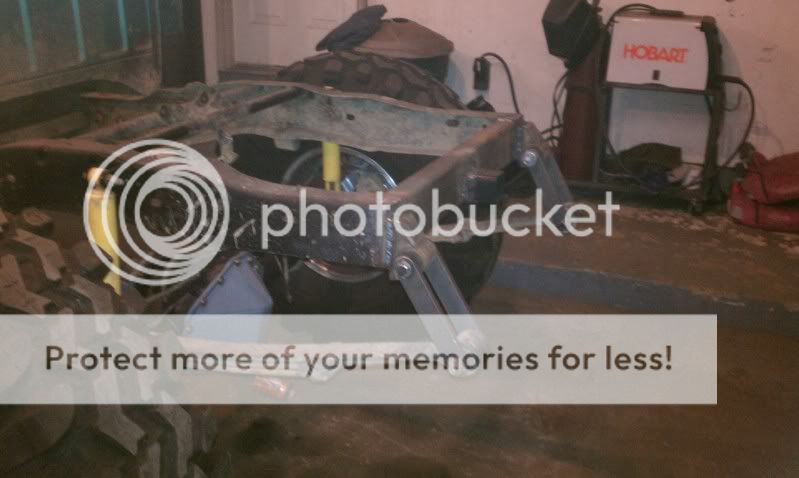

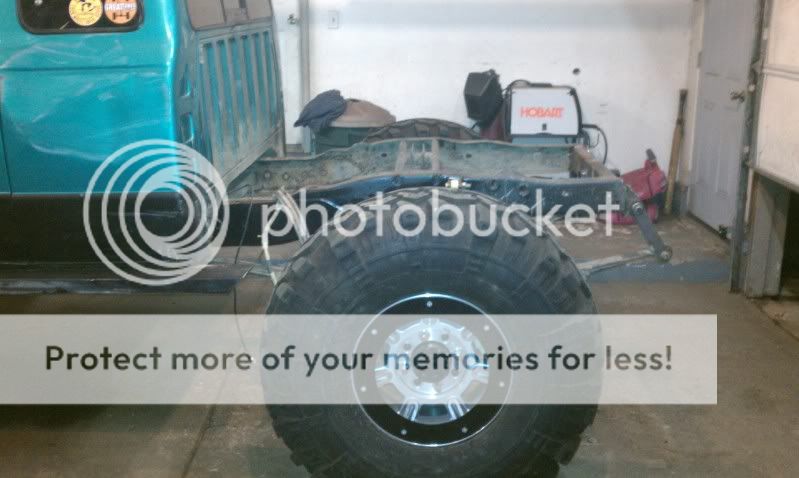

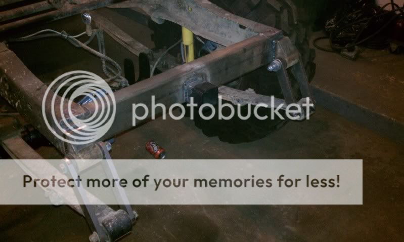

I cut 10" off my frame, then made a new crossmember with a hitch in it. Then I made some shackles 7.5" today, put some hangers on the new crossmember and welded it all together.
Much better

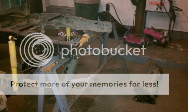

I also made my front drive shaft today and picked up a new master cylinder (not sure it will work yet)

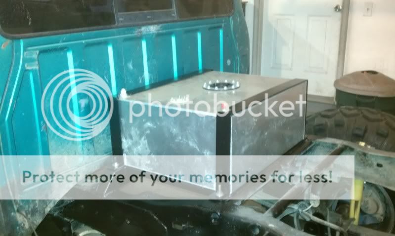

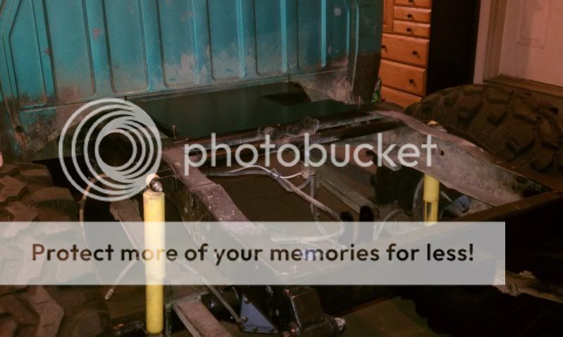

Fuel cell in.

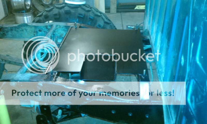

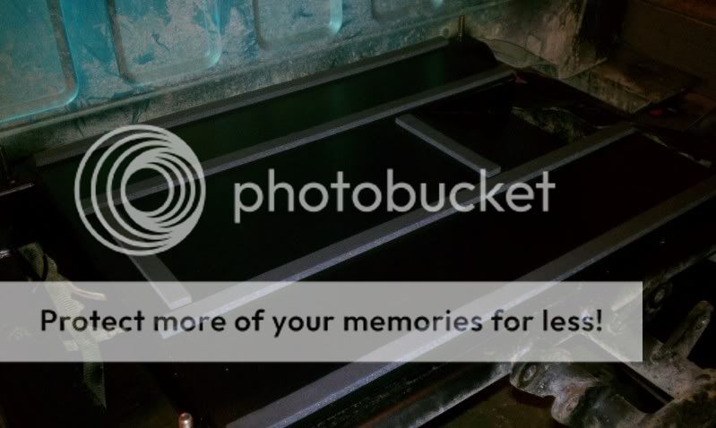

I made a sub frame to hold the cell on my frame, then I skinned it with some 1/8" flat sheet to act as a skid.
Then I used some foam tape to protect the cell from rubbing
Then I mounted the cell with a couple straps I made with foam under them to guard fron rubbing
After that I started on my rear driveshaft. I also found out the 96 f350 master cylinder is a direct swap minus push rod adjustments. I installed my air shocks after charging them so the front is done.

The cell mount is very clean. Nice work. The rig is lookin really good man.
