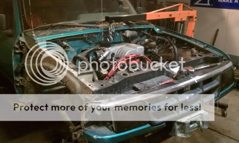

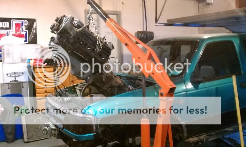

Motor is in its home, tranny is in. Next is to make a crossmember then mount the t case.

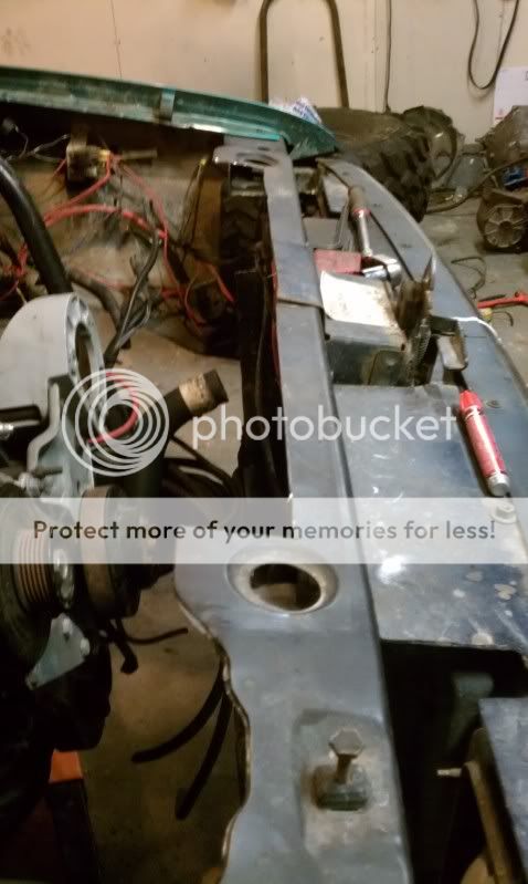

I gutted the core support for radiator clearance, should have lots of room. Just need to figure out what radiator I am gonna use.

It looks happy in there.

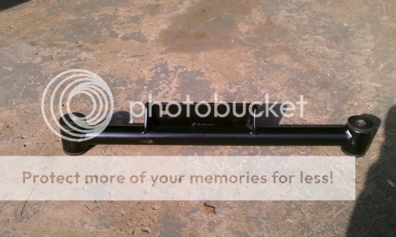

Made some progress today, fabbed a new crossmemeber. INstead of using a tranny mount I used a couple bushings at the frame. I had some shock tabs laying around and so tube so I got building. Heres the crossmember
