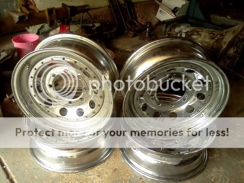

Picked up some brand new rims today, the deal was right so I got them. I wanted 17's but these are 16's. And I was told they were 7" wide but they are only 6 with a 3.250 backspace. Should work fine for me with some weld on beadlocks. They will end up about 7.5 wide. Now I need DIY locks and tires.

and some NOT chrome rims lol. its to shiny for the truck

You wont see the chrome under all the dirt. :headbang:
yea but even still a 7.5" rim? my ranger had 8"s on it and that was still too narrow for a 12.5" tire
if ya running lower pressures...then an 8" rim is really optimal for a 12.5" tire....

I am running my 40x16x16 LTB's on basically 16x7.75 rim. The DIY kits add .75".
I think they look just fine on the width. They don't appear to balloon out and I have never had any issues.

Yes they are narrower than I wanted but for the money I wont complain. On a offroad tie with 3lbs of pressure I just don't think it will be a problem. It will help me protect the beads too. Worst case I will use them as spare rims or rollers.
