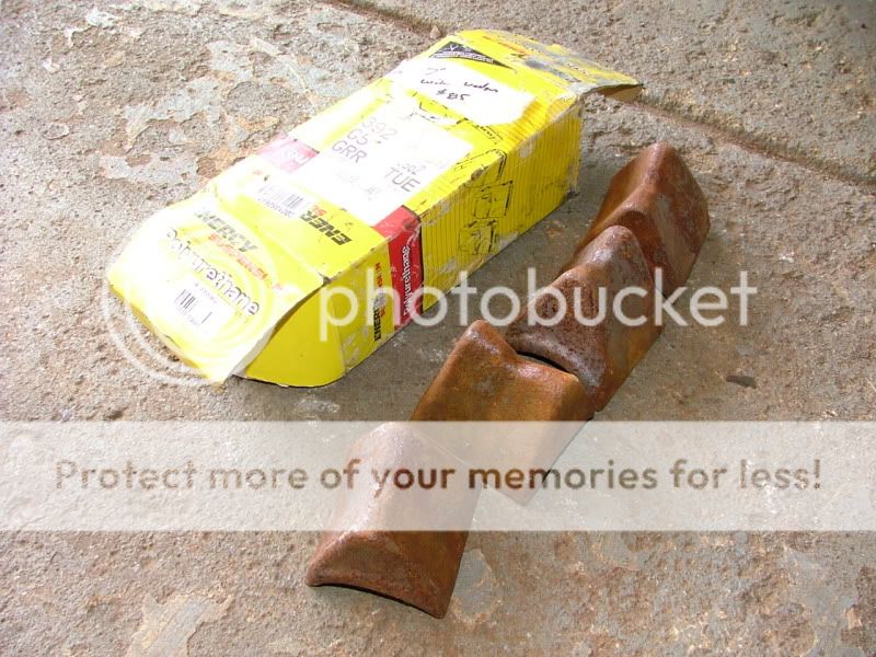

My weld on wedges and new bushings
where did you get these? i tried finding them on bronco graveyard but i couldnt
