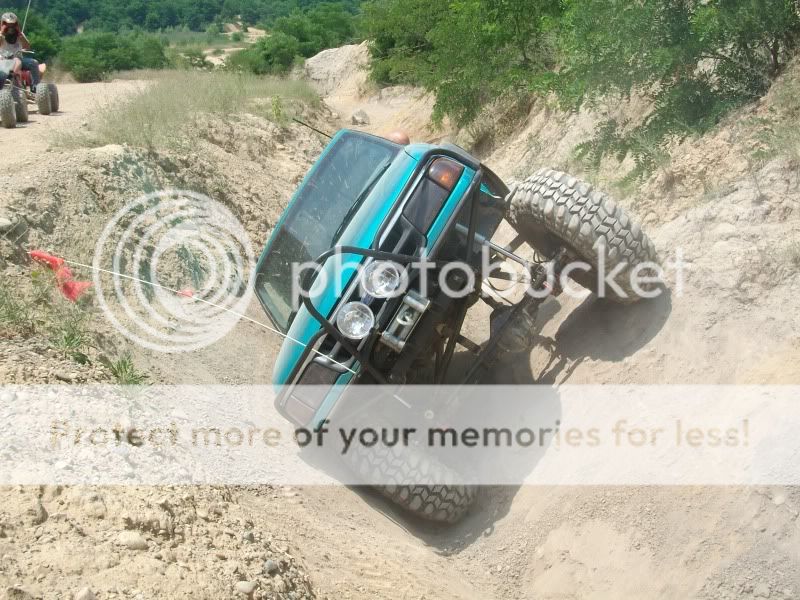

Exactly what happened to me. Killed it going up a hill, no brakes, backward roll, and sideplant. Upgraded my master cylinder and added a check valve and they work great now:icon_thumby:
Kinda scary! When I switch my tons, I will address the brakes, what master did you use?

Wasn't too gracefull lol, I have video. Hope when I go to an auto I can be a little nicer on things lol

if ya steered passenger into the bank you would have righted ya truck back to level.....
looks like ya had fun:icon_thumby:
Got one from an F250 with a rear discs. Used it as a core for a new one. Its pretty much a direct swap for B2s. Rangers use different size fittings.
I don't know how your shit holds together. If I even pointed my truck in that direction it would break half ton stuff. lol you can hear us taking bets on what hes gonna break, and yet the fawker never breaks anything lol.

It was a game yesterday to see how close we could/couldn't get to rolling. We were watching another group ahead of us taking the "safe" lines. So we went against the grain :icon_hornsup:.
