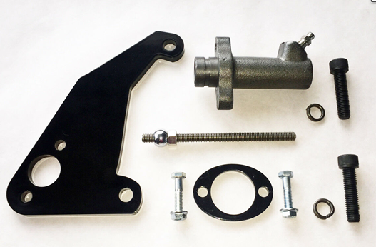

WHAT DO YOU THINK OF THIS KIT? TO CONVERT THE CLUCHT TO HYDRAULIC OF A T5 MUSTANG 94 TRANSMISSION INTO THE 5.0 SWAP ON A RANGER 98

I used modern driveline external set-up, directions suck, but its easy to figure out
I'm using a 99 f550 master and 280z slave.. I do not like how it works. Engagement is to close to the floor
I like mdls kit so far, still had to due 550 master and pedal grinding, switch trim like u did Joe. Engagement feels good to me.
Anyway you could post a video of your clutch engagement in reference to the floor? So you did use the f550 master or?
I'll try for a video soon, yes did 550 master, and trimmed the interlock switch, as well as ground back of peddle. Not sure if it was required, but I did it. Other than being stiffer, it feels like the stock clutch b4 swap
