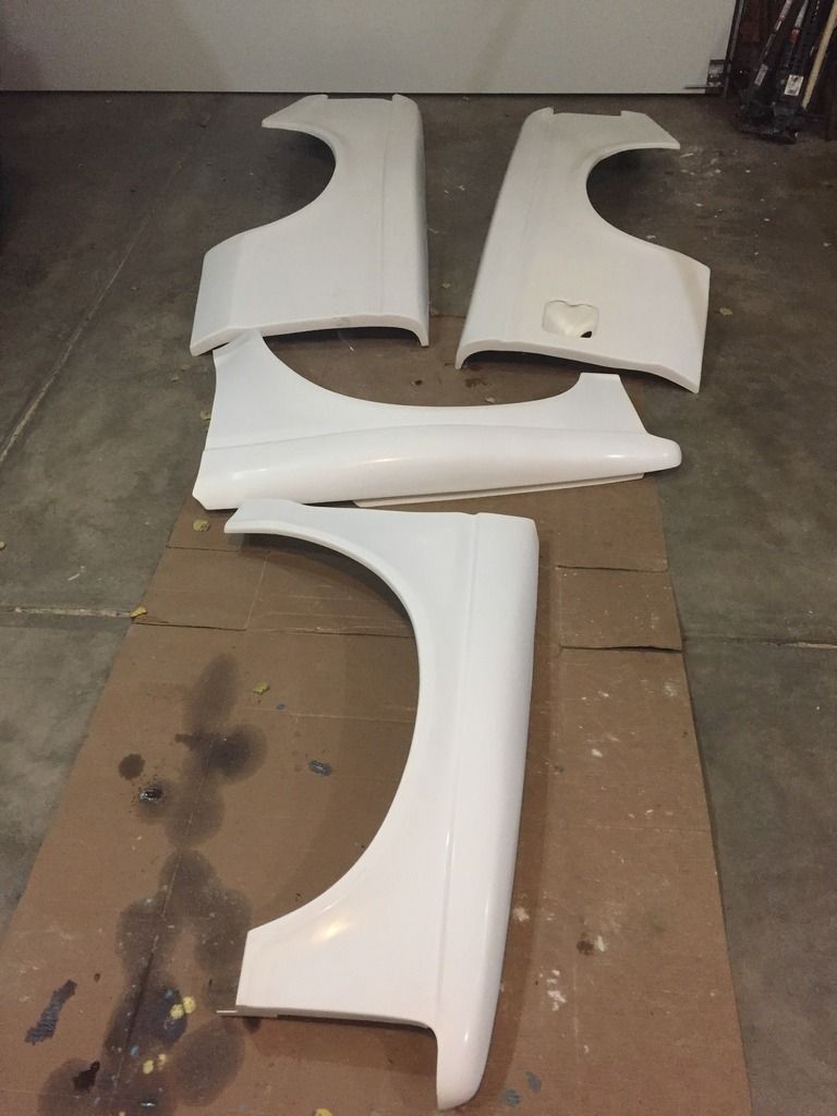

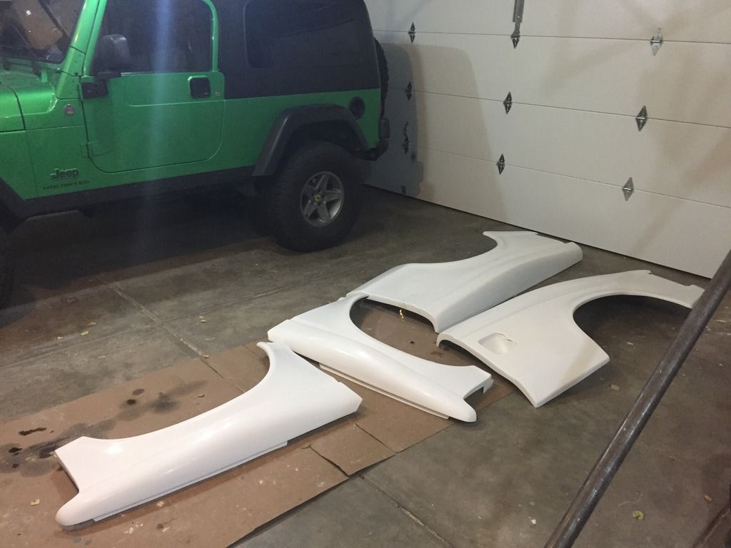

I got a delivery from California a few weeks ago:
Kirbys 1991 Ranger Build Up and Solid Axle Swap

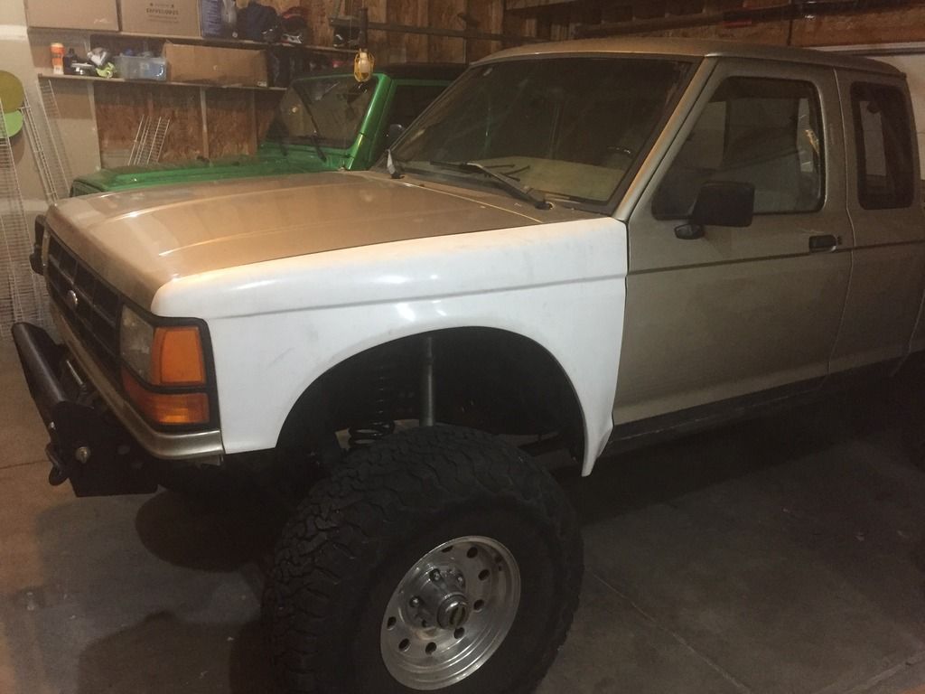

They are from Mcneil- front and rear. I think the fronts are 3" and the rear are 4". I got the fronts on. They didn't fit great, but they fit. I started working on the rears. They need paint. I hope to do that really soon.

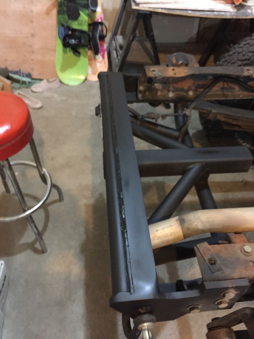

I started on the rear tonight:

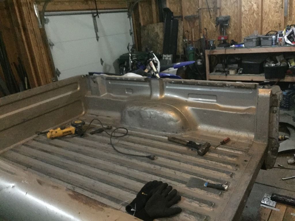

I am going to be running around without a bed for a few days. I am trying to decide how to mount the bedsides. I plan to have the bed rhino lined after paint. Anyone had any thoughts? Maybe big rivets? Maybe grade 8 bolts with washers?
I also want to build some nice hooks and weld them to the stake pockets. I use the bed to haul stuff ALOT. The new besides have no stake pockets. I have to have something to hook up my dirt bike tie downs to, and ratchet straps down when I am hauling stuff.
i would build rail caps and beef the inner with tube that ties it all up if you want to do truck bed stuff still.
^^ now that I think about it, that's a solid suggestion for sure ^^
Those inner bed panels will be easy to warp/bend, especially using tiedowns on the inside without the support of the outer steel bedsides..

Thanks guys. I think I found the solution I am going to go for.
I like that idea Bobby. I was trying to figure out how I can beef them up- I could tie all 3 of the plate together on each side I guess. I don't know if it is necessary- this might hold good enough.

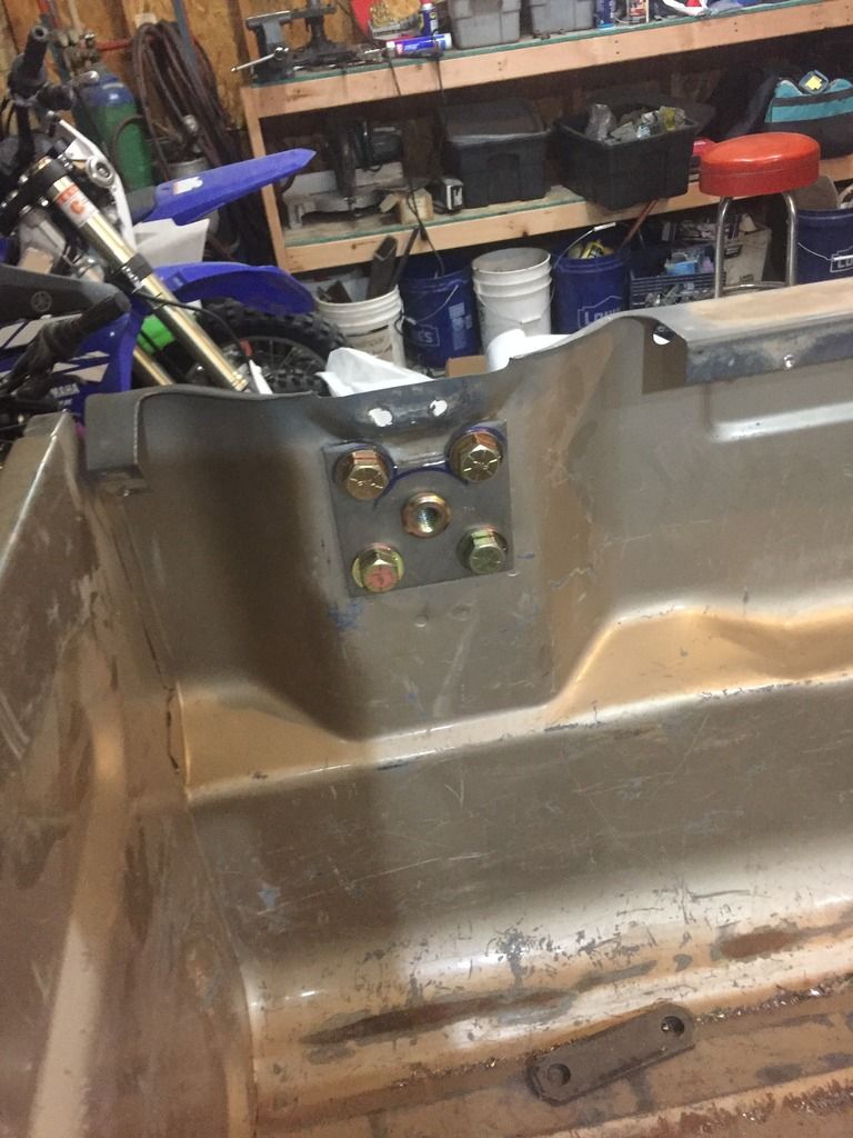

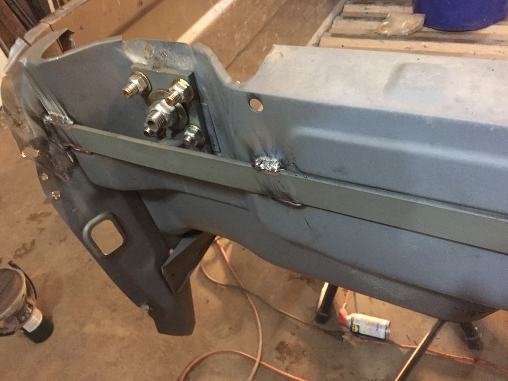

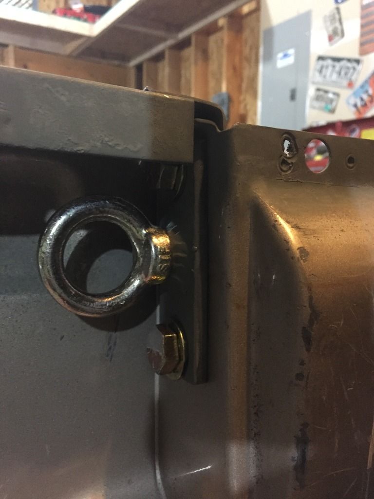

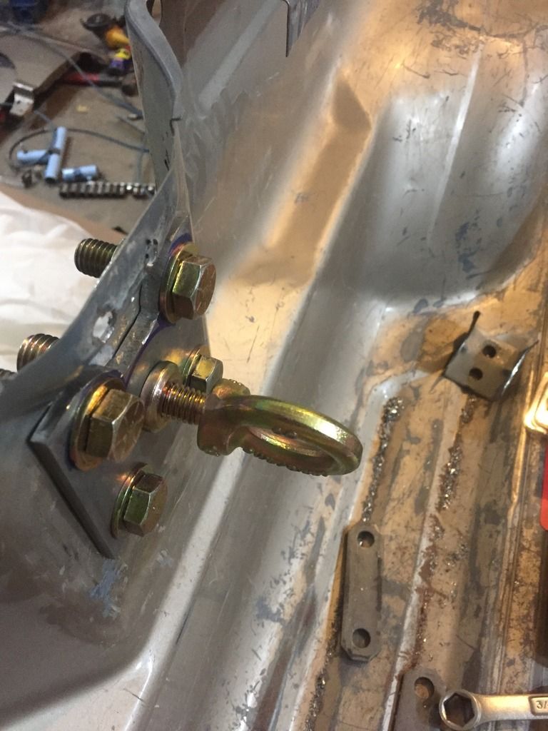

I made some progress and got some pictures. I think I am going to put 6 of these on the bed.
Plates with 4 bolts and washers on the back. The center bolt has a hollow core and a loop screws into it. I will weld that stud to the plate. All grade 8. Then it will be rhino lined over the top.

I like the idea that the loops will come off. When I haul the UTV in the bed, I need every inch of space. So I may need to unscrew them to load that thing.
I am leaning against welding the plate to the bed. I can do it, but I think the bed might crack around the welds. Any thoughts?

It’s hard to see but the backing plates are attached to the strap via 1x1 square tubing. The backing plate for each hook is made of 3/8 plate. The strap is 1.5” wide by 3/16” thick. I welded it in about 12 places.

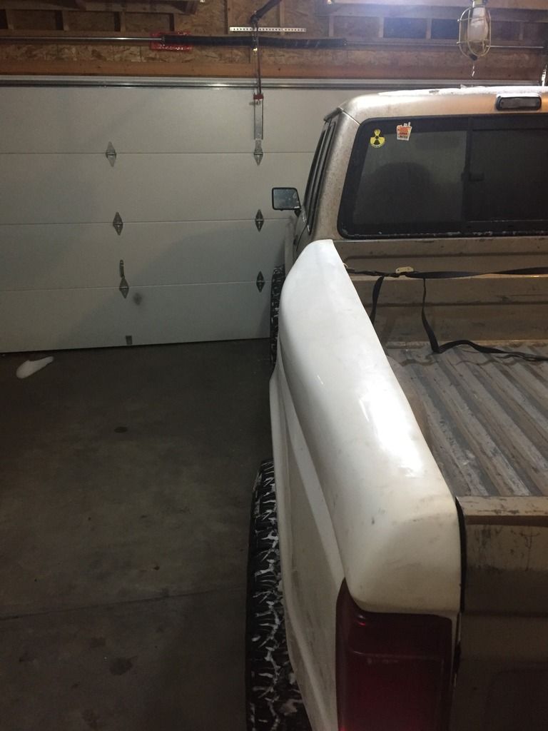

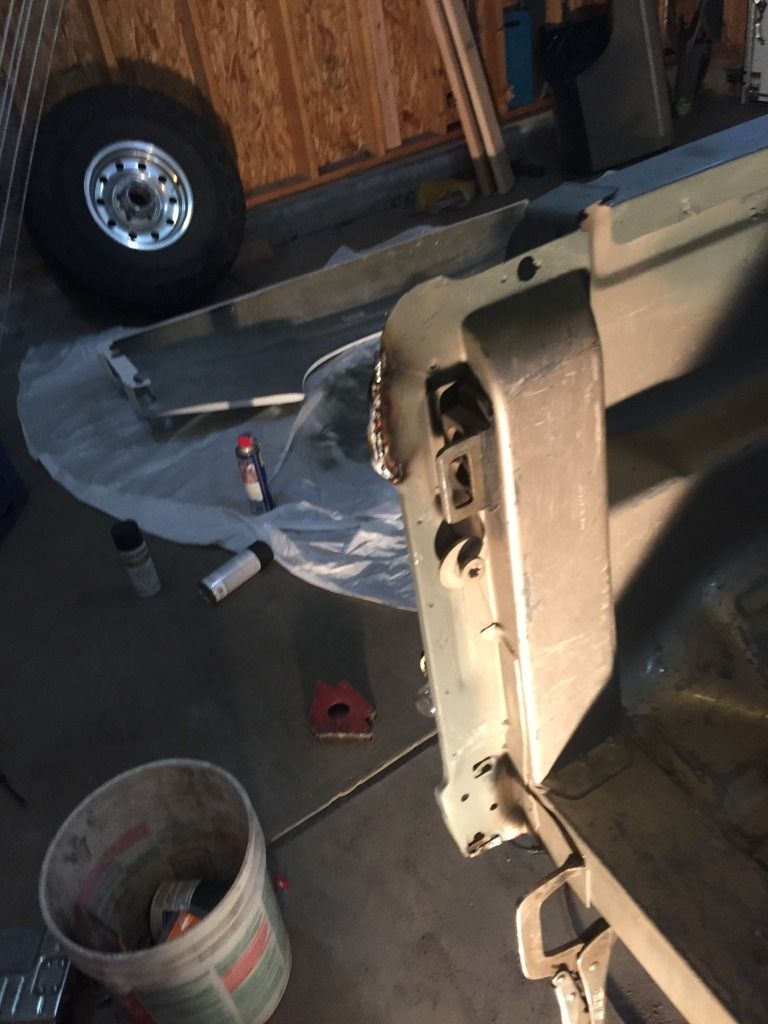

The rear section of the bed gets removed for the bed sides. However, the rear lower corners of the bed get removed and that really weakened the lower corner and the tailgate mounts are there. So I tried my hand at some body work. I made these little braces and spot welded them in.
Then I used some brackets from the front fenders and doubled up on the brace. I did this on both sides.
Then I had to trim the back corner so the bedside would fit on each side. So I tried my hand at cutting out a section and then re welding it back together. I think it turned out good for my first shot at body work. I also had some cracks on the front from where I took out the spot welds. I fixed those up too.

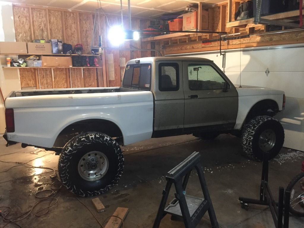

Bed sides are ready to go on now and Ill have to figure out how to mount up the taillights. This was a lot of work. I am considering putting undercoating in the underside of the bed. Also considering making a metal brace between the inner fender and the fender.
I finished up the last of the tie downs. These are thicker sections of the bed frame so I am not going to tie it to the others.

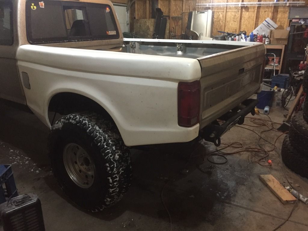

The tail lights fit pretty good. The tail gate not so much. The bed sides are much thicker, so the tailgate fits tighter. My body guy said it was best if I had him order me one instead of getting my own. I trimmed the stock tailgate some- will need to trim the new one too.

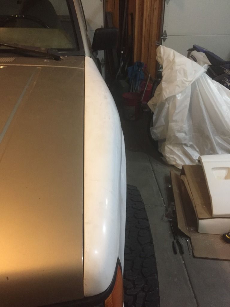

Then I got it mounted up. It looks pretty good- except the drivers side is really close on the from of the rear tire. The other clears fine. I clearance the bumper so I could get the bed as far forward as possible but it wasn't enough. I may have to move the rear axle back. I dont want anymore wheel base, but I don't know what else I can do. The passenger side is fine. I was hoping there would be room for 37s, but without moving the axle there isn't even room for 35s. It needs to go back 1-2".

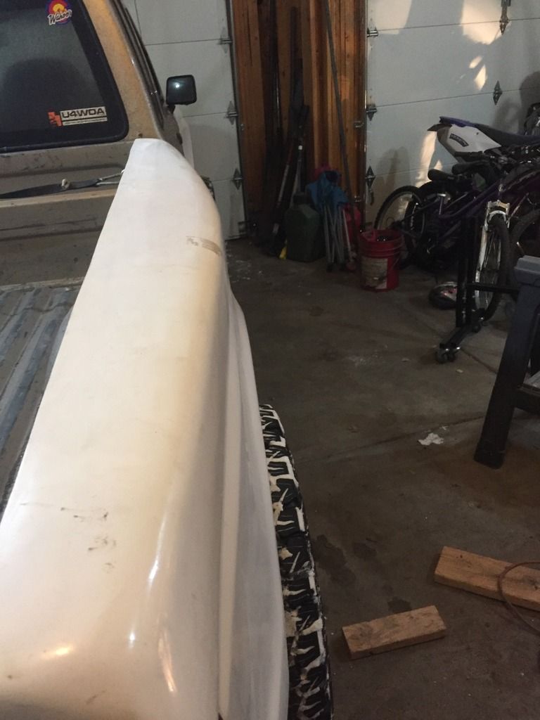

I like the sweeping rear end and the tire coverage a lot. I could have gone wider, but I actually wanted the tires to hang out a little to protect the body still.

i assume your chassis is straight?
if your chassis is straight you should send that bedside back.
looks great, which is the point of formed glass... but that differential in opening is unacceptable...if you wanted cut fenders it would have been easier and extraordinarily cheaper to just use stock cut and pulled sheetmetal.
i generally make due..but this .. not so sure.
I talked to McNeil. Its obvious one side has a wheel well that is about 1" smaller than the other. They said they would make another and send it to me- so waiting for that.

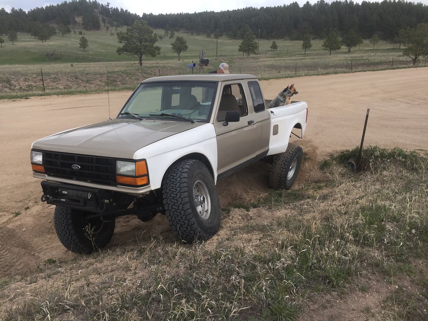

Tried to make a coyote dead last week at my parents place. I didn't succeed, but I did get the ranger stuck a couple times and had to put the winch to work. It was a good time.
Its supposed to snow tonight so I will probably get to get out in it tomorrow.

McNeil refunded me $200 to repair the fender. They have been really cool.

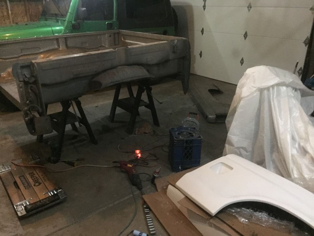

I currently have the bed off to install the new fender

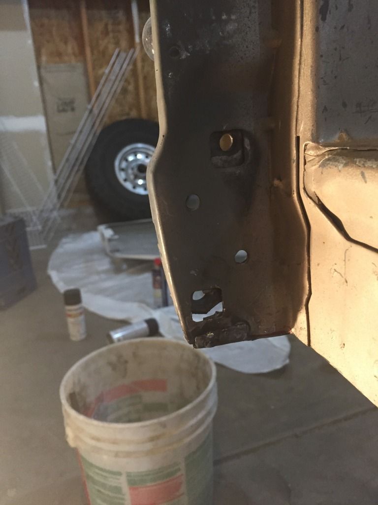

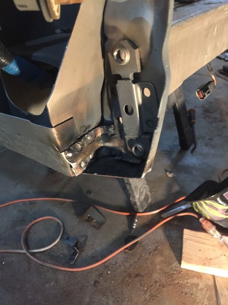

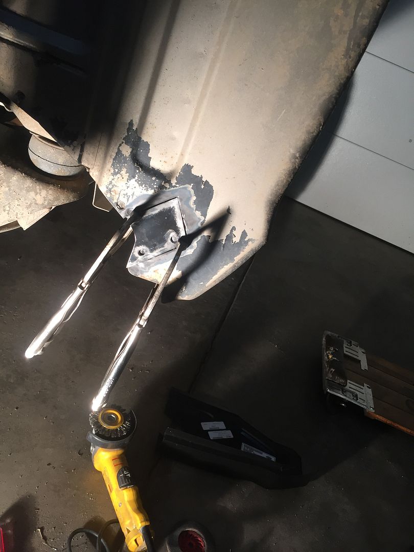

While the bed is off, I fixed some rust in the back corner of the cab.
I have never repaired panels before. I am glad it is in an inconspicuous place.

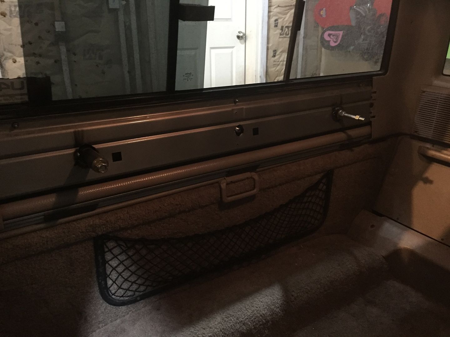

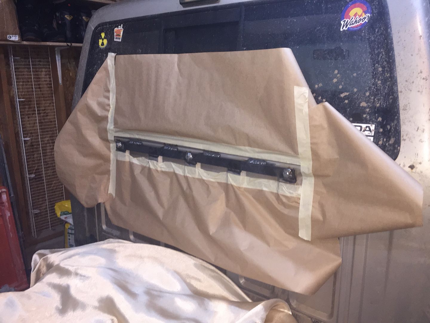

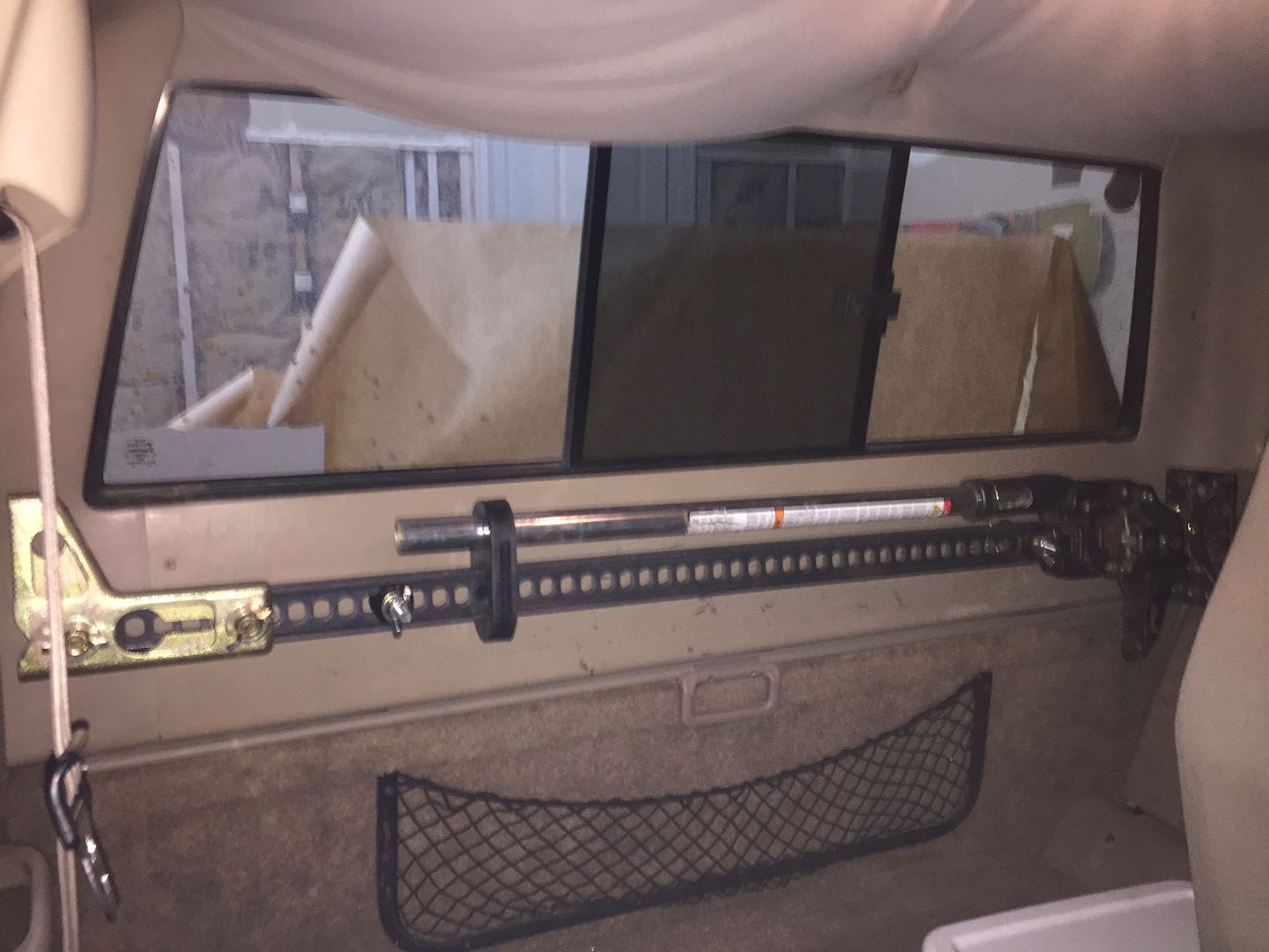

I also made a highlight mount.
It is a piece of 1.5" strap welded to the back of the cab with 3 bolts through the cab.
I also used a piece of 1.25" dom on each stud. I cut a hole the size of the DOM OD in the second inner wall of the cab, then welded that to the inner wall.
Its really stout so I hope it won't ever need anything else. Lastly, I used wing nuts and autofab fender grommet Polyurathane mounts so I can tighten it down and not rattle. It fits tight and utilizes otherwise wasted space. The jump seats can still be used no problem, the jack is a little in the way of the shoulders with them- but they aren't really built for comfort anyway. I can ride back there with it.
