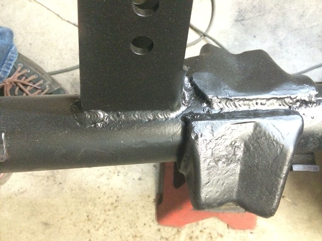

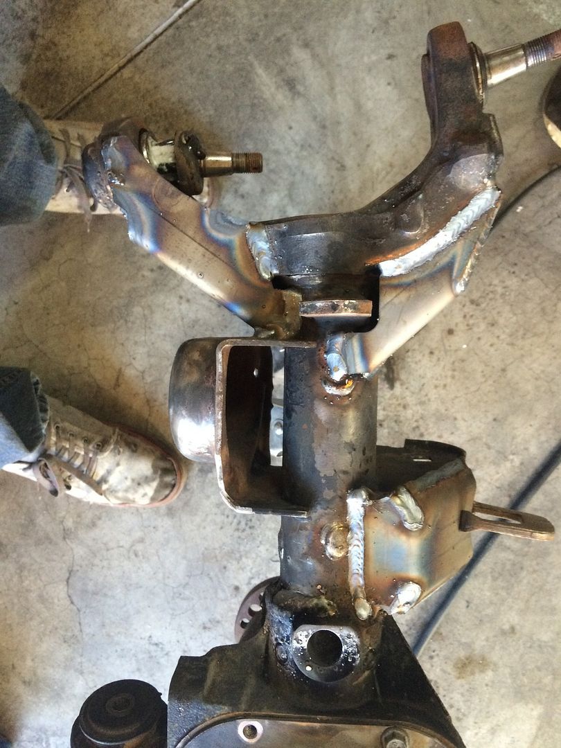

Yes. Lots more. I fell behind on this thread. I ended up going back 3/8" on the axle. That is what I settled on. So it is 1 5/8" forward. I can go back forward with the helm joints if I want.

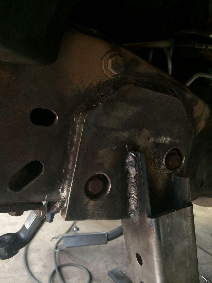

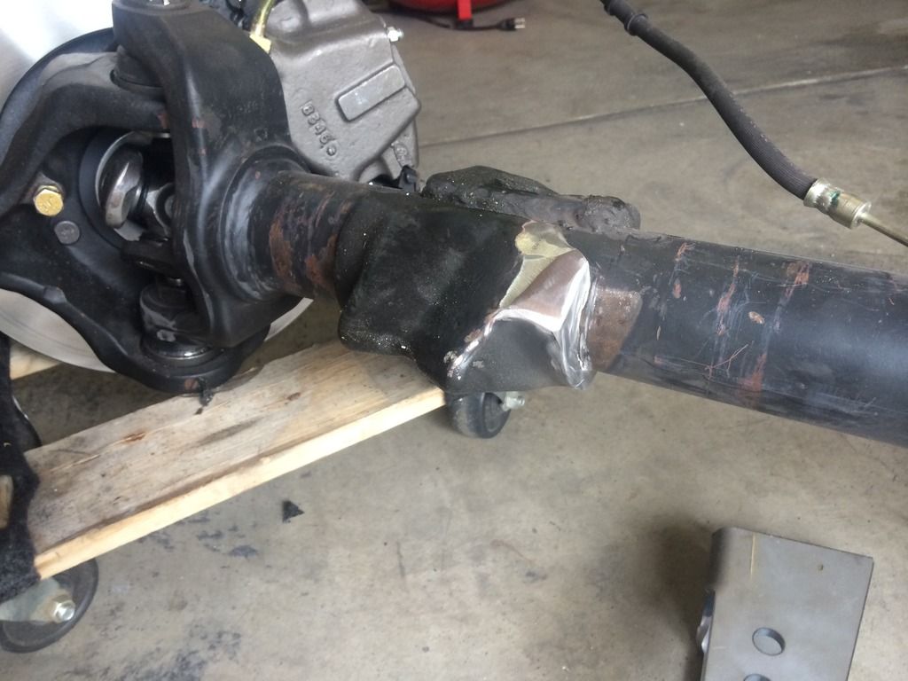

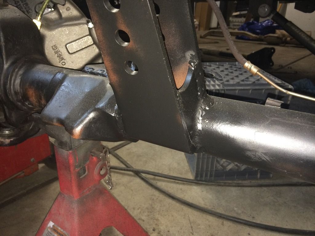

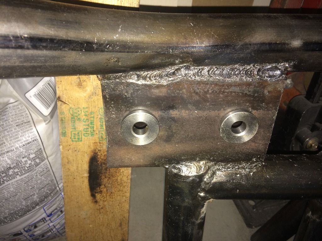

I ended up having to ditch the joints and upper bracket I used. I had to go with a more common 7/8"x14 threads. My machinist didn't have a set of taps to match up with the joints. Getting the taps was more than different joints. I was also able to go with an outside the frame upper bracket for more trackball length and a smaller width bracket to help with the tired clearance. I ended up making contact with the coils once they were in place with the upper trackball bracket so I had to trim it and move the hole up and in.
Here it is all welded in. I hadn't moved the hole yet.

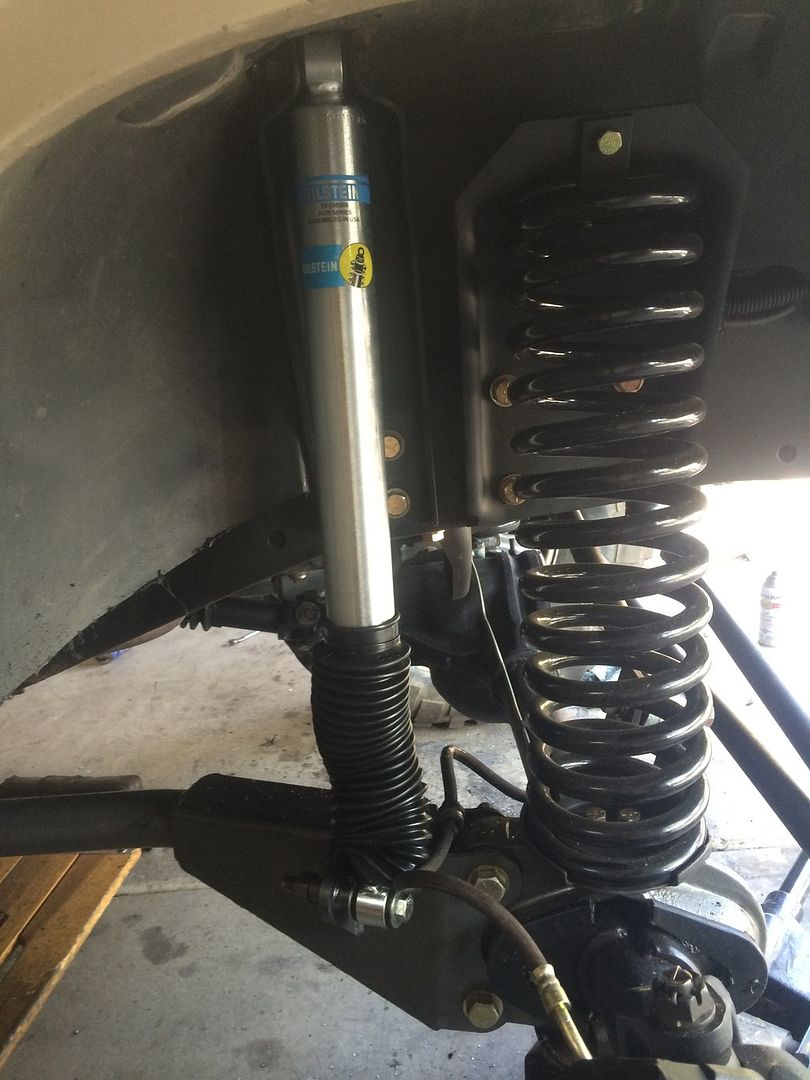

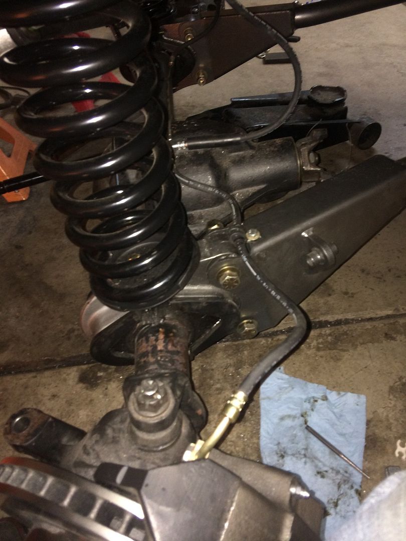

And with the coil bucket
Kirbys 1991 Ranger Build Up and Solid Axle Swap

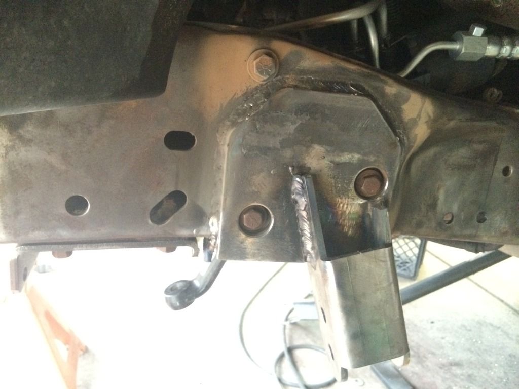

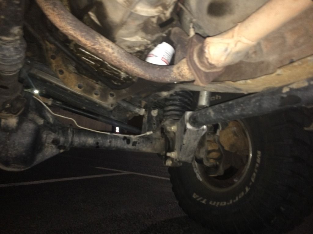

On the lower mount, I ended up slicing off the factory lower mount. It got me an extra inch of tracbar and it seemed to wear the c bushings in that spot on my buddies bronco.

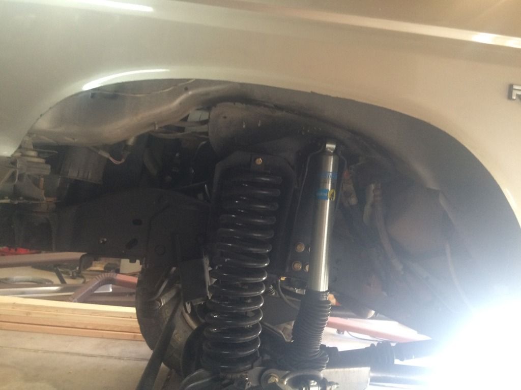

Coil to upper clearance:

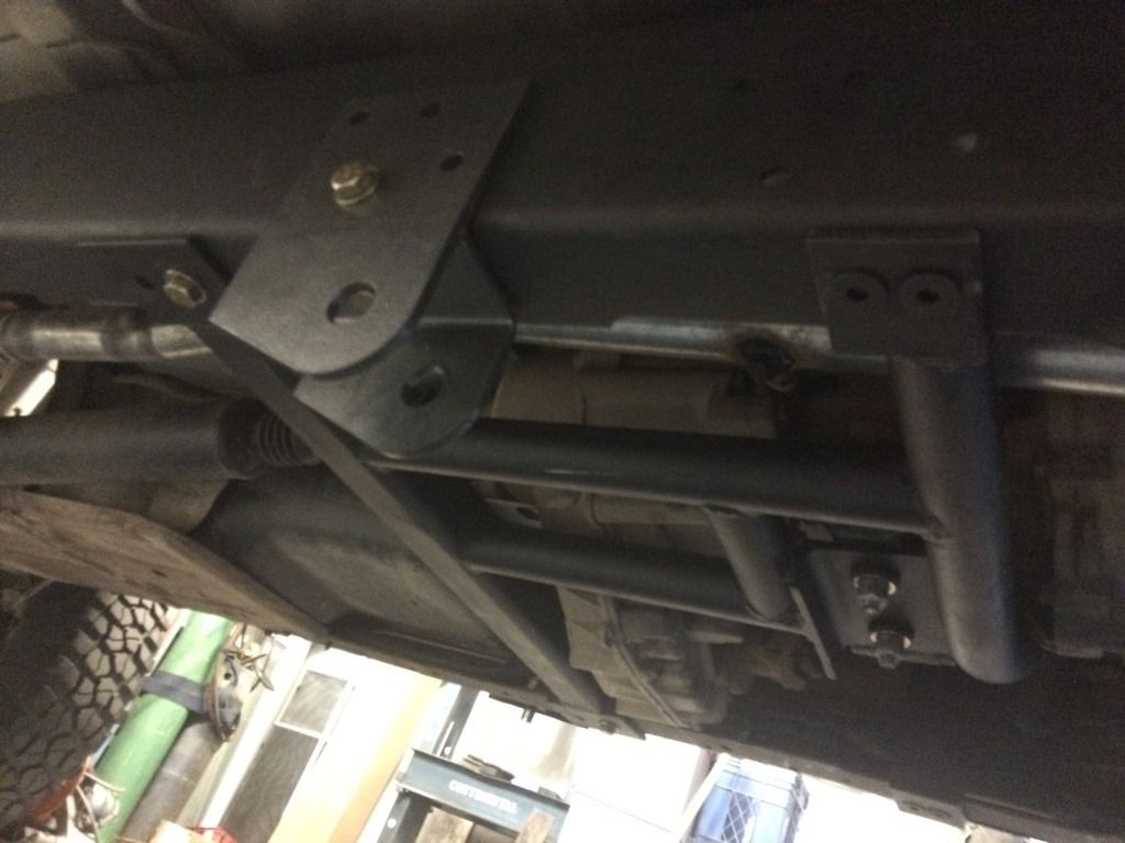

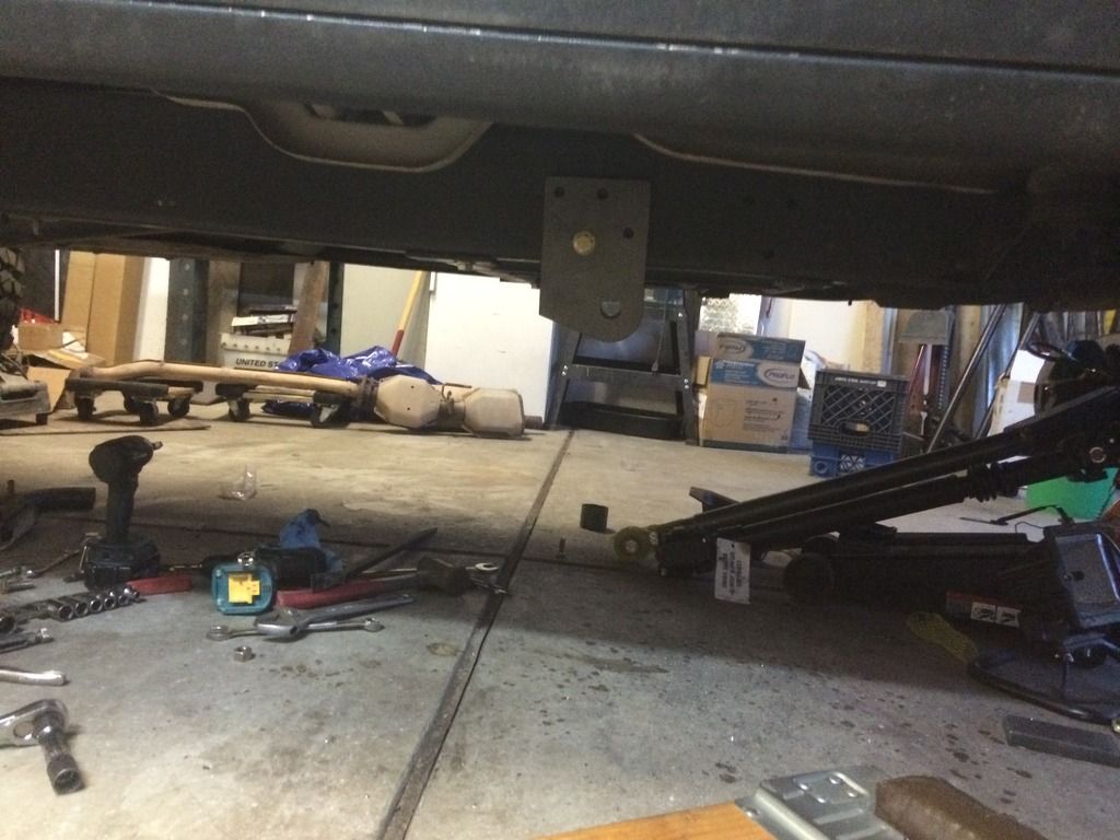

I had to trim the crossmember significantly so the track bar would clear. I reinforced it with a 1/4" piece of steel. I drilled some holes in it, and drilled some holes in the back lip and enlarged others. For Speed. LOL.

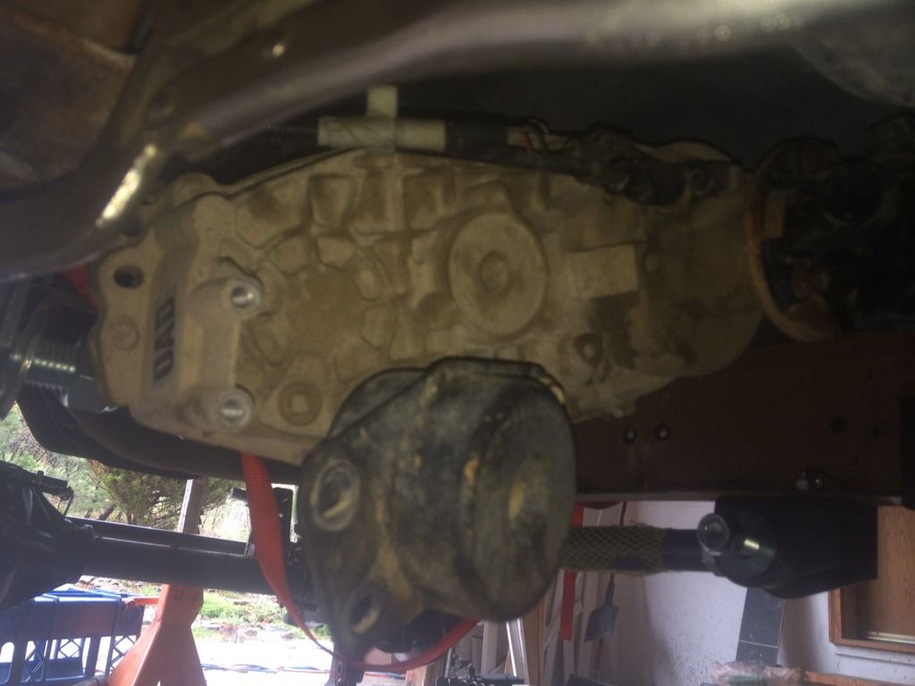

I had to build a crossmember for the tranny. IT was quite the process. I got my friend Matt to build me a poly bushing for the tranny on his plasma table.
I started by making some room
After much fitting and cutting and grinding this is what I came up with. The holes in the center are huge, but I added spacers to knock them back to 1/2" so they fit the bushing bolts tight.
From ballistic
This allows me to stab them loose, then add the spacers and everything is tight.

The front bolts are countersunk to clear the radius arms on compression.
Pretty flat belly, but not completely. (those radius arm mounts sure hang low). I may add a tcase skid later.

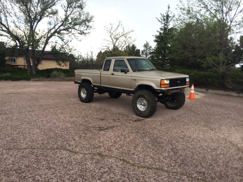

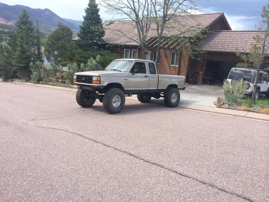

first day out of the garage
It had a little death wobble, which I believe is the rebuilt steering gear box I bought from ford. It seems to have play in the sector shaft. It has a warranty, but I am bummed to have to swap it.

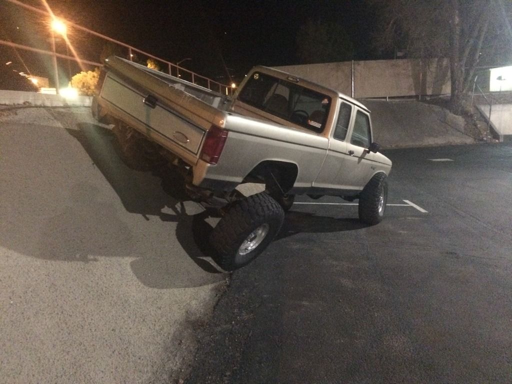

Cycled the suspension.

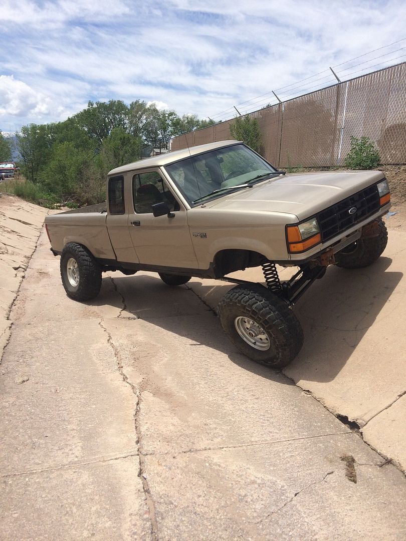

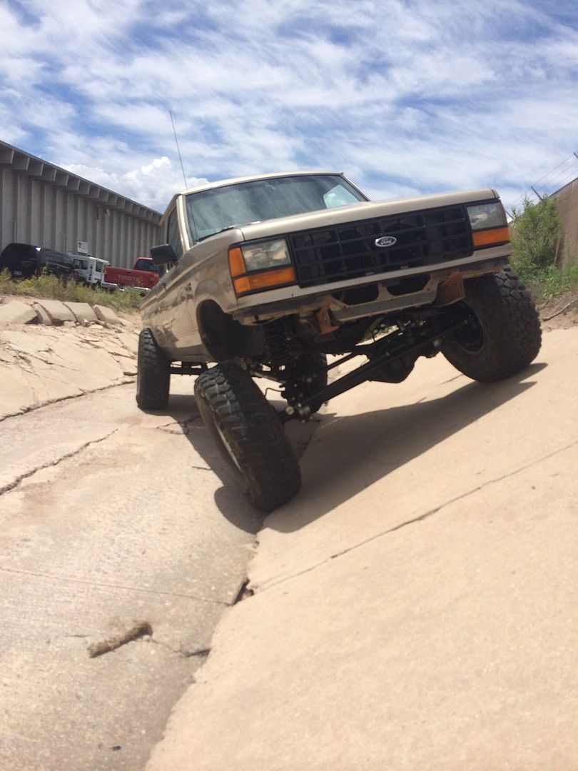

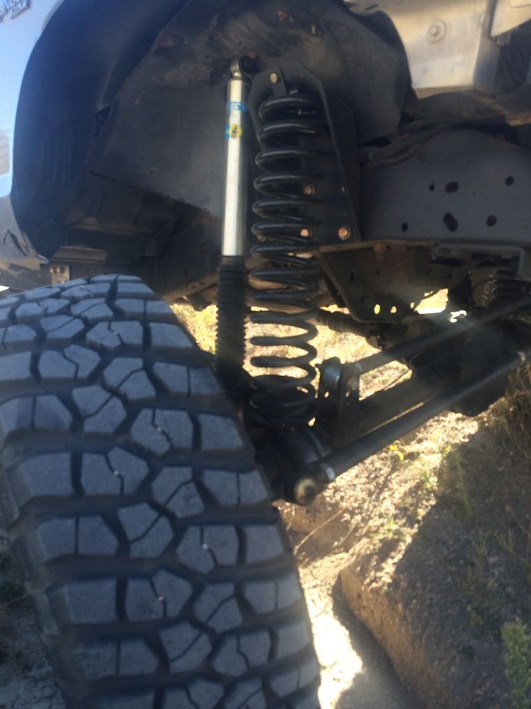

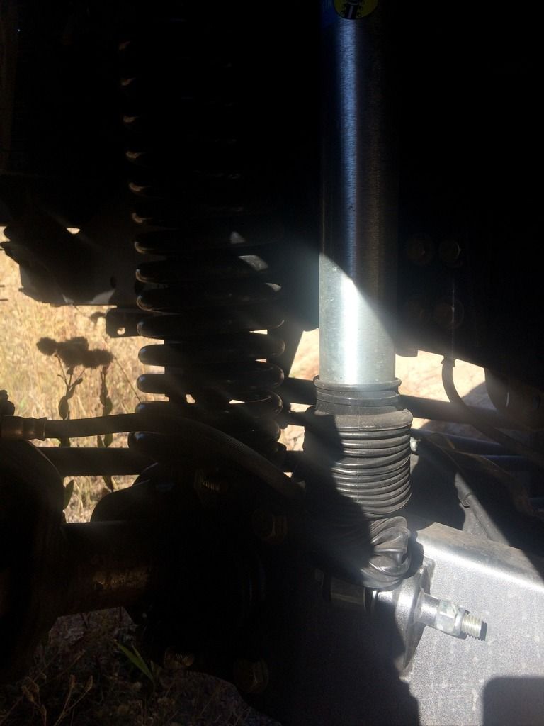

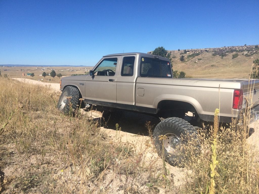

Lots of droop, up travel is nice until the tires hit the outside lip of the fenders. IDK what the solution is. Maybe hack them? Maybe bushwhackers. Maybe a set of fiberglass fenders.
I added shocks to the front too. They are the same part number as the rears. A little more toe in and 24 lbs in the tires and the death wobble got better. It is still there (just barely), so I think I will still swap the gear box.
I needed to rotate my tires, so I bit the bullet and trimmed the front fenders. My poor, straight unmolested ranger's body is now pretty cut up.

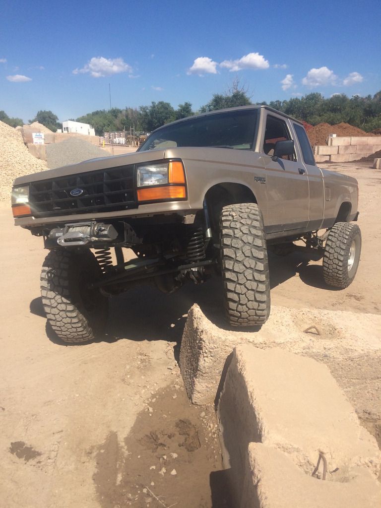

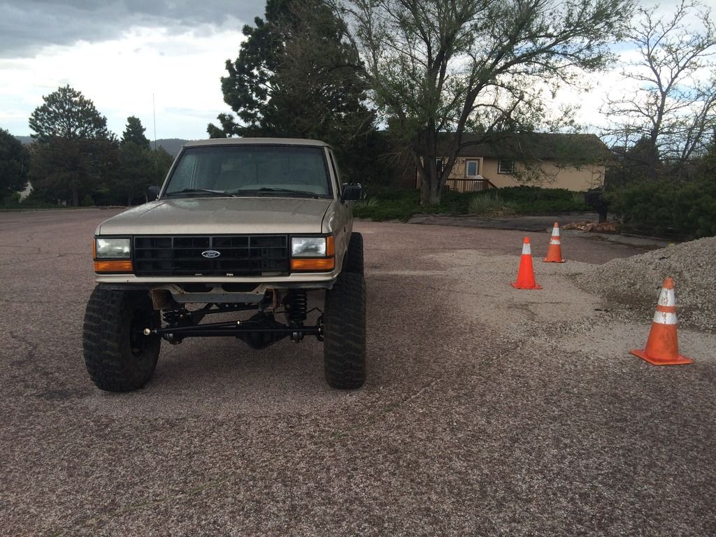

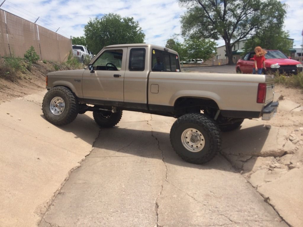

I needed a spot to see if I cut enough. I had to go get a load of mulch, so I tried at the rock yard.
It wasn't enough. So I took it out to my dads to stretch its legs
That was as far as I could go. The rear hits too hard to go further. I still had an inch or two at the shock there, probably not as much at the spring. I had a little on the radius arm before it hit frame too. And an inch or so at the fender.

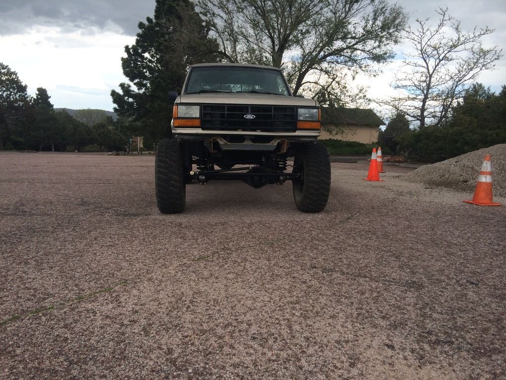

Great droop with nothing binding.
Its quieter than my explorer when it cycles. My explorer springs would pop and bang some. It definitely sways more in corners.
Overall, I am really stoked with the suspension. I am excited to get the rear done so I can really push the front to the limit. Its funny, it was done months ago, but I am just now getting to cycle the suspension completely.

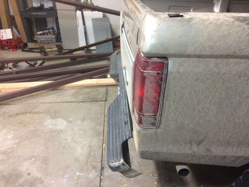

I needed to haul a my uncles 8n Ford Tractor and trailer for a hay ride for a trunk or treat tomorrow. So I hooked it up to my ranger. I wasn't sure the bumper hitch could handle it. But seemed to pull it really well with the 1/2 ton springs and 5.13 gears. I was pretty surprised. Then I hit the brakes pretty hard going down hill. The bumper hitch won't handle it.
So I removed it with the hot wrench.

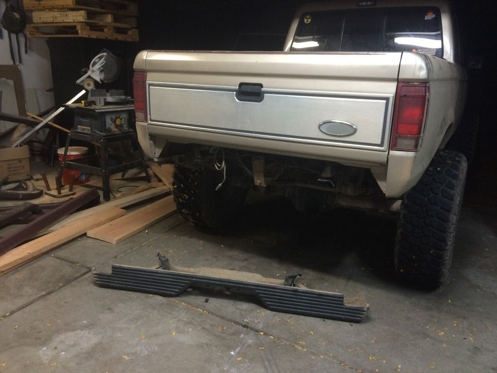

I guess I need to figure out a plan for a rear bumper sooner than I thought. Does anyone have a favorite rear bumper design? I need some inspiration.

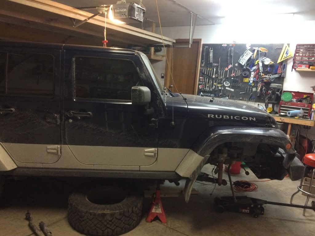

I have been busy. I sleeved and gusseted my buddies '13 jkr front axle. That was a fun project.

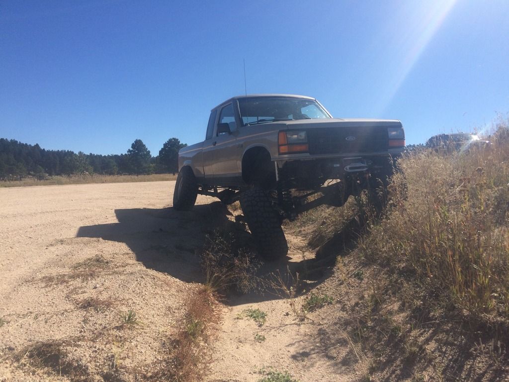

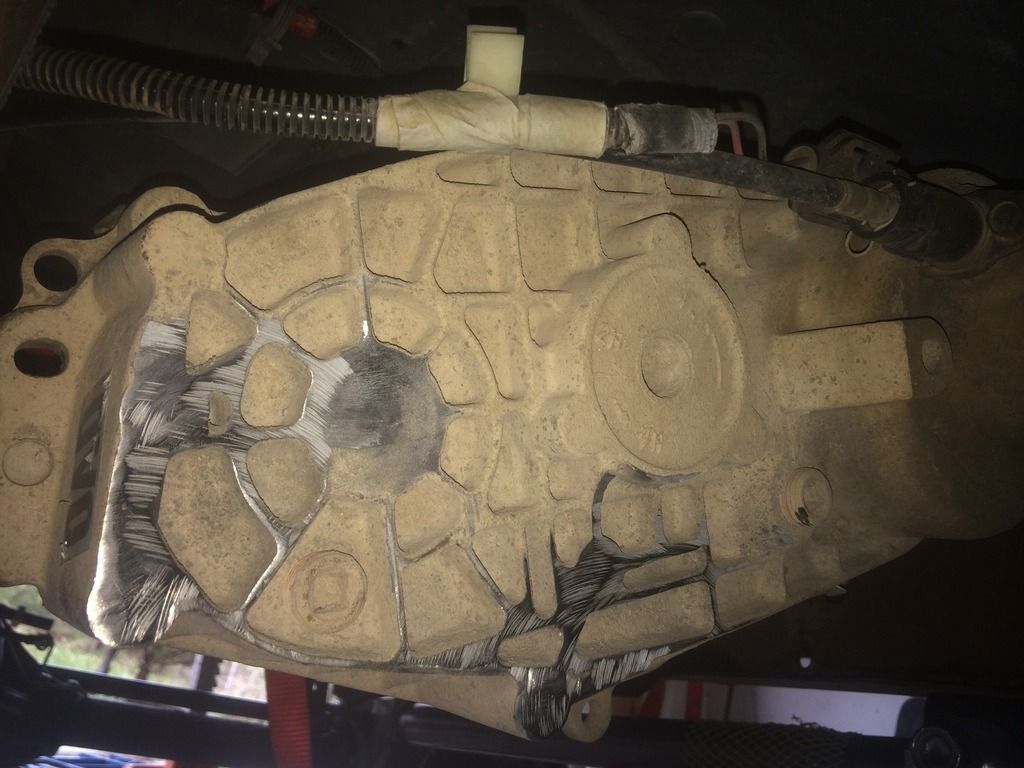

I got the ranger out and stretched its legs last night. The driveshaft is still making contact on the gas tank skid, but further back. I modded it further back and now it is barely touching the front on full articulation. I need to deal with that again I guess.
Pics of the stretching

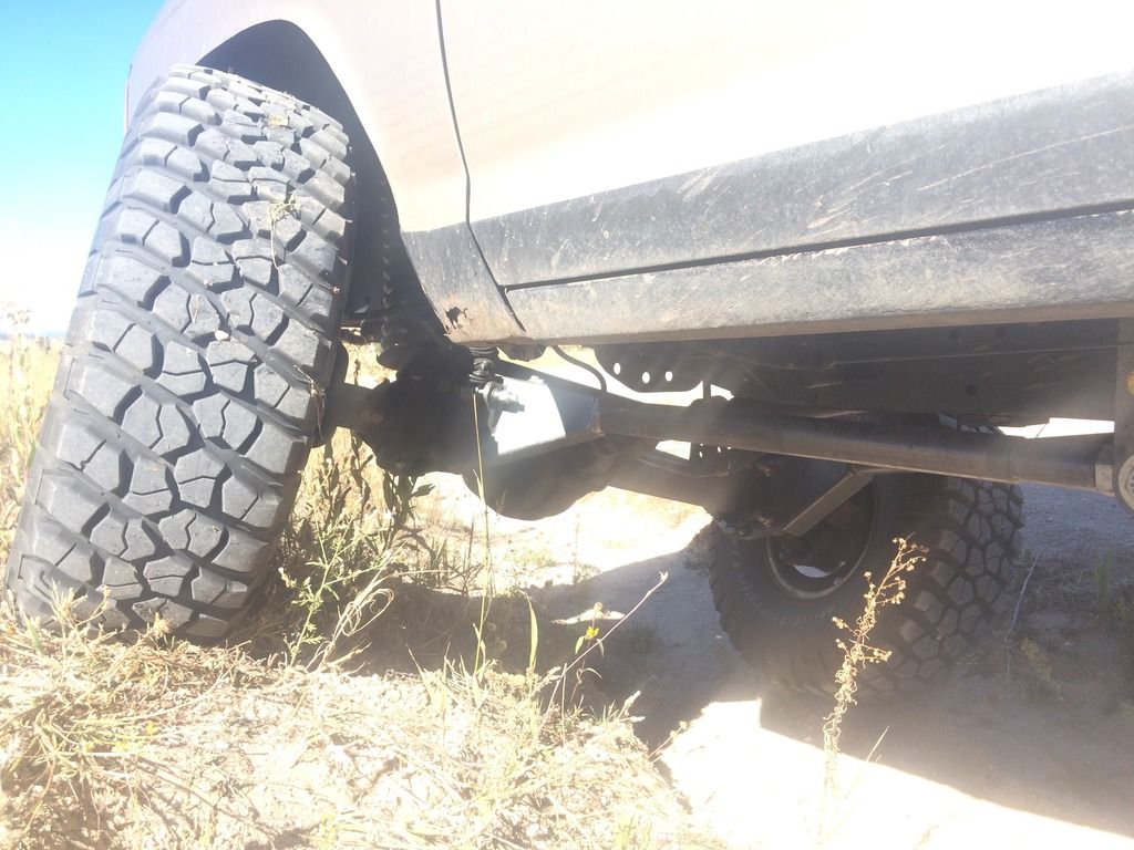

Front at full stuff:
That is pretty much all the front shocks have. The front definitely has more travel and travels with less effort then the rear. However, I am really happy with the travel on the rear. It actually travels even with the very light rear end. I got it to lift a rear tire. I have yet to lift a front.

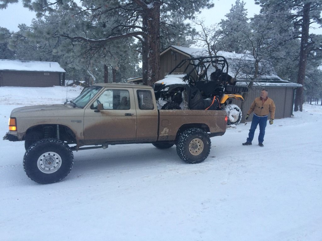

Speaking of atvs, I borrowed my moms Honda pioneer sxs this weekend for youth camp. The golf carts wasn't going to cut it in the blizzard that was forecasted. It barely fit in the ranger, but it fit!
My pops and my dog thought it fit.

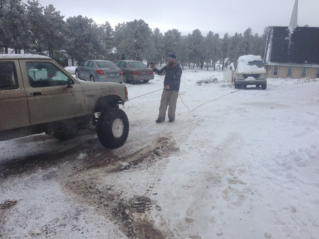

I used my winch about 15 times this weekend. I pulled people in everything from a Mercedes to a Nissan Leaf.
It was a blast. And my winch mount held up ok in current form.
The toughest pull was this:
1 ton van loaded up with all our sound gear pulling a little enclosed trailer. I had to pull it all the way up a hill.
This is when it was almost out and at the top- my winch was spooling up too thick on one side so I am spooling it out a little and I'll keep pulling.
It kept pulling my truck across the road, so I had to anchor it up.
Good times! I would have anchored with a chain but I left my other one in the jeep so my 30k strap worked ok.

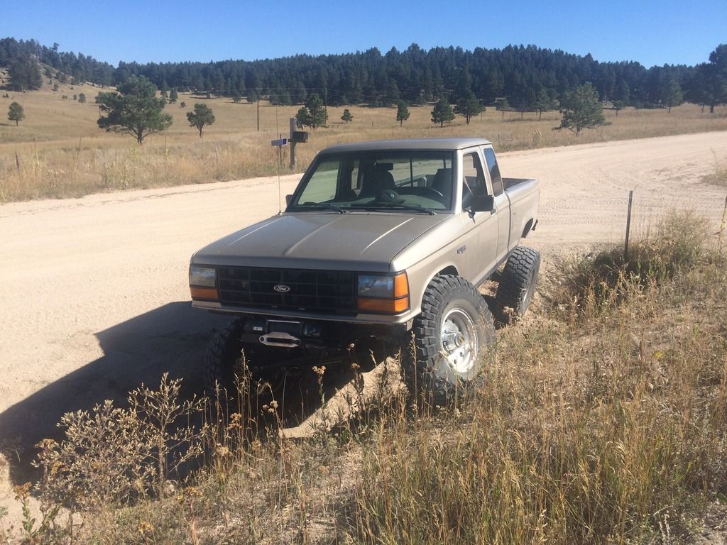

I am still driving the ranger everyday. It’s got 256,000 miles on it now. I recently got some cool parts for it:

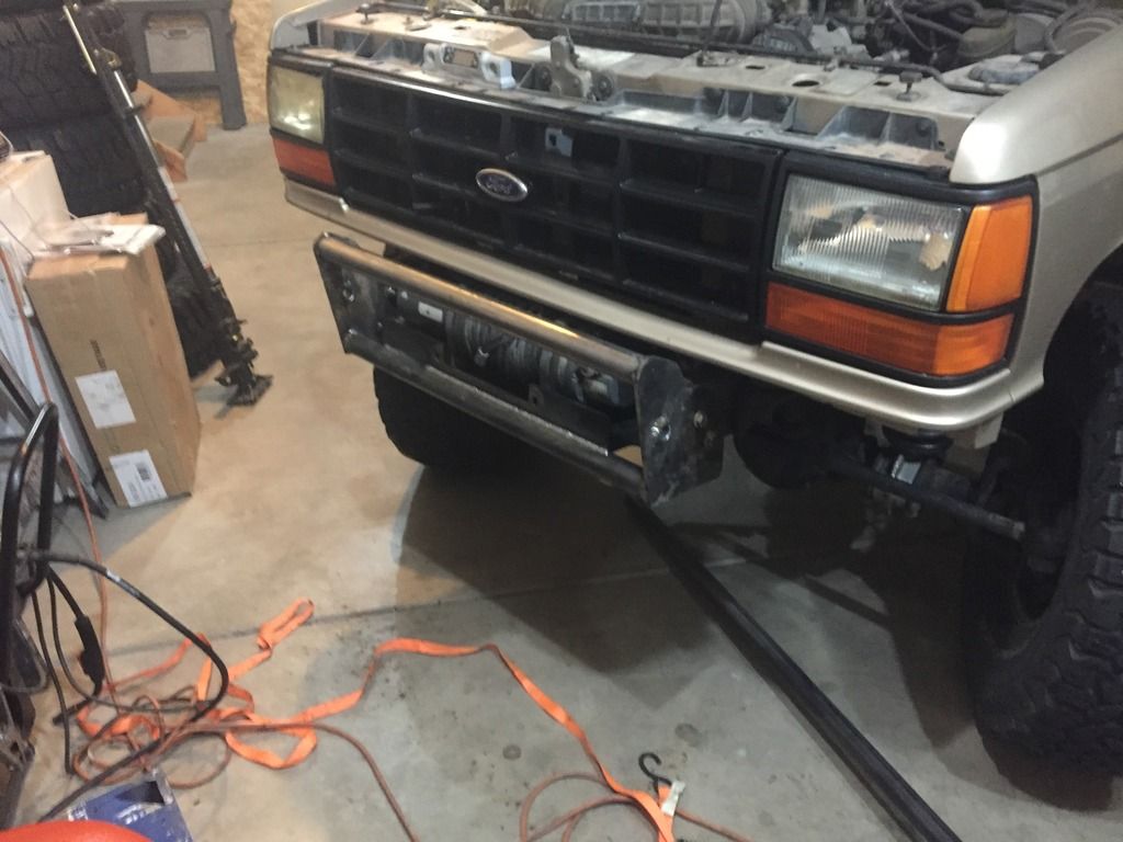

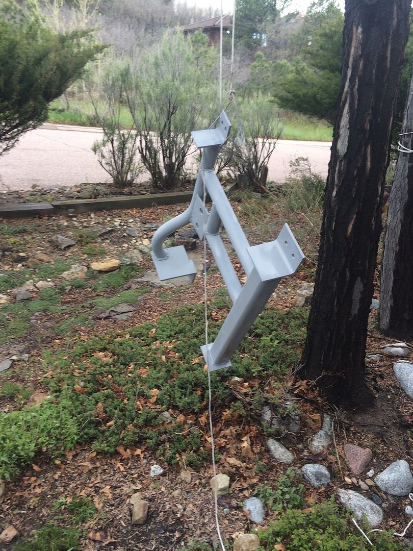

And I also built the main part of bumpers for it front and rear. The front holdsthe winch high and tight. The rear has a receiver and is super thick so I don’t have to worry about tearing it off like I did the stocker:
