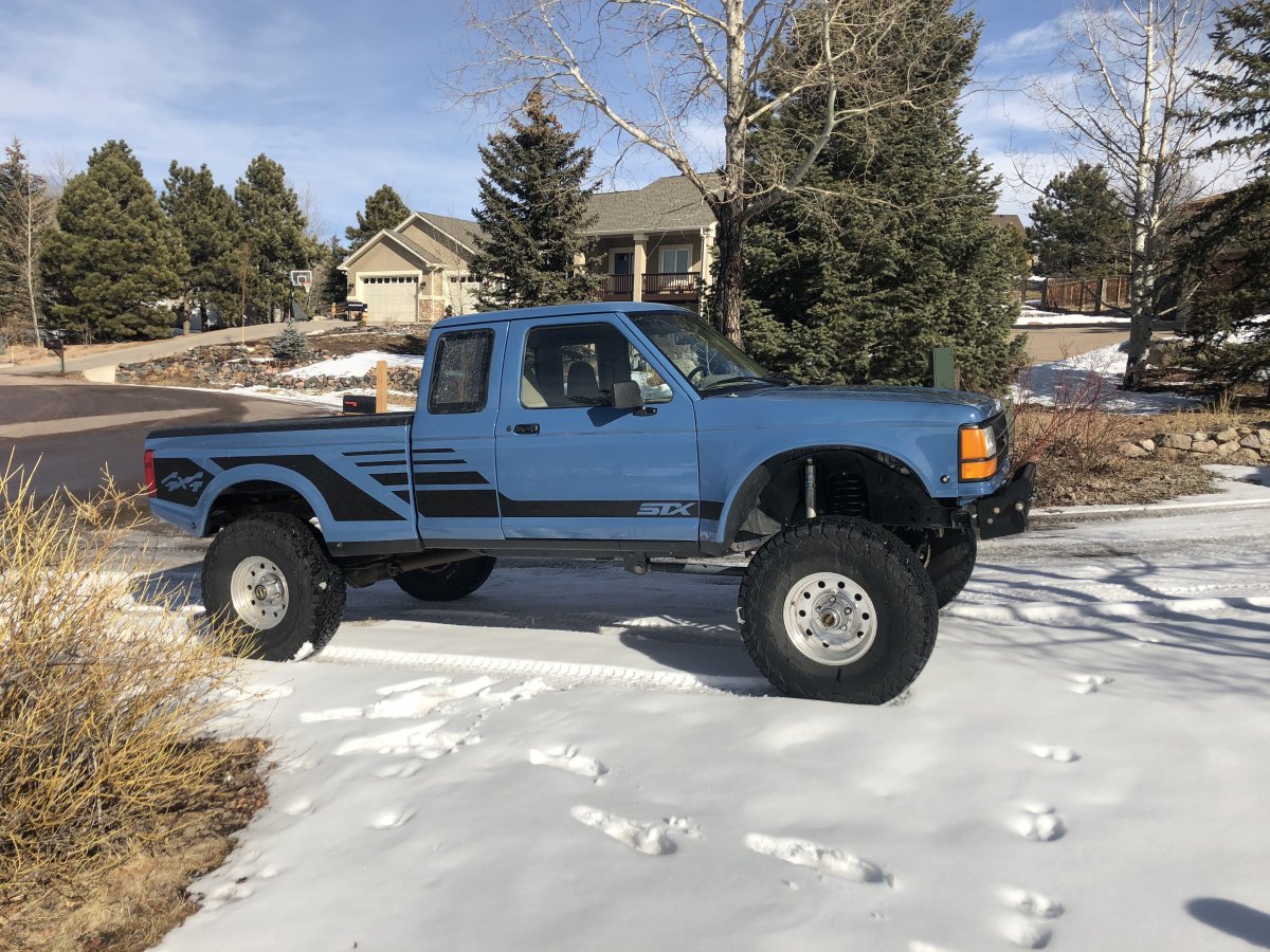

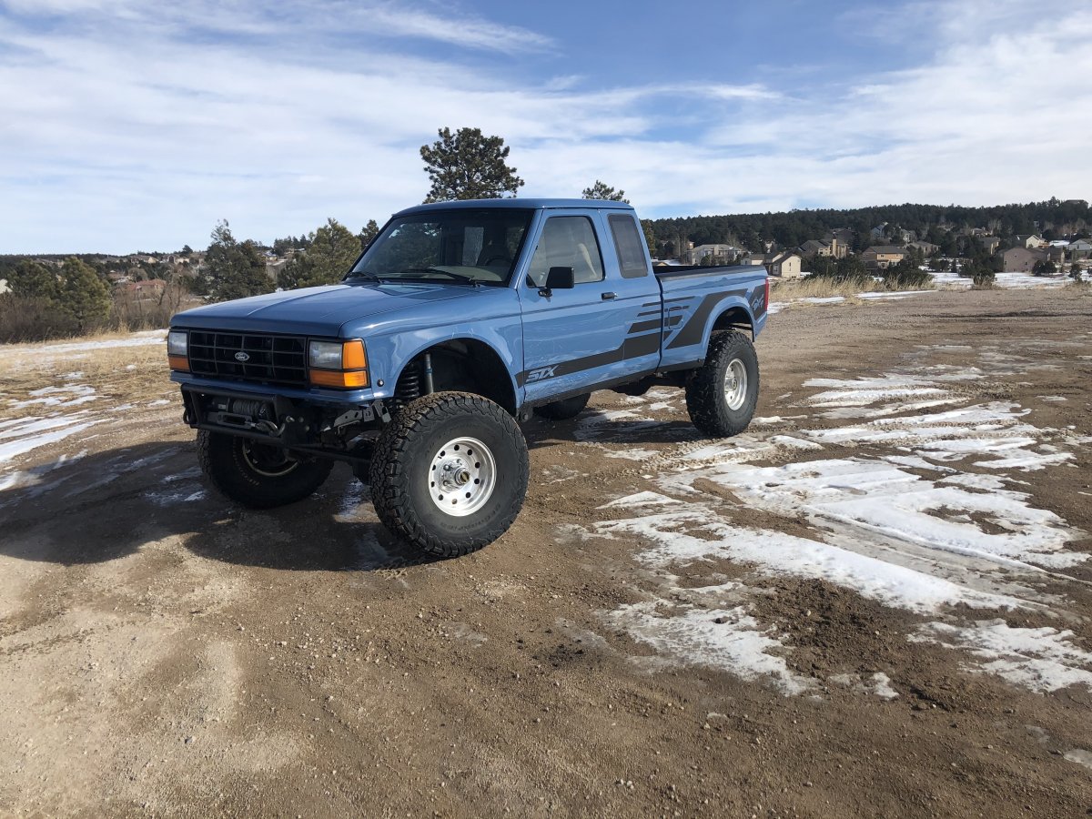

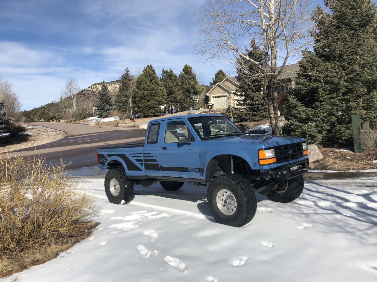

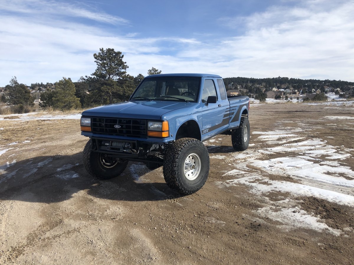

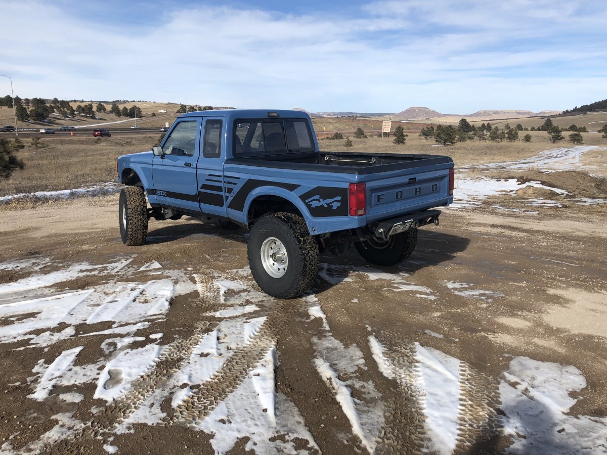

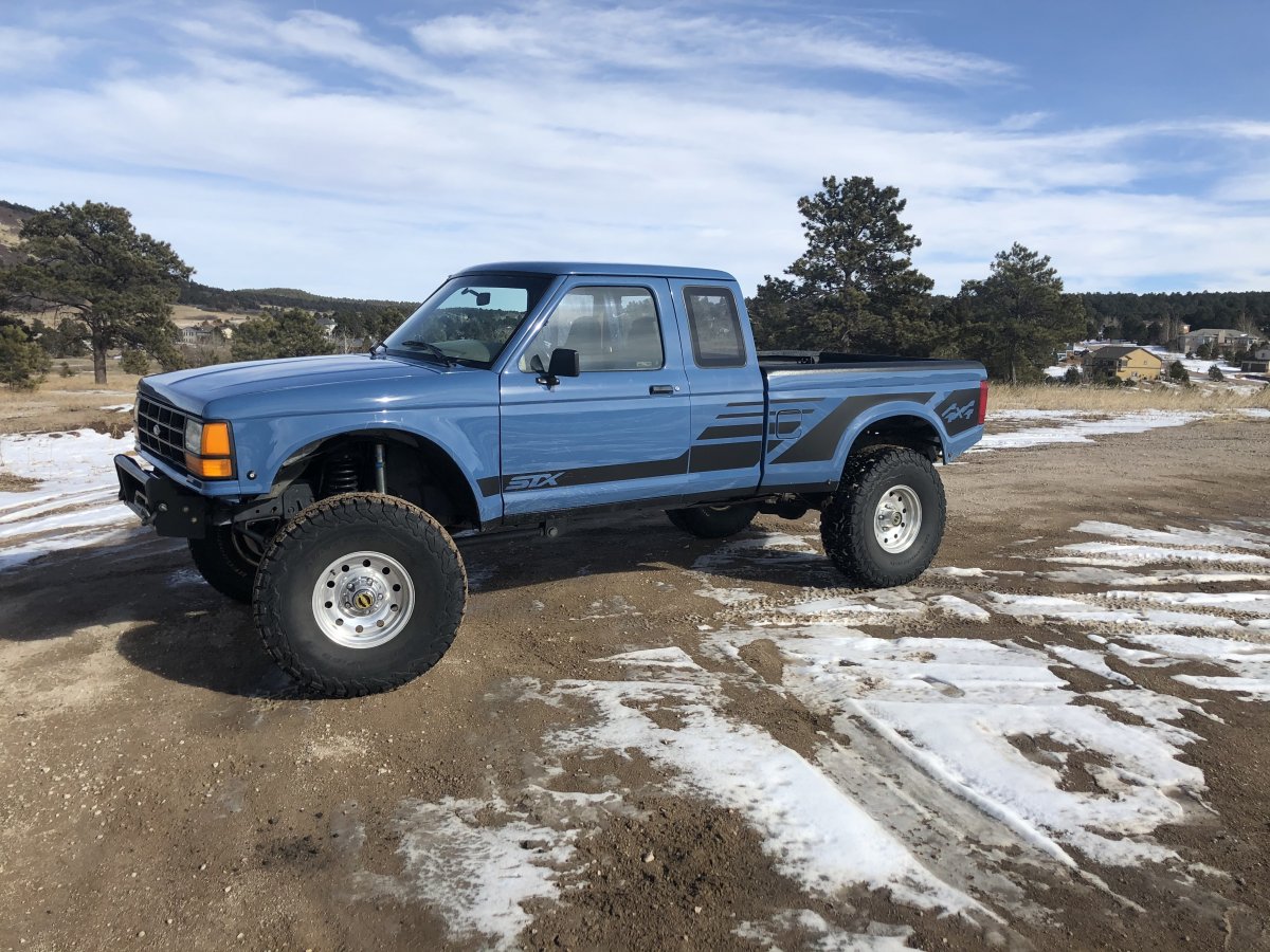

I got the STX sticker set mounted up today. I order it custom from graphics express in flat black before it was painted. Its been a long time coming, but I am really happy about it.
One of my best friends has a sticker wrap and graphics company. I was going to do the install myself, but after i did the tailgate I decided I better ask for help. It was a good idea too- they took all morning and were complicated. We had to reshape and cut out the fender holes on the back. The gas take lid required some ad libbing too. I think it is ready for some wax or ceramic coating next. on to the pics:
My wife says it looks like the 90s and she hates it. I am really happy with it.
Beautiful truck! It would too nice for me to wheel though, I'd be scared of scratching it. My wife would love it though as it's clean and pretty...ain't nothing I got is either clean OR pretty! LOL!
(might be due to my "when in doubt, throttle out" mentality)
I think it looks great. I think it was a good call having pros do the stickers. Tailgate lettering is one thing. Big stickers on curved body panels is another.
Thank you. It certainly makes me think twice before I do obstacles that might cause damage or scratch it. Right now anyway. It needs a good set of sliders and the bumpers finished to keep it safe.
Yeah my friend was happy to help and I was his gopher- so it worked out well.
DAMN THAT LOOKS NICE!!
Oh wow that looks awesome! Good job man. I love it.
I feel like this needs a little theme music......​

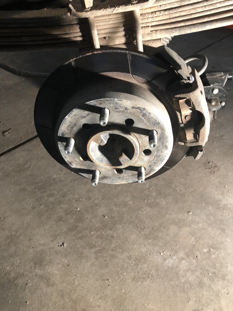

I have been working on building a new rear axle for the ranger. The old one is a little bent (probably from hauling a heavy tractor or from putting 2400 lbs of rock in the bed) and I never really liked how the disk brake conversion ended up. It is a full width 31 spline 8.8. Lots of strength. And I did an explorer disk brake swap on it. You can read through the thread, but the disk swap was a little hokey. I had to chop down the backing plate, lots of machining on axle shafts and on the rotors. Here she is in the garage after a bunch of miles:

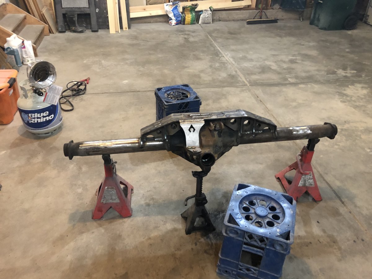

So I got a truss from artec and new spring mounts and shocks welded on the new housing and almost ready for paint:
I like this truss because it bolts to the pinion. I drilled the holes out to 1/2" because I run a butt load of 1/2" grade 8 stuff on the ranger- and it is always nice for consistency.

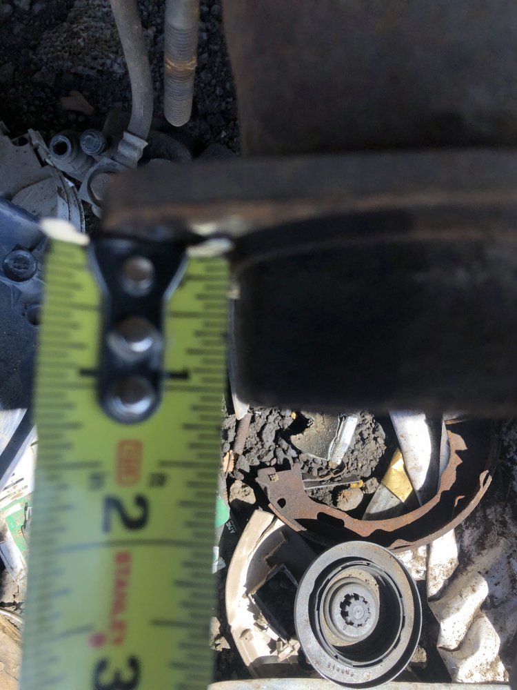

Next I did a ton of measuring to try to figure out what I could do to make the brakes work better. Originally, I wanted to keep the custom machined stuff to only the rotors- that way if the shafts were stock I could always find a stock one to replace one I broke. So they have a ton of machining on the rotors. Well unfortunately I ended up having to do some machining on the shafts too. So now they are both custom, and I still had a good amount of clearance problems with the dust shield and the e-brakes. I have been thinking about this a while- and I think the explorers have more axle shaft hanging out of the housing then the broncos and f150s do.
The bearing ends are the same.
Turns out after a bunch of measuring and comparing at the local pick and pull- the explorers- in relation to the housings- have 3/16" longer shafts than the full width axles- making for a ton of extra room for the disk brakes.
I decided to order up a set of Moser Shafts. They are Chromolly and claim 30% strength increase over stock. I can also order all the specs I want to make them play really nice with the explorer brakes. And the only thing that will need to be customized on the rotors is the bolt pattern. Easy enough to do or to have my buddy at the machine shop do. I choose the later. I actually like this setup better because rotors wear- they need turned. My current set needed turned and were out of spec for an explorer- but since they were custom they let me go ahead and turn them. With these shafts and the lack of weight in the rear of the ranger most of the time I dont think I will ever have a broken custom shaft to worry about. Here are the specs of she shafts I ordered in case you dont want to fight the brakes and want it to work right too. This includes 3/16" longer shafts, smaller hub pilot flange, smaller axle outer flange.

Looks really similar to the truss I used.
