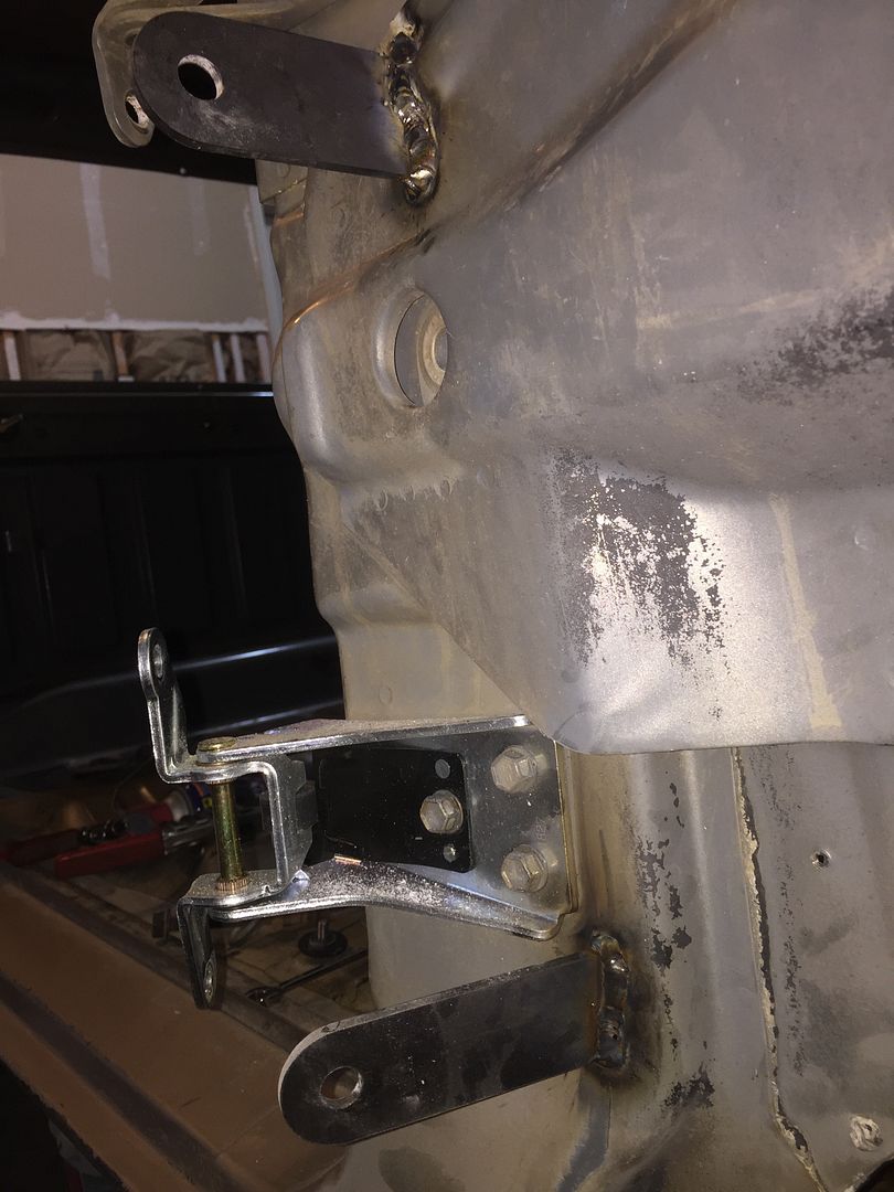

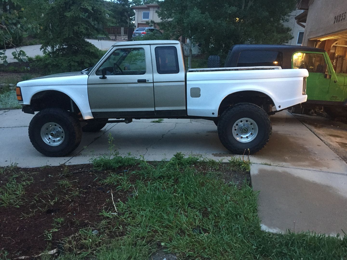

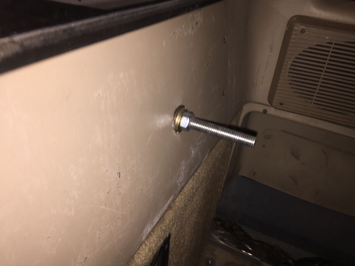

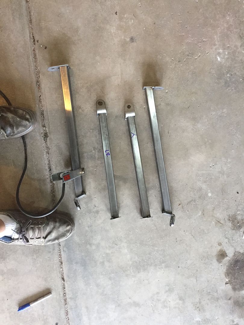

I made some different mounts for the sides of the bed sides. The ones I had just weren't tough enough. liked what some others recommended from auto fab:
Kirbys 1991 Ranger Build Up and Solid Axle Swap
With the new side mounted, they both look pretty close and they are with a tape too.

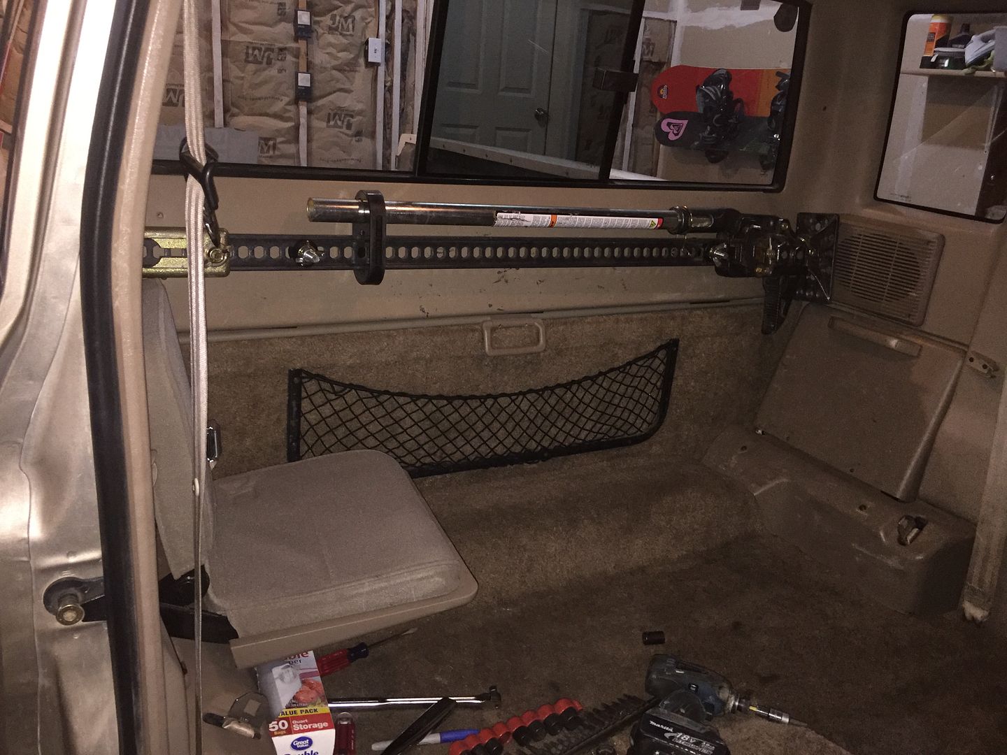

Here are some more shots of my highlift mount. I have been running it for the past couple weeks. No problems. I think it will be good for the long haul:
I am really happy with it. I have had the highlift floating around in the extended cab for too long. Its a pain to move around. Now it can stay right there until I need it. Also glad I got it done before paint.

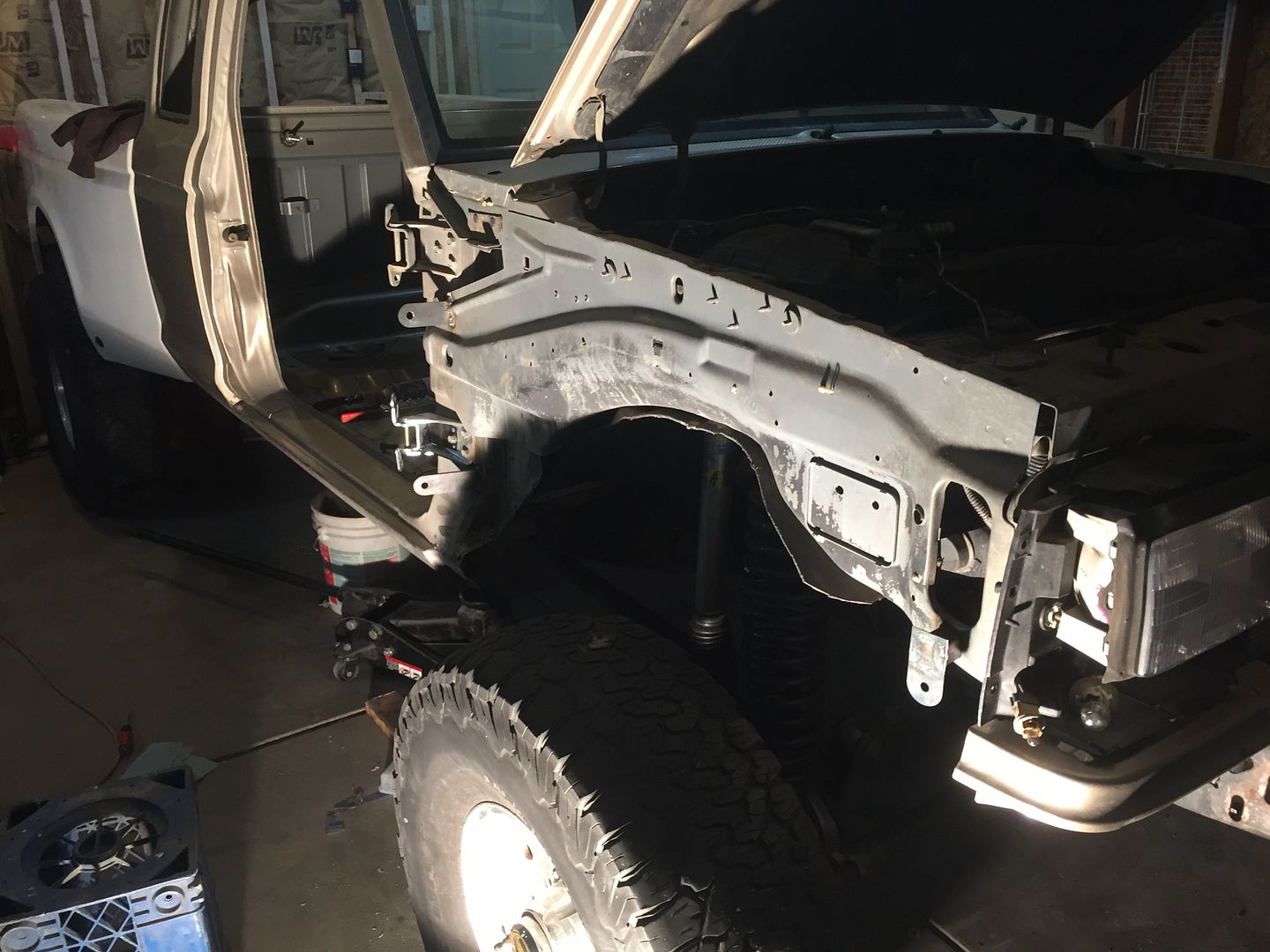

Well, I had a setback. My core support is rusted bad.
So I removed the body mount bushings and those body mounts suck. I went to the pull and pay today and it took me 3 tries, but I finally got off a set of front core support body mounts that were in good shape.
I spent the rest of the day fine tuning my passenger side front fender. I got a good reveal that I am happy with. Only took a long time.

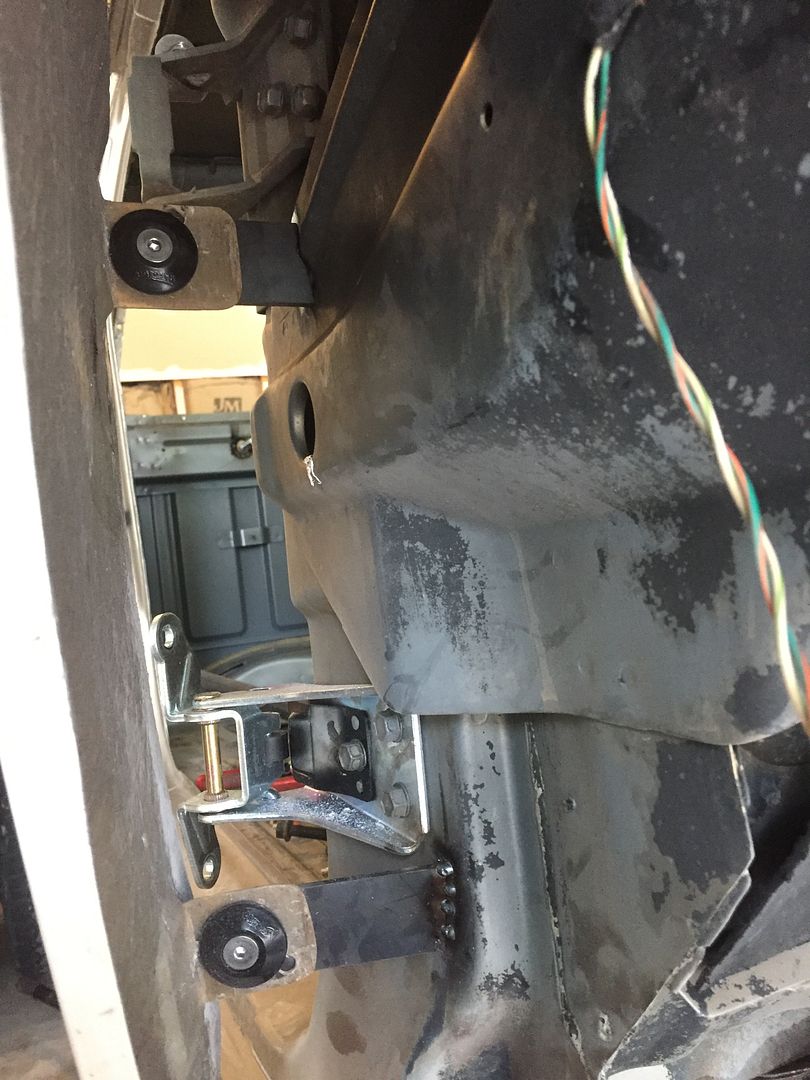

I initially utilized the stock fender mounts hacked off the original fenders. That wasn't really strong and was hard to get the gaps fine tuned.
Also, this fender had 3/4" too much material in the bottom area before the lowest mount making it stick out at the bottom. To resolve that, I cut the fender, overlapped it and screwed it together. I hope my body guy can smooth it out and make it look right.
Then, I had some extra tabs from Ballistic I bought- so I made some better fender mounts using the autofab grommets and the tabs that were supplied on the backside of the fenders. I like that they are hidden this way. I also put one behind the light on the front for a little more strength. Here they are tacked in
And welded up: (if you look close you can see the front mount too)
I was able to get the door reveal almost perfect this way- and I am satisfied. A little work with the flap disc and it was dialed.

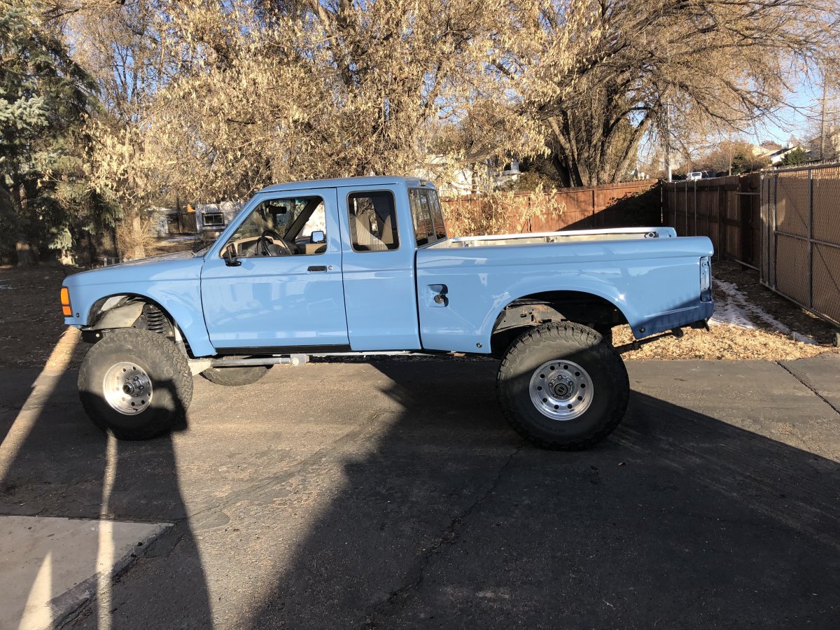

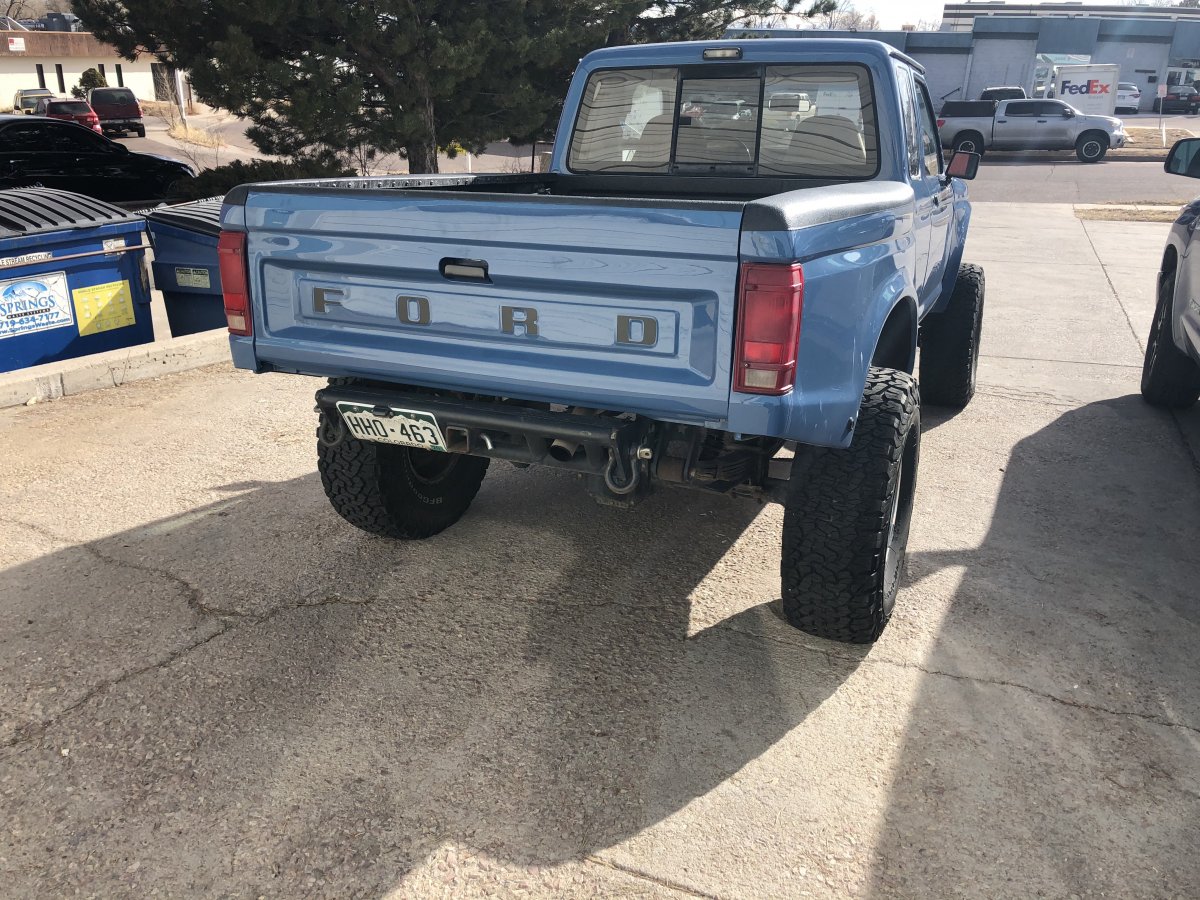

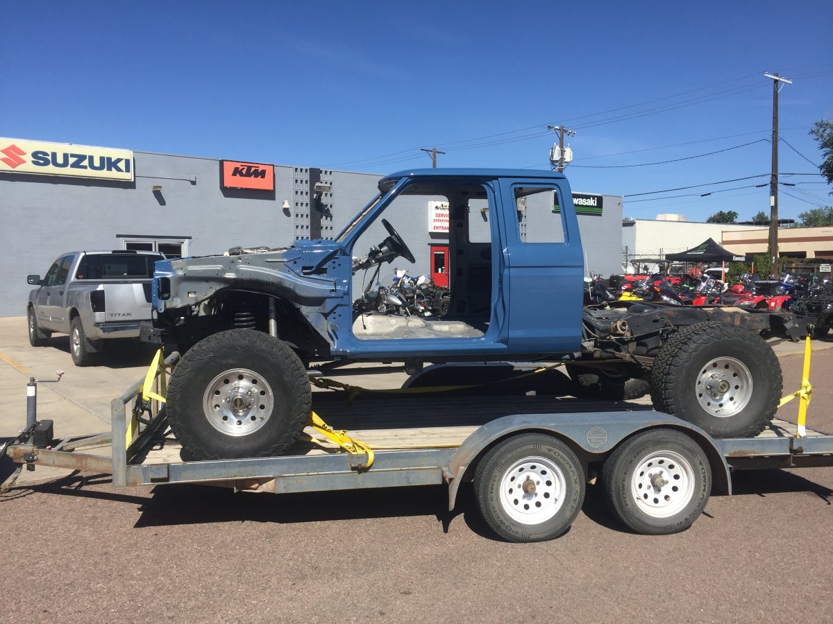

Photobucket broke the internet- but my truck is done with paint. It took from July-November for it to get done with paint and for me to get it back together. I am really happy with it. I decided on Calvary Blue non metallic.
Here it is the day I picked up the cab.

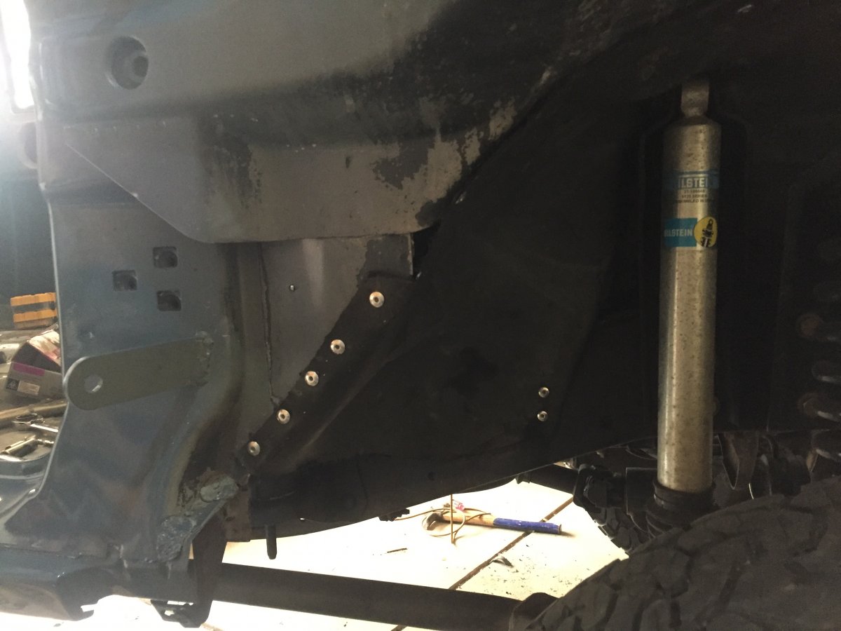

The inner fenders were a challenge. Started with a set of inners from a 1997. trimmed down and riveted.
Then built some templates and cut out some sections or ABS plastic to over the gaps.

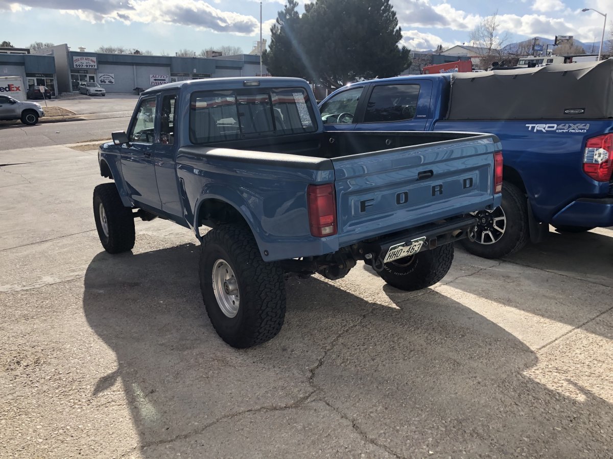

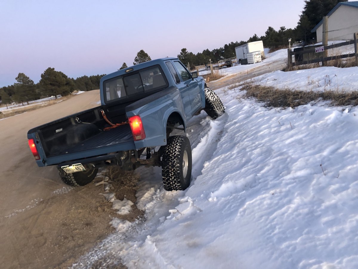

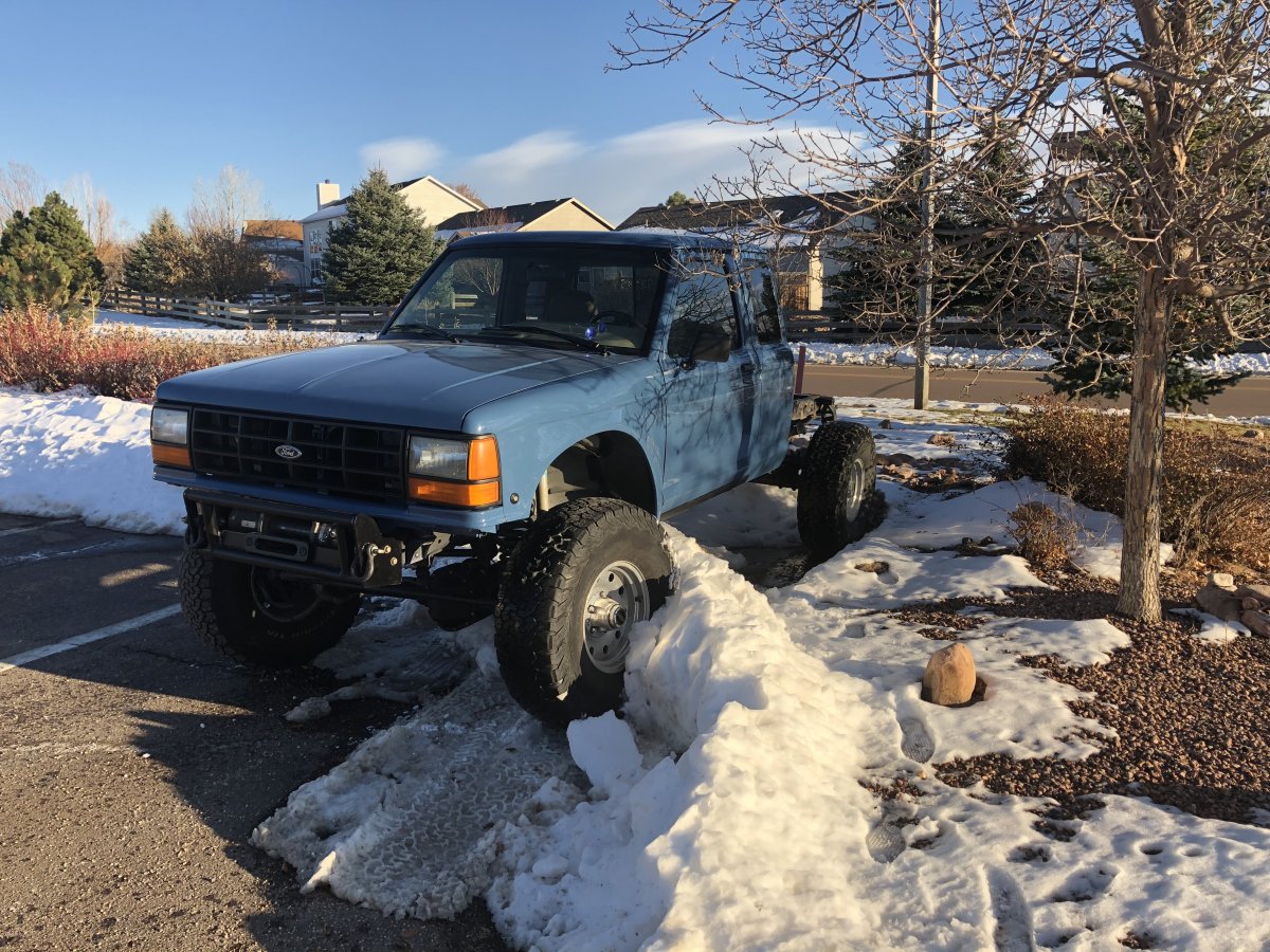

Yep... snow... lots of it.
Well… You built yourself a bad ass little truck Kirby. Glad you are out enjoying it.

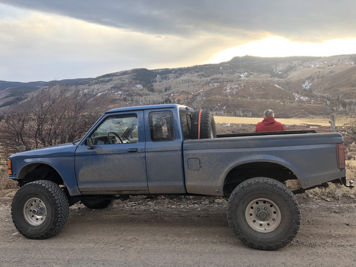

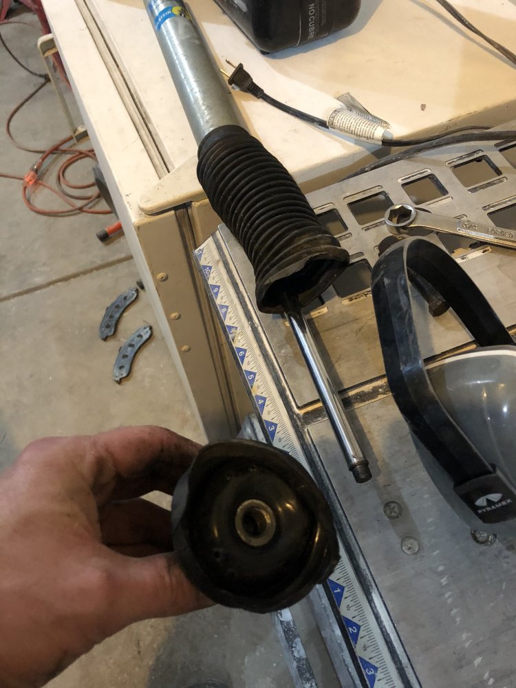

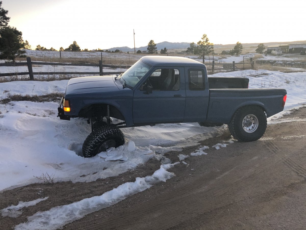

I have an issue with a shock. Bilstien end came unscrewed and booger up the threads. Looks like it is somewhat common. I talked to bilstien and they said I was over extending them. It seems weird it would happen now 4 or so years after I installed them.
35493

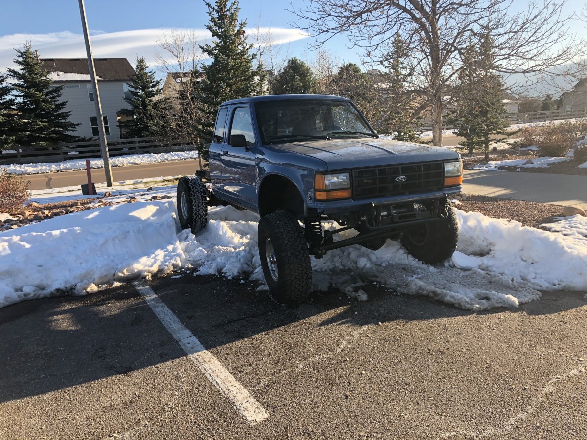

They said people have had luck welding them together. I might try that. I had to cycle them anyway and check. Fully stuffed at the shock it is 20" and fully drooped 29". They aren't correct. I took some pics because it was fun cycling the suspension.
35492
35494
I like how it tucks the rear tire all centered now.

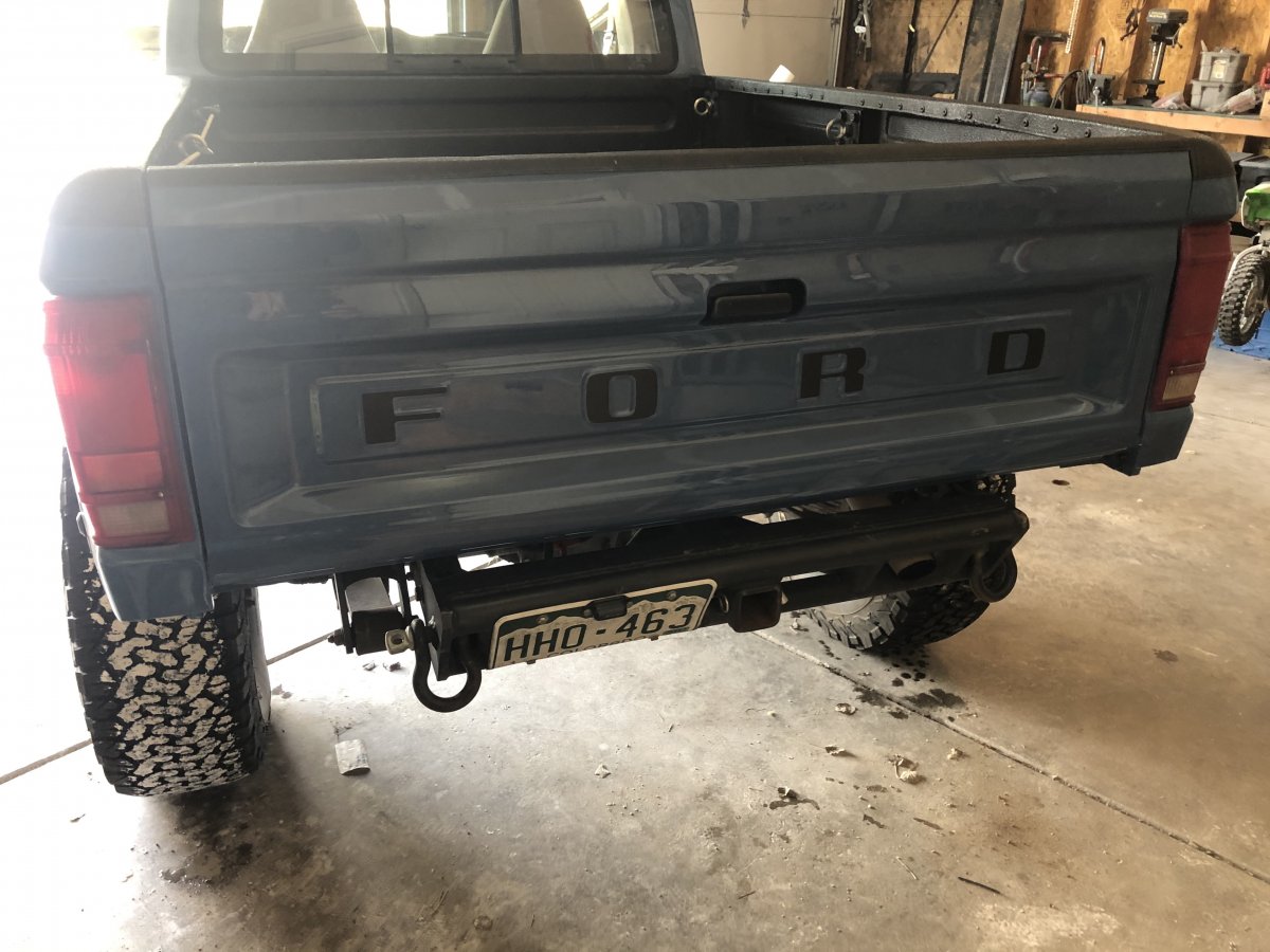

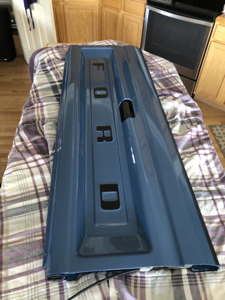

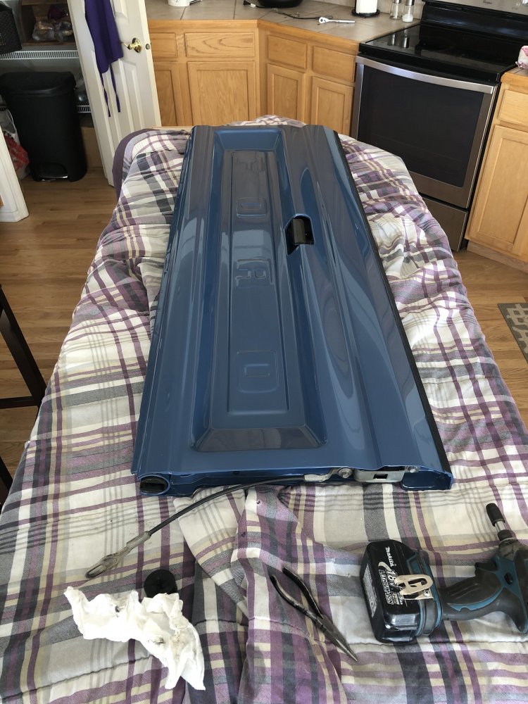

Today I got the tailgate mounted and stickered.
I found a set of NOS bushings for the hinges on eBay. So I got those installed. Parts are getting tough to locate.
I was able to also find a NOS handle on eBay. The inner parts are the best out of 3 sets I had.
It was a tight fit, but it fits and looks good:
