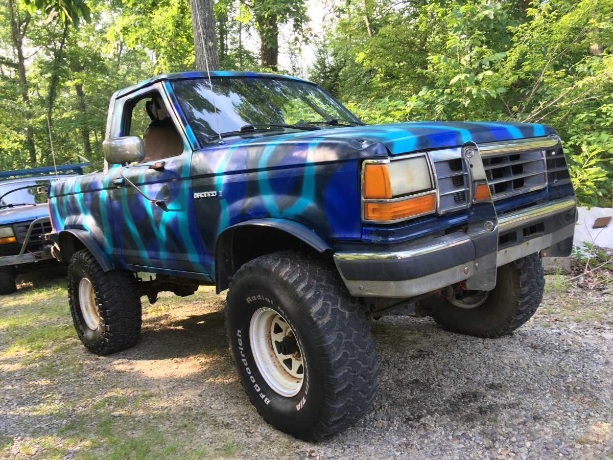

Ok, so let me explain a few things…
My 89 Choptop B2 I bought from the kid that chopped the top originally. Rusty may remember Sherrodwannabeb2, aka Farva from back in the early 2000s on here. Punk kid that claimed he had nitrous and all sorts of stuff done to it and claimed he could do 5 minute burnouts and stuff with it. The only things that weren’t stock on the truck was something like 28 aftermarket lights, most didn’t work and the wiring job was beyond disaster. I spent a lot of time ripping that mess out because he would catch whatever hot wires he came across and it caused a lot of issues. He did a real hack of a chop (I think if one could be careful and precise with the cuts, it would be possible to cut and re-use the top). I cleaned up the chop a little and I scrapped an 86 that I cut the top off of with the intent of building a hard top. I also scrapped a rotted out 89 Ranger bed that I cut the bed rails and tail light corners off of.
Between life and vehicle problems and such, I haven’t got to making the hard top. I’m not quite sure how I want to make the interface behind the front seats for sealing up a hard top yet and it’s going to require cutting part of the B-pillar and reinforcing. I want to graft in the Ranger bed parts then for the part of the top that will go on there, I’ll just weld something on the top and clamp it down like a truck cap to the bed rails with cap tape.
The body did start sagging and I ended up buying a roll cage from Jegs for a Ranger. It’s partially in, I was trying not to cut my dash but that lands the front bars in an awkward location to climb in and out. The cage was cheaper than I could buy the steel though. I ended up buying a tube bender and dies to be able to bend up the back pieces that I need and bought the steel, but once again, I haven’t got it done yet. The cage around the front seats did help stiffen the cab though.
I have a buddy that does boat canvas, at some point after I get the cage done, he’s going to make a soft top for me. Hopefully that will all happen this year.
I did pin the front doors (although I want to try building something different that will make it easier to install/remove doors), so I can take the doors off. Also on the list is making tube doors and half doors.
It was road legal in PA up until they changed the law so that now anything with a modified body has to have special title, registration, and inspections. Ohio doesn’t care and I’m not sure how much PA will care once I get things cleaned up enough to appear factory-ish.
Anything beyond a 2-3” lift and you’ll want wide tires. I have 5” of suspension and a 2” body lift on it and run 35x12.5-15 tires. When I had a 3” suspension and 2” body and was running 33x12.5-15 tires I decided I was gonna try wearing out a set of 31x10.5-15 tires I had. I made it to the end of the street before going back for the 33s. Just waaay more stable.
The thing is stupid capable in 2wd with a locker or a limited slip with extra clutches. I’ve amazed myself where it will go like that. Even a stock B2 is more capable than most people realize. It’s the same wheelbase as the CJ/YJ/TJ Jeeps, just a little longer body and TTB instead of straight axle.

Lol, he was something else. When I went out to get it he said it was in his dad’s name but if I gave him some money he could get some beer cheap for me while I went with his dad to do the title transfer. Never saw him again after I handed him a few bucks, gave the rest of the agreed on money to his dad. So I really didn’t get to know him in person, but the little bit I did, yeah, you’re not wrong.
Mine just kept growing. I started with a 2” lift and 4x4 conversion, then I scored a deal on a James Duff 3” lift, then the body mounts were bad and the bolts seized so I bought new poly mounts and a 2” body lift so I had new hardware (the body lift ended up being cheaper than just buying the bolts I needed), then when I put the D-35 in the front it got the F-150 spring perches and Belltech shackles for roughly 5” of suspension lift. Started on 31’s, the 3” suspension and 2” body cleared 33’s (4” suspension would probably clear 33’s on a second gen like the Choptop is, a first gen would probably require a fender trim and/or more lift, the 5” suspension and 2” body lift clears 35’s with no trim). Extended arms are needed for more than 2” of suspension lift and that’s even a close thing.
The 2.9 and FM-146 with 4.10s did ok for 33’s, but it really wanted a little more go or deeper gears. I gave up on the D-28 after blowing apart the shafts three times. Of course, then I went to a D-35 and promptly blew a shaft, but I think I found the problem that caused the D-35 to blow so I’ll resolve that, it’s a lift bracket issue. The 2.9 was no good on 35’s, first though third it pulled like a champ and 4th it would fall flat on its face. 4.0 resolved that but it really would be happier with a touch more go or deeper gears. I mostly built it on a shoestring budget over many years. Gets a lot of attention and is a very fun toy.

Thank you, I can’t tell you how many times I’ve had people tell me they love the Choptop. Makes it fun to drive around in addition to just being fun to drive.
First gen you really just need to be willing to trim the front fenders a little, second gen had a little bigger wheel opening. I do agree on liking first gen better even though I only have one first gen and two second. I did accumulate parts at one point to do a first gen conversion on the front of the Choptop. Just never got it done.
