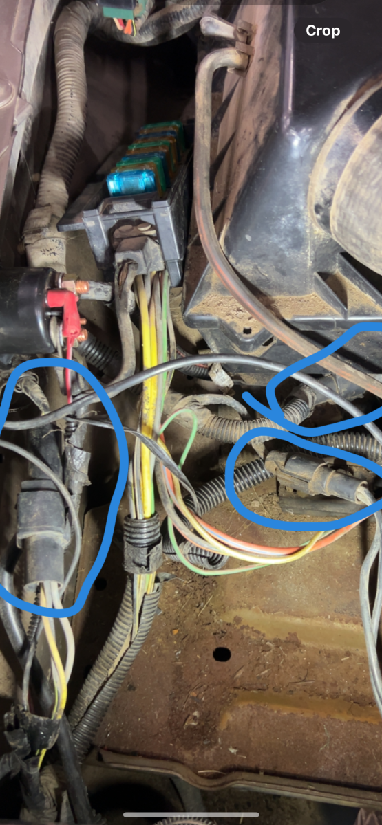

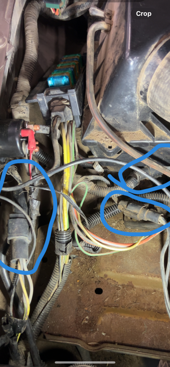

I’m not finding the fuseable links I don’t think. At least nothing that looks like any of the pictures I’ve found of them. There’s connectors I’ll try post a picture of about 5 of them and I don’t see why they are there (could have just kept the wire going it doesn’t make it go into a different harness) could they be the fuseable links?

Those things circled are just connectors.
A fusiable link will look like a piece of wire with a very hard rubber 3D looking rectangle piece that will say "fusiable link" then list amperage.

You can see the distribution box in the upper left of that picture. The cover is off of it leaving the fuses exposed.
Not to mention the power wire to the distribution block looks like it’s toasted…
Isn't that a fusible link on the power wire just as it goes into the distribution block?
No… but that wire is blown apart anyway, can’t believe nobody had anything to say about it.
It and the wires under it all look kinda scorched....
