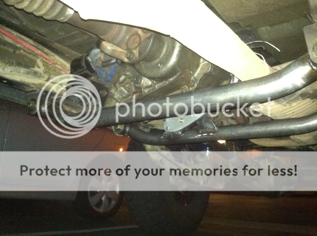

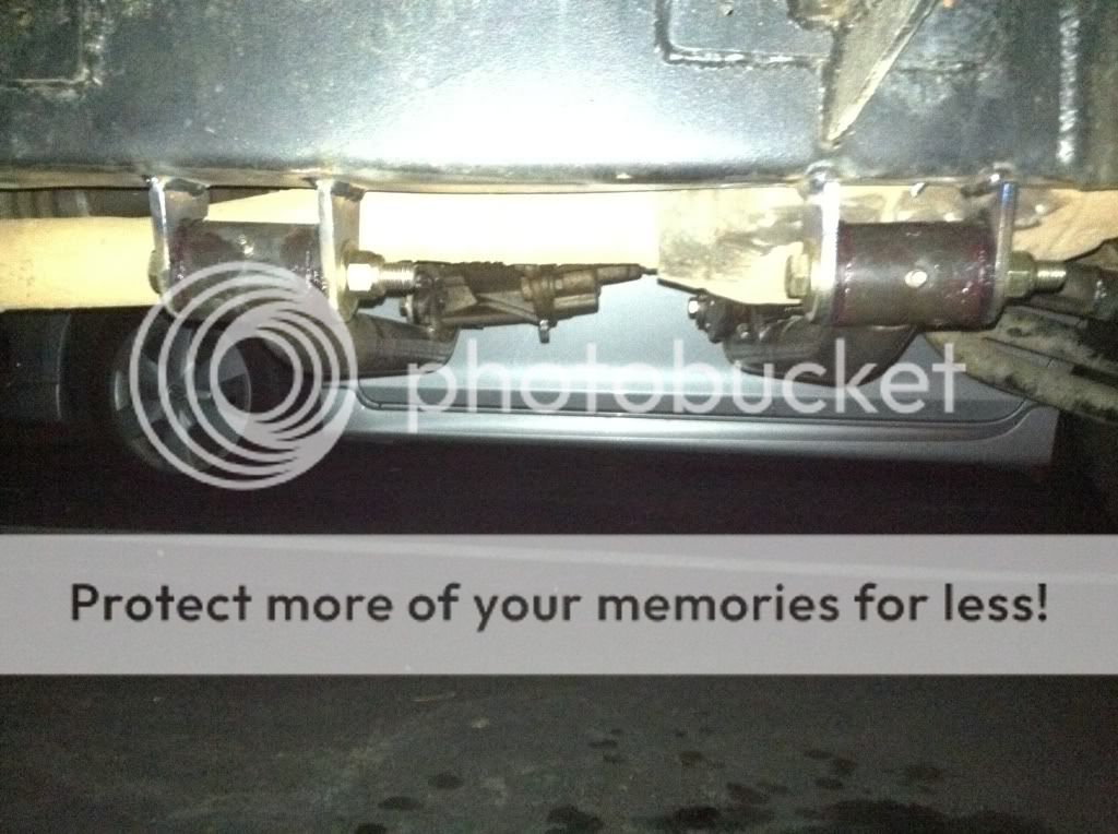

Well, i had a busy ass weekend...... DOUBLER IS IN!
Now that is out of the way, time for the fun....
This thing was a bitch. It didn't want to go in. At all. Fought me and my buddy every chance it got.
Here is the end product as of today...

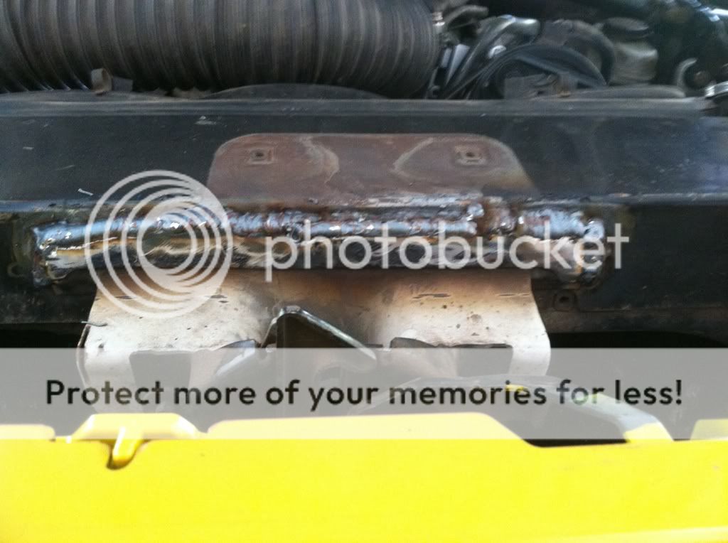

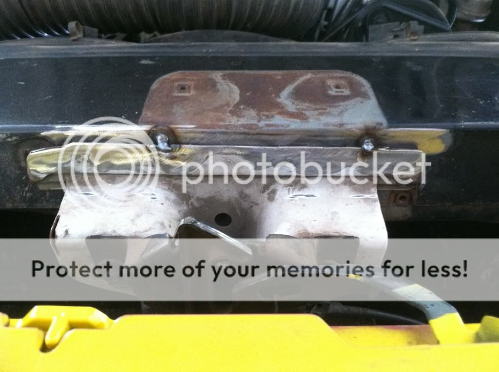

also messed around under the hood.
The hood latch from the 05 edge was just bolted on the core support and was always flopping around, so i decided to permenantly attach it to its new home.
First i just tacked in on there so it would stop moving.
Josh40601's Build Thread. (D-ranged)
Then i burned everything in. was pretty thin, so i burnt through twice, but filled it back in. Still look like boogers, but at least they're penetrating...

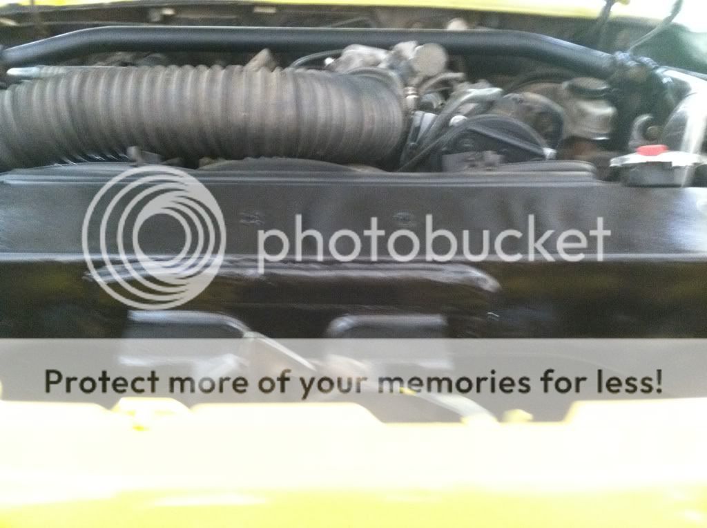

Ground it down, slapped some satin black on it. Called it good
looks good buddy, your welds are getting better and better, still just need a bit more practice. Are both cases manual? set up linkages yet??
Thanks brother!

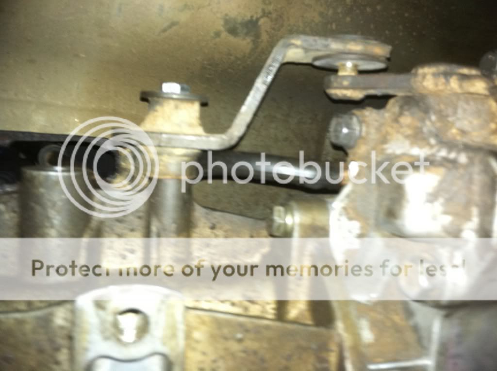

As far as linkage and cases go....
The rear case is the 1354E, so i just stretched the wires as far as i could and plugged them in.
Front is the manual. I used the stock 1350 shifter for a manual trans. It "kinda" fit.
I removed the access panel and hacked up my carpet to see everything. I had to sleeve the shifter, and i used the rear factory hole in the stock adapter plate.
Here is a shot looking straight up at it.
It shifts great there... In 2Hi and 4Hi :annoyed:
So i plan on "extending" the shifter towards the front of the truck instead of cutting into the actual floor of the truck. Cutting the access panel is no big deal, but i don't want to cut into the cab. Going to work on that this week.
