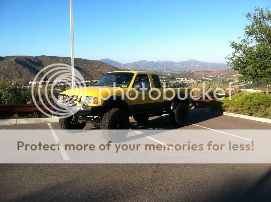

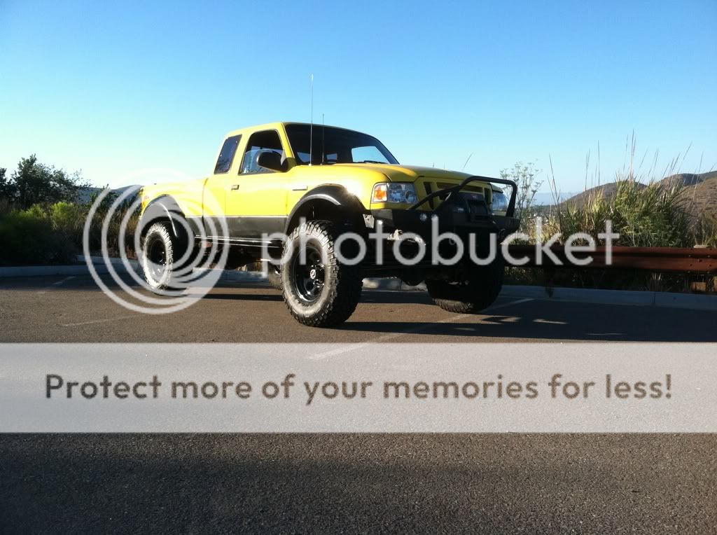

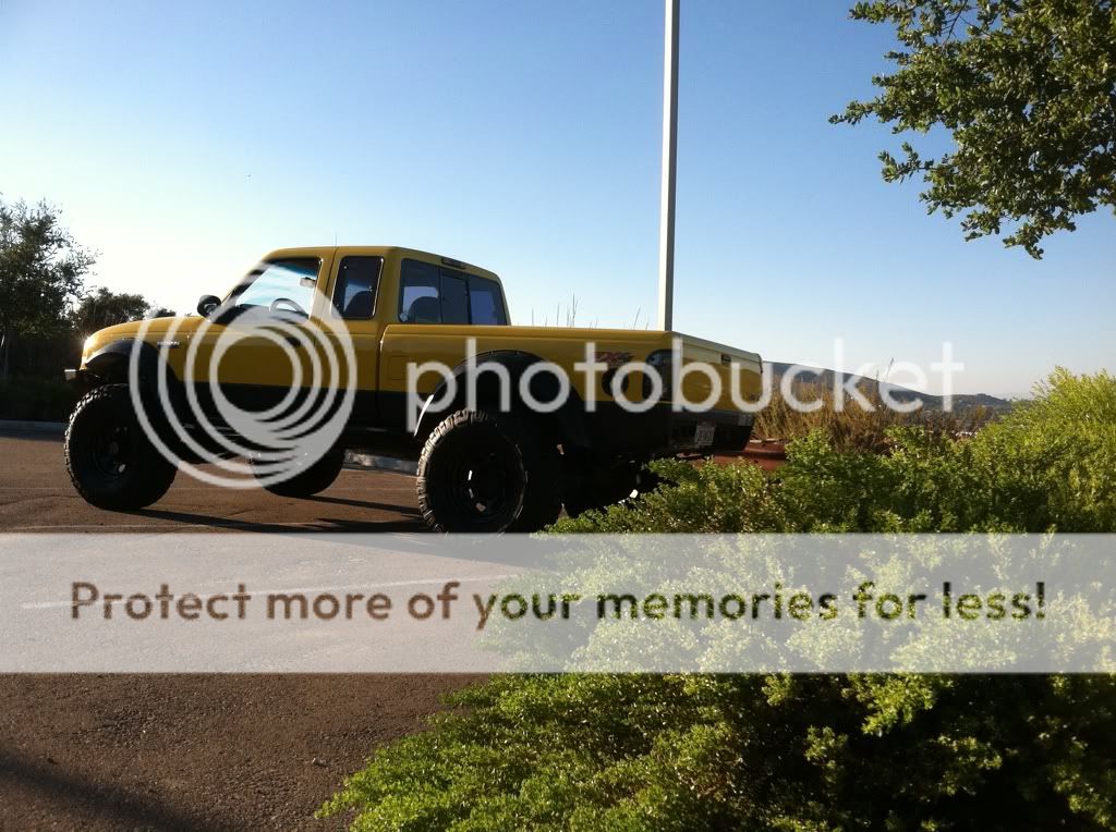

Here are some pics of the finished product....

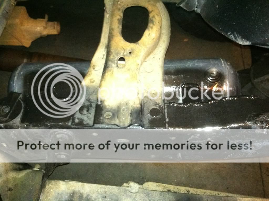

Worked on the truck last night for ENTIRELY too long. Took some 3/16" hot rolled and cut it down to match the frame. This is entirely too thick for what i needed, 1/16" would have sufficed. Whatever. Anyway, with the fuel lines and wiring running along that side, i wanted to be sure i didn't burn into them, so i kept a spray bottle close and soaked everything with water. The welder did not like this. As you can see below, my welds look like shit (what else is new) but they penetrated good enough.

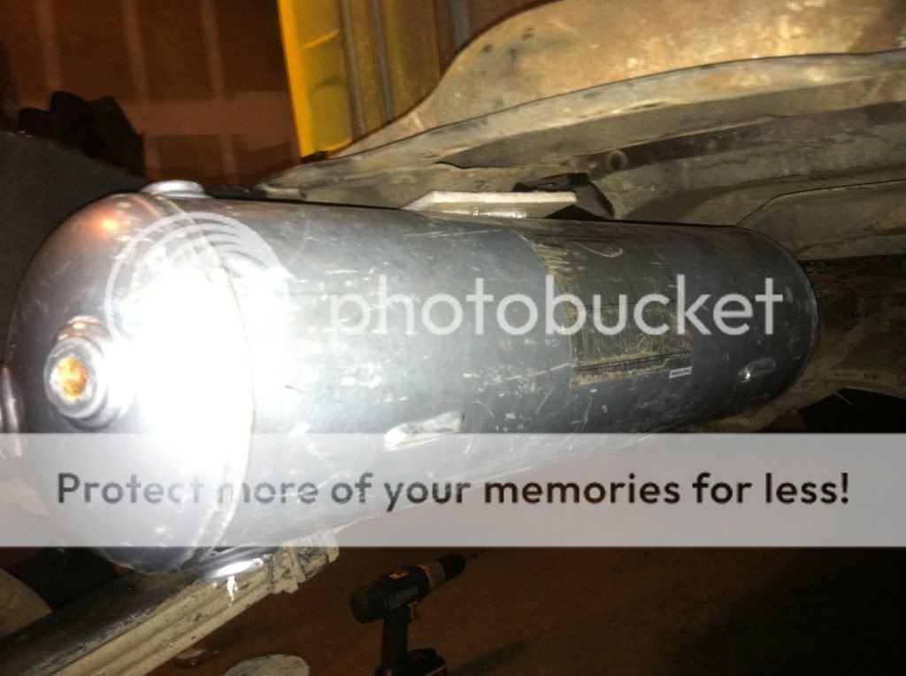

Anyway, i mounted the air tank on the frame. I type too fawking much:shaking:

My gangster welds
side shot

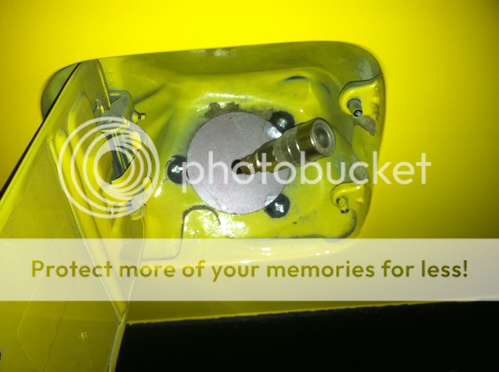

Then i took some sheet metal and mounted the air chuck or whatever its called.
Im loving the air chuck mounting location!
thanks dude. I figured since the tank is in the back now, and i don't want to do any body to this bed as it is toast once i get back, this was a perfect place for it.
