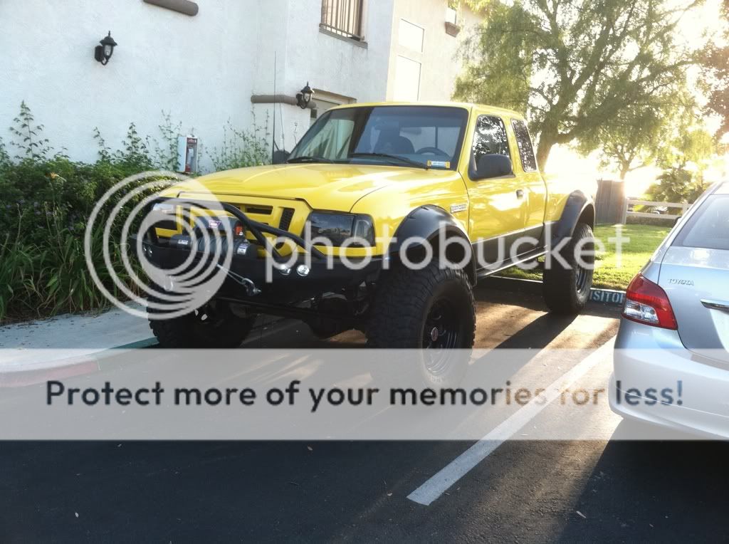

I did do some work on D once i got the truck running again. 1st was install my "smoked" lights. Little dark, but i don't care.

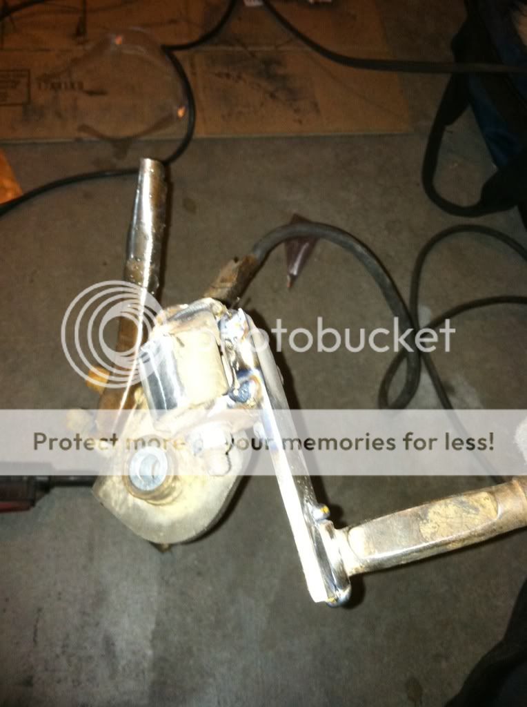

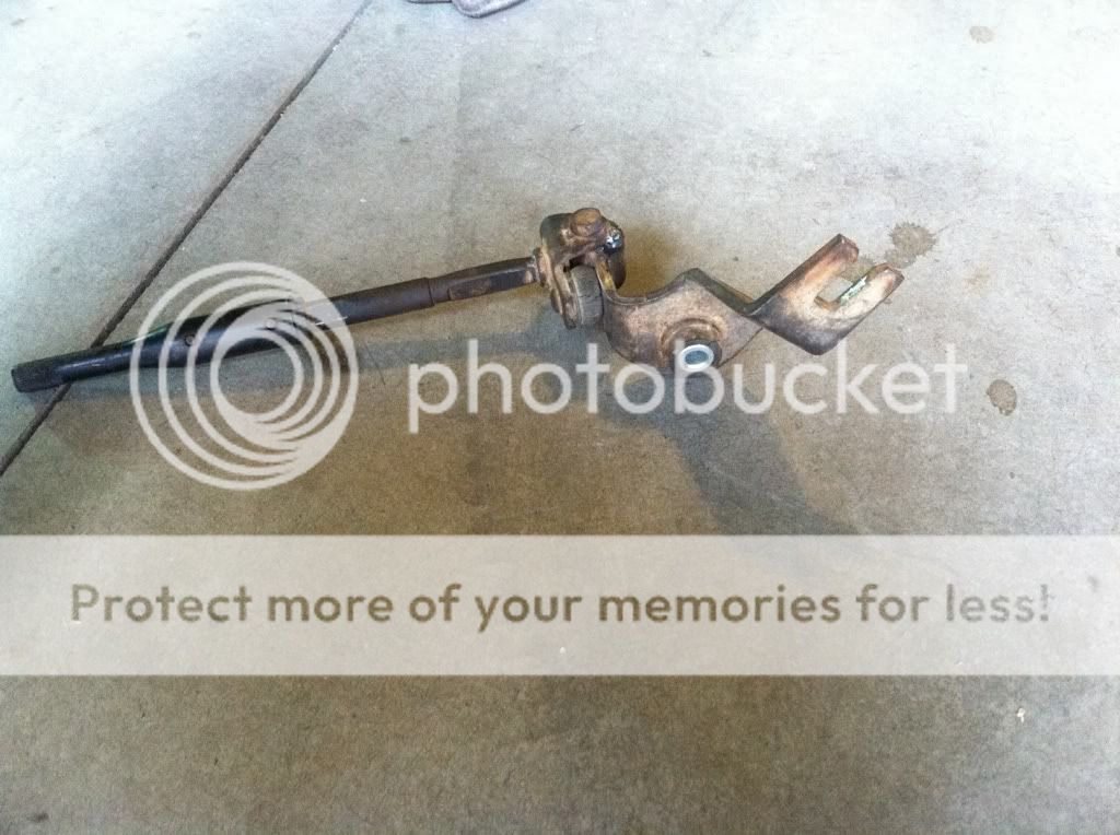

1st, here is the stock 1350 shifter that i received when i bought it. It is sleeved so i could use a smaller bolt in the hole i wanted to use on the Transmission Adapter

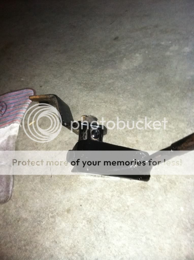

Then i cut off the shifter handle and cut out a small piece of 3/16" and test fit everything

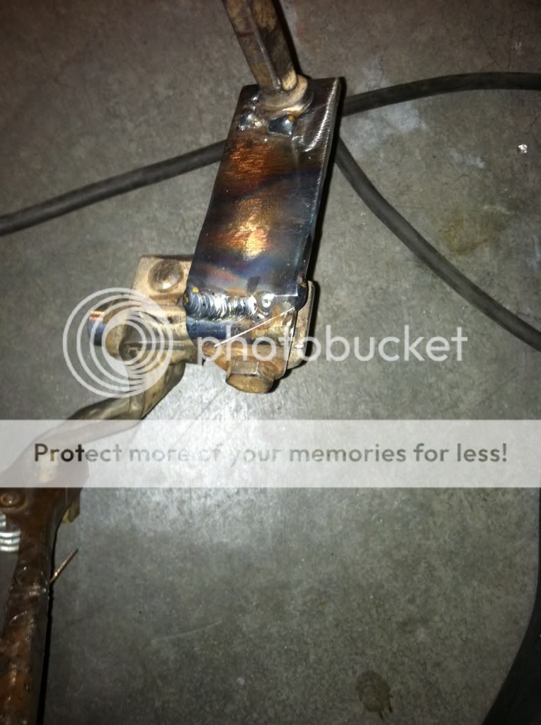

Once i had it fitting, I burned everything in. Welds are getting much better.

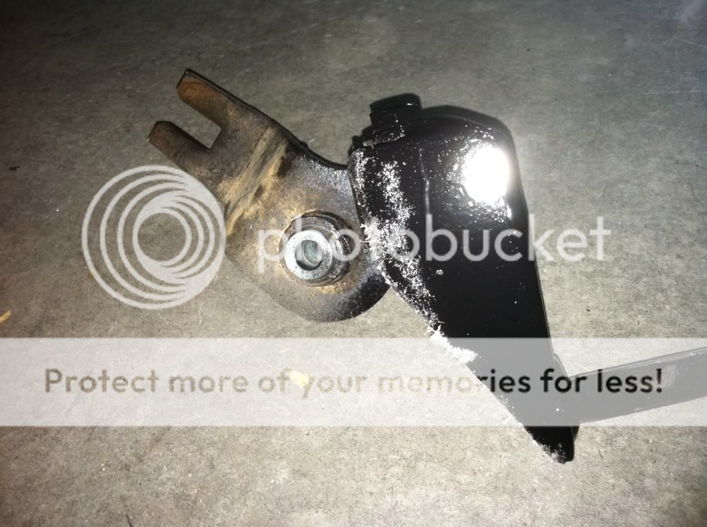

Then i cut a piece of 1/8" plate and made a gusset for the shifter. cleaned it up a bit, and shot a quick coat of paint to keep from rusting
Then just installed it.
